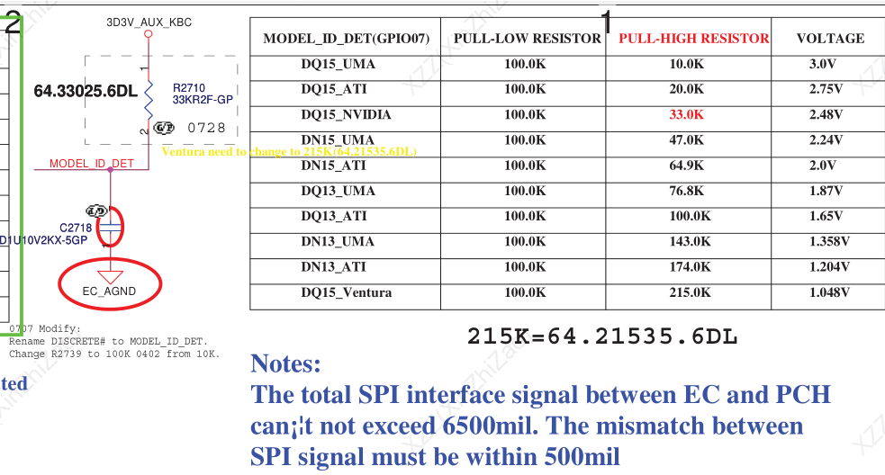

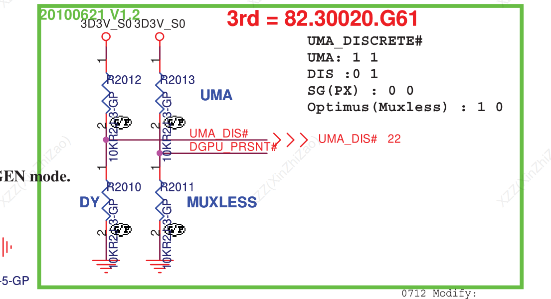

      See attached.

        mon2 I did not understand anything

          https://www.badcaps.net/forum/troubl...33#post1258433

            The graphic conversion is already posted by me as highlighted by piernov. use forum search before posting.
