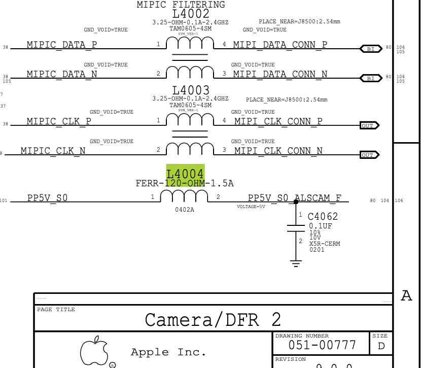

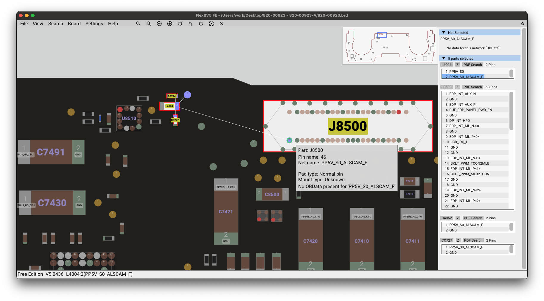

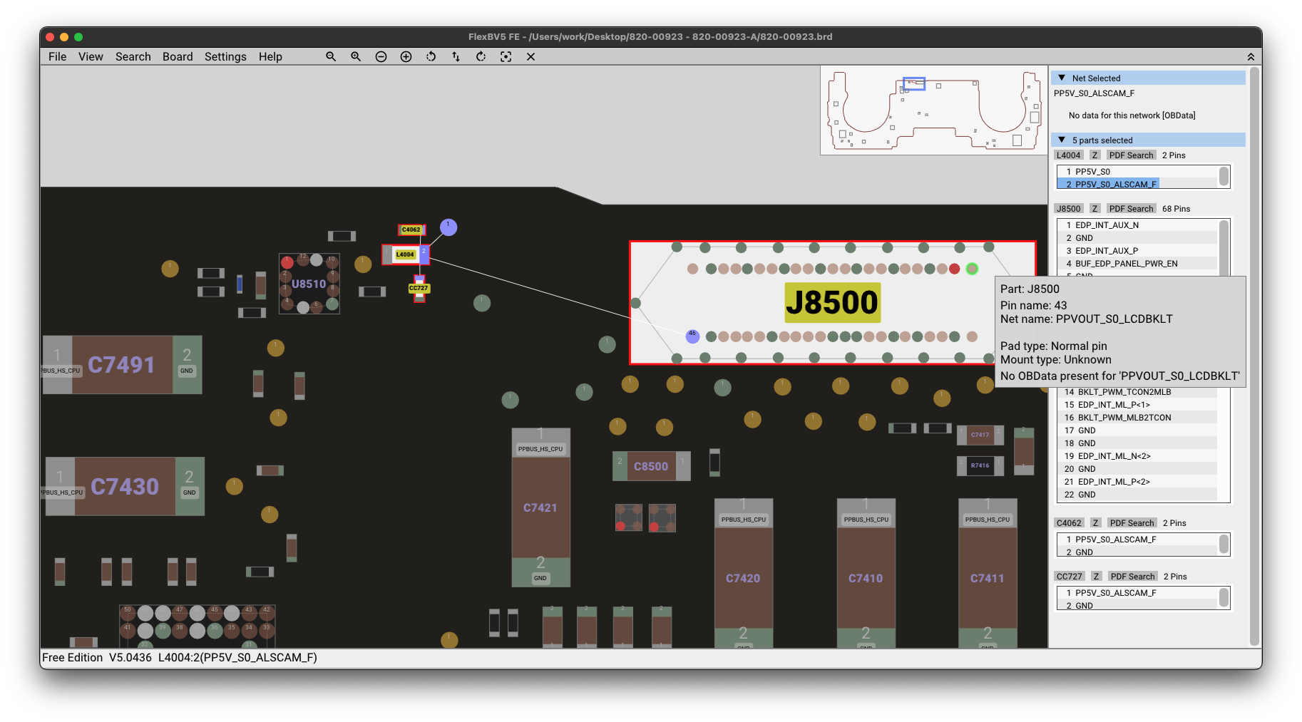

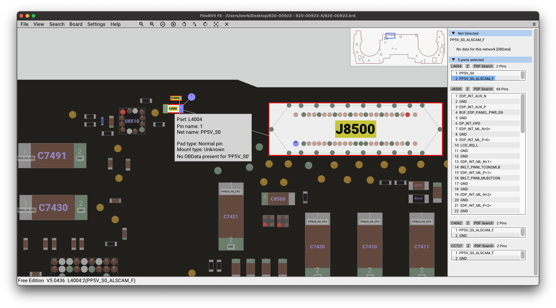

    Originally posted by piernov
    If there was liquid damage in the LCD connector, CPU is most likely damaged anyway as a result of backlight rail arcing with eDP AUX line.
    Hello Piernov, thank you for the input.
    The only damage that I saw on the board with a magnifier, was on the pin PP5V_S0_ALSCAM_F on the display side, and on the board, and resistor L4004 burned.
    And I've checked, I have PP5V_S0 = 5,1v.
    Should I remove the heat sink from the CPU to see if everything is intact?

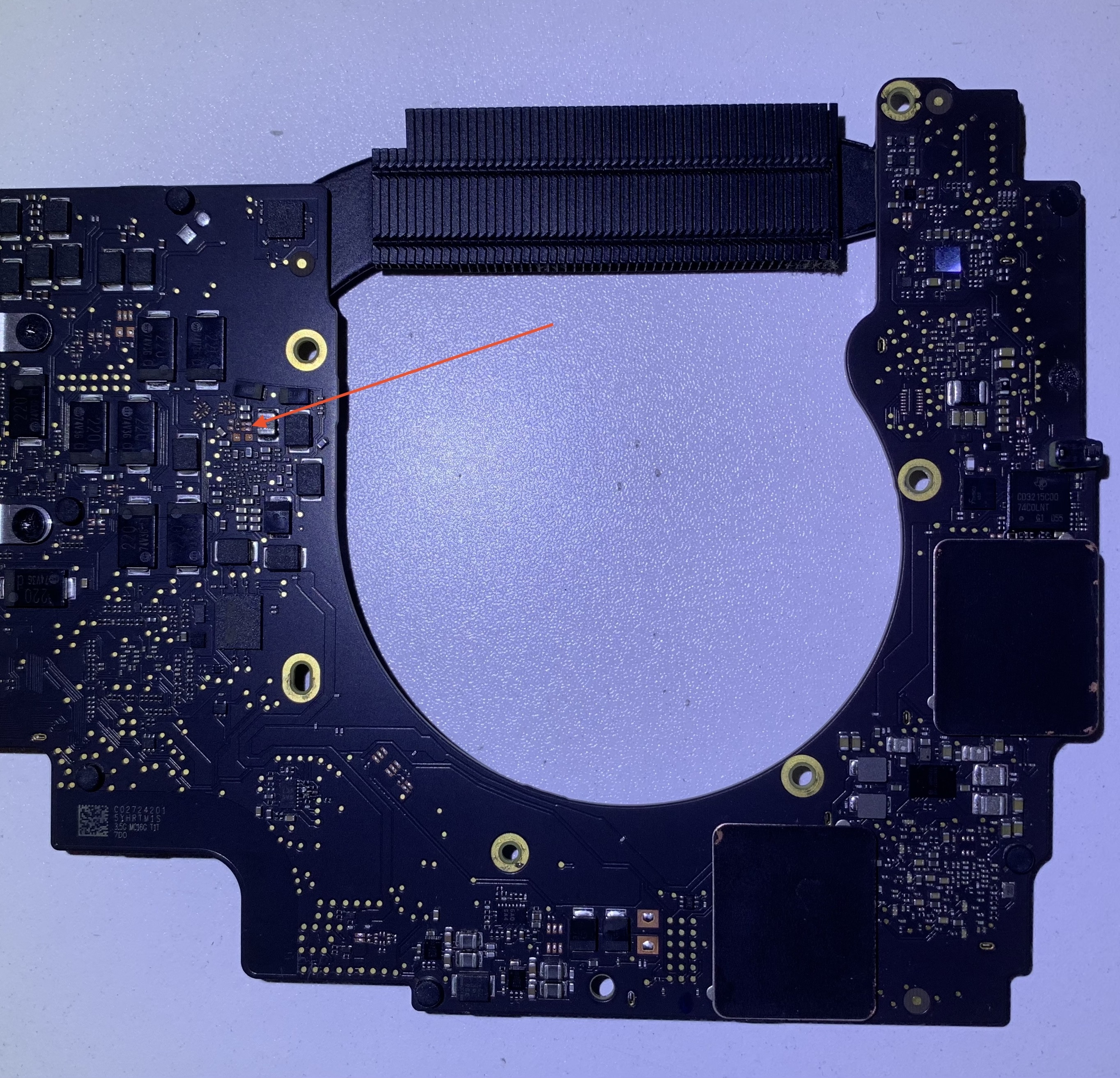

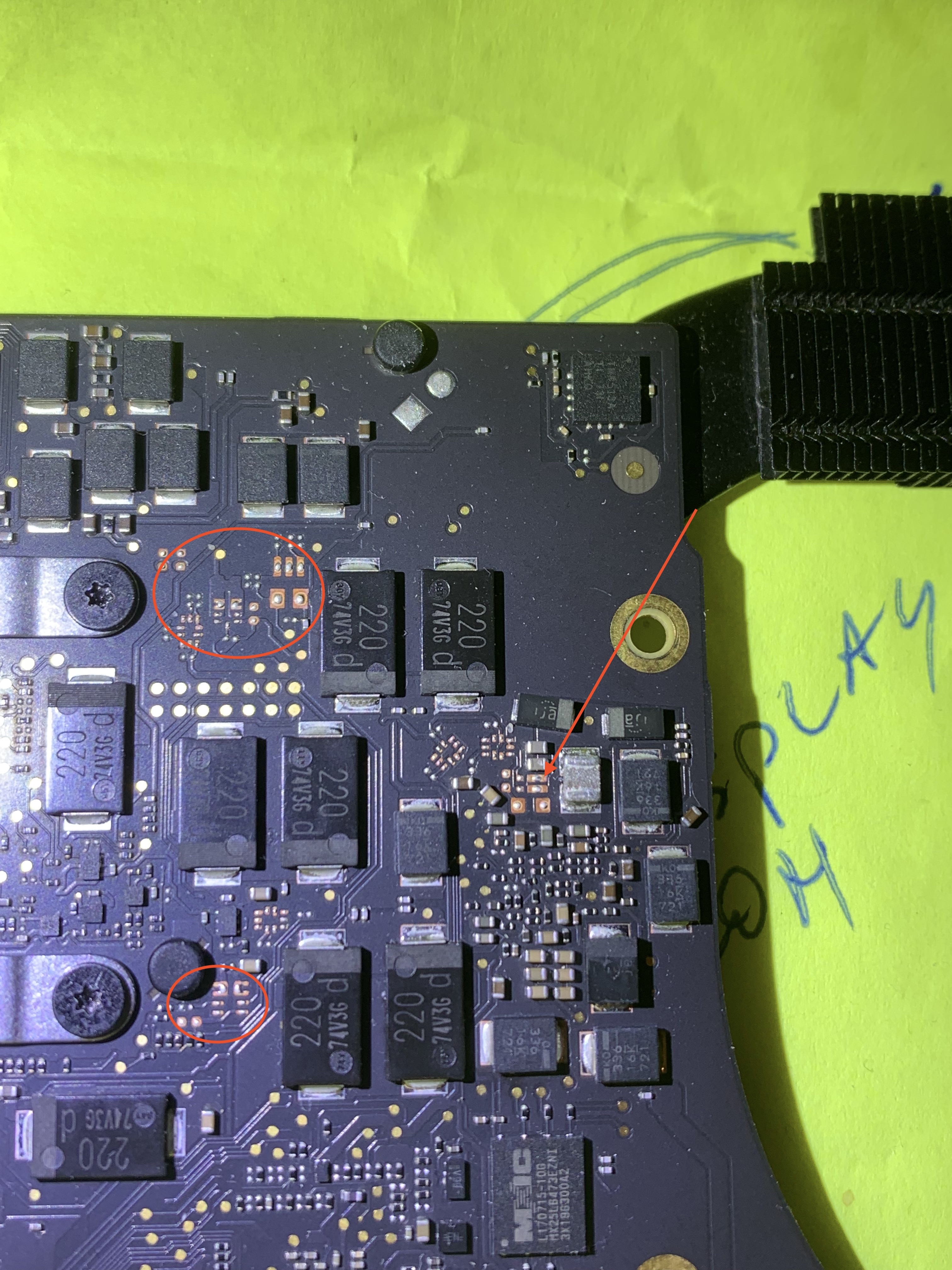

      I tried to debug why PP1V8_S0 = 0 Volts
      See attached PDF with the analysis.
      I think it has connections with PP1V8_SUS which comes 0v from U7800
      And also it has missing components (attached a photo with the board), not sure if it helps as PP1V8_SUS_REG_R is 0volts that comes from U7800
      From my understanding if I don't have PP1V8_S0, then ALL_SYS_PWRGD​ is low (0volts), then the whole system can't continue booting, right?

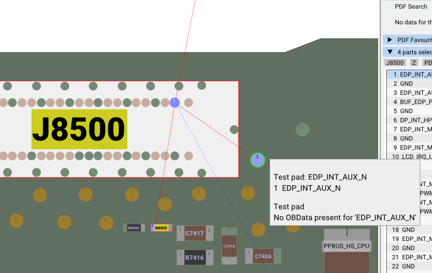

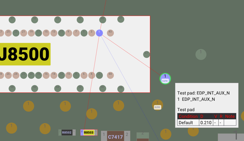

        Usually this data line is shorted after liquid damage to J8500. Should still boot, but you won't get an image. Very common fault.​
          At the moment I'm trying to boot it up without display and any other major peripherals.
          And from my understanding, I'm stuck at missing: ALL_SYS_PWRGD and missing:
          PP1V8_S0
          PP1V8_SUS​
            Did two measurements, multimeter in resistance mode at 20k unit, black probe at GND, and red probe:
            EDP_INT_AUX_N
            4,68
            EDP_INT_AUX_P
            4,62
            EDP_INT_AUX_N
            4,64
            EDP_INT_AUX_P
            4,59

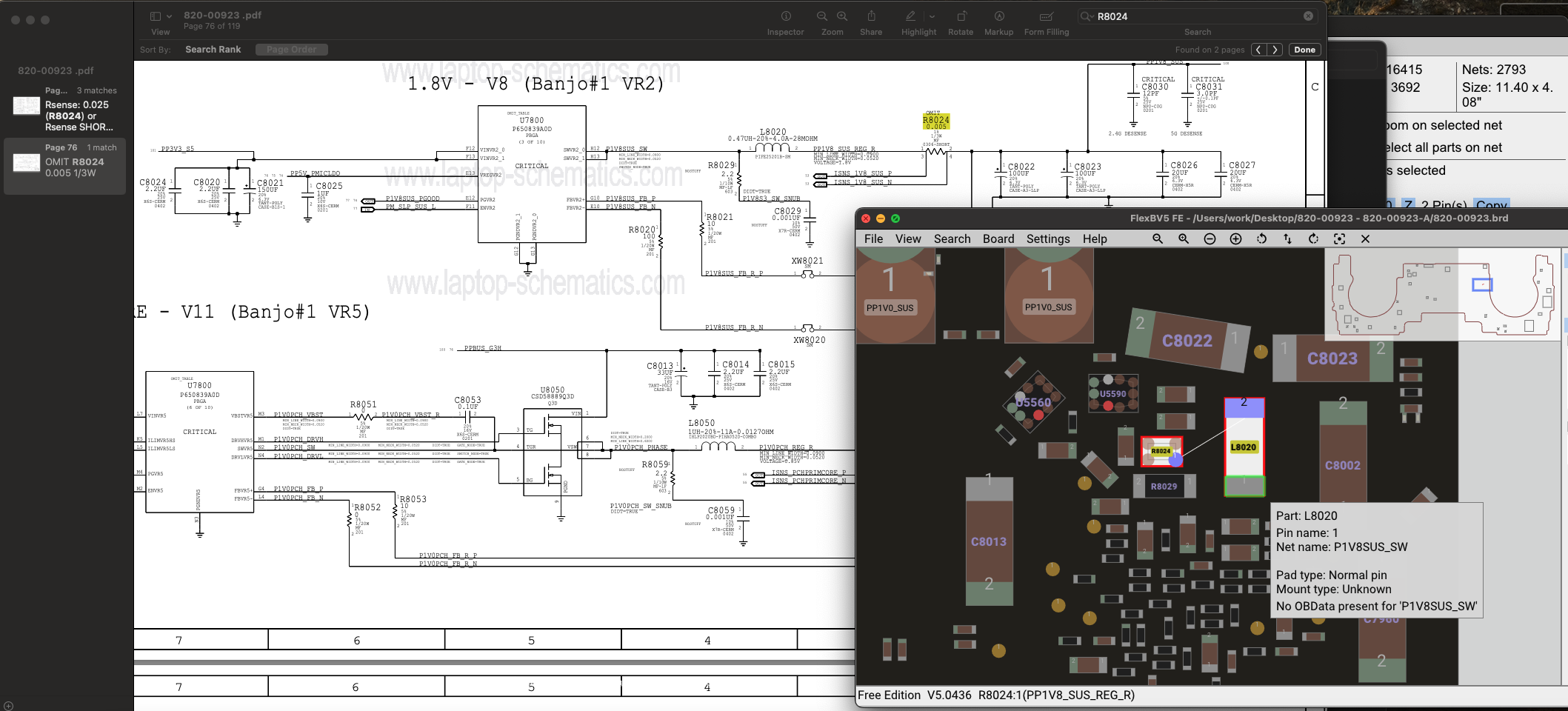

              PP1V8_S0 is derived via a load switch from PP1V8_SUS, which in turn is generated by PMIC U7800. Enable is PM_SLP_SUS_L (measure at R1458), output is via L8020. Check for low ohms etc on the 1.8V lines, especially around touchbar connectors.​

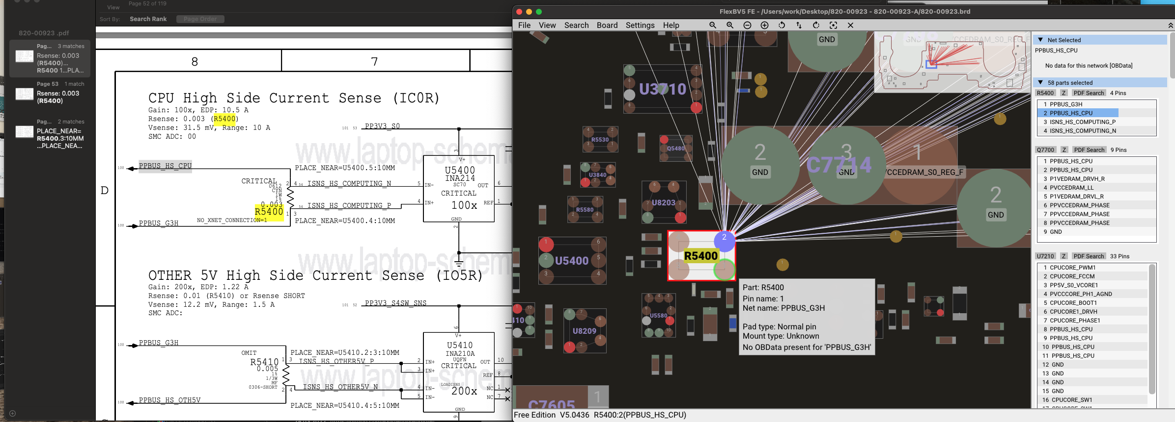

                What I found so far:
                Part 1:
                PM_SLP_SUS_L = 3,35v
                R8024 is not on the board, along with R8029, C8029.
                >> but it seems that there weren't anyway, I think nobody remove them, doesn't seems to be trace of flux or heat there (see attached photos).
                So my understanding is, without that R8024 it can't convert the P1V8SUS_SW (AC) to P1V8SUS (DC) needed for PP1V8_S0.
                PP1V8_S0 measured in resistance mode, and is not in short.
                I don't have an oscilloscope, measured P1V8SUS_SW with multimeter in AC set to 2v unit, and got: 0,016 (not sure if this is relevant).
                Part 2:
                Missing component from the board R5400, I can see from the board that it was removed from there (by the old service that I've employed a long time ago).
                Attached photo for more context. From my understanding this is the main entry point to power-up the CPU stuff. I have PPBUS_G3H =13V there.
                PPBUS_HS_CPU is not in short (measured with multimeter resistance mode at 20k and I have 6kOhm and going up).
                >> I guess they removed that R5400 to do measurements, I think..
                What do you think? (I'll continue debugging)
                • rilley
                  • Jul 2024
                  • 30
                  • Romania
                  Could it be that this PP1V8_SUS is generated somewhere else and I need to dig elsewhere and not on the U7800 ?
                  ( seems like the R8024 is not on the board, along with R8029, C8029 will definitely will not help to go further with PP1V8_S0, but from what I saw on the board, there are places that are missing components, but I think they are not there by Apple and nobody removed them [like old repair shop], see the red circle from the past photos that I made with the board, seems like there are small circles with flux ).
                  Also, without PP1V8_S0, and PPBUS_HS_CPU, then I won't have ALL_SYS_PWRGD anyway, right?

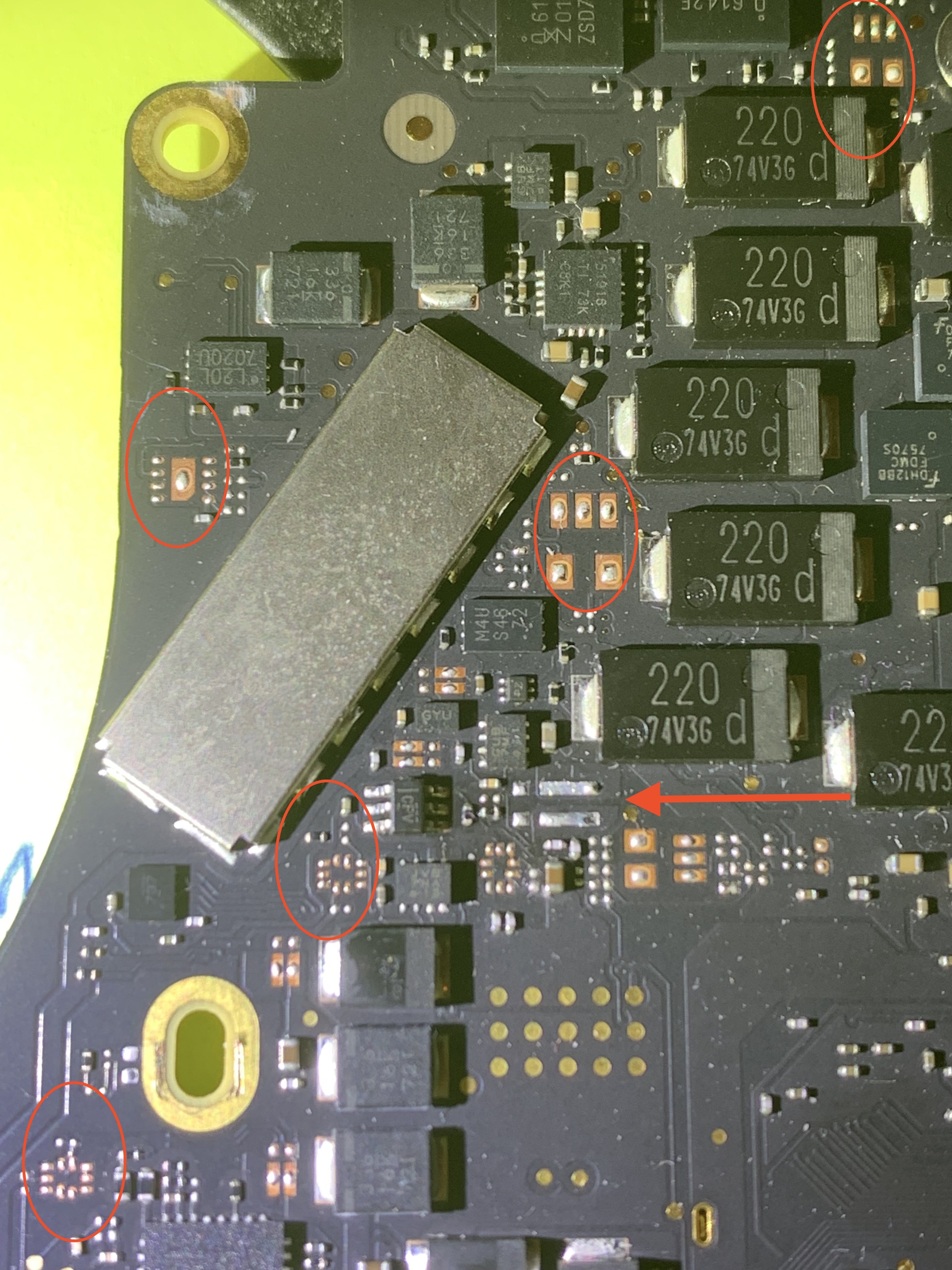

                  • mon2
                    • Dec 2019
                    • 14677
                    #29
                    No. The red circled areas are machine deposited solder paste areas using a smd stencil with aperture openings. That is, the paste was applied at manufacturing time but the parts were marked as do not populate.

                      #30
                      R8024 and R5400 are for current sense; it should just read as a short and aren't physical components. R8029, C8029 are NO STUFF in the schematic, so not fitted during production.
                      PP1V8_SUS is generated from U7800 (3 of 10), no where else. Check that resistance to ground at L8020 isn't short or low. Then check all your signals going in: PP3V3_S5, PP5V_PMICLDO, PM_SLP_SUS_L. Its a buck converter, so you also check the feedback components R8025, R8020, R8021, C8020. The PMIC shouldn't be underfilled, but if it got liquid damage under it, it may need to be removed and reballed.
