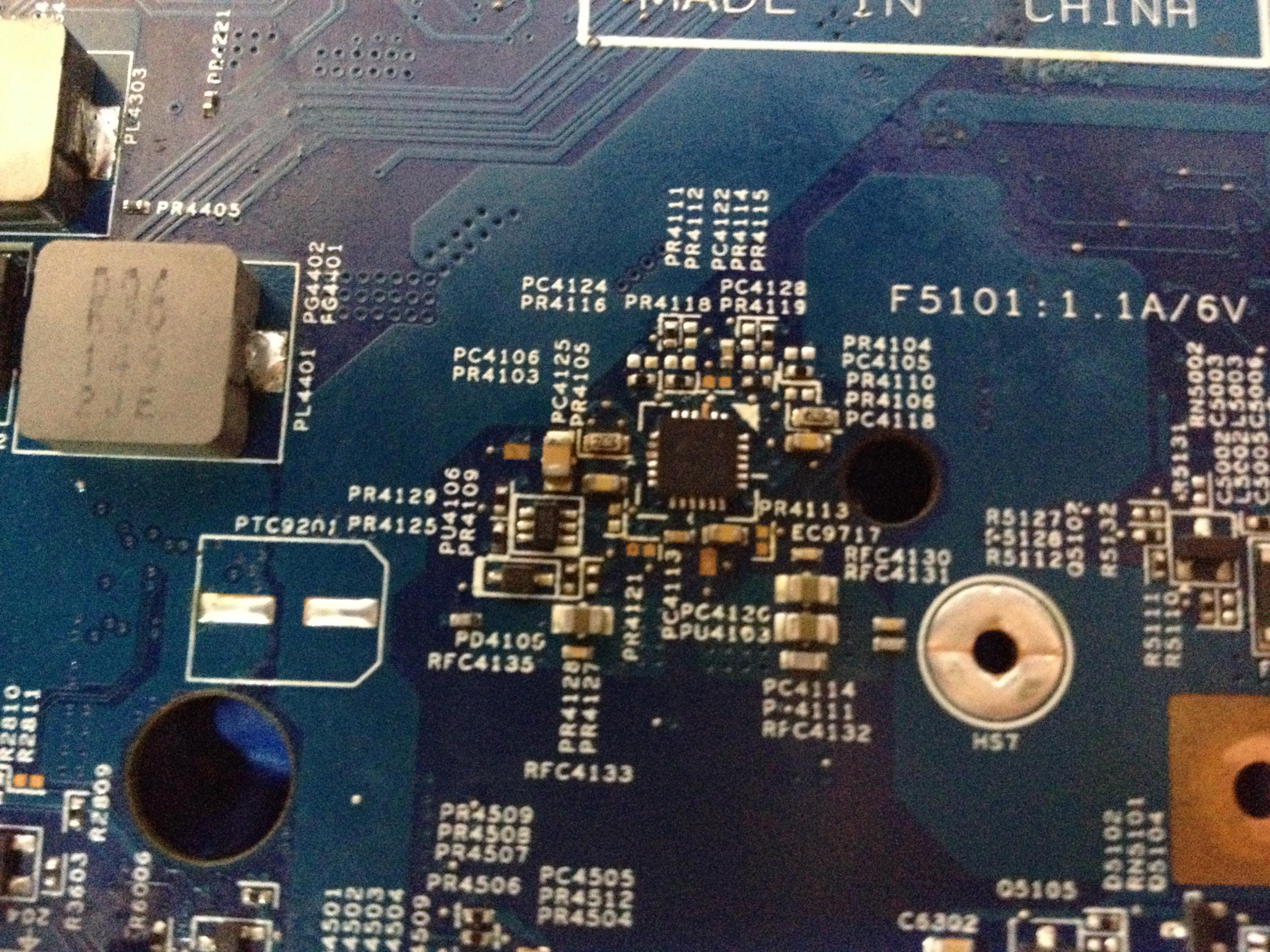

    hi guys
    just want to know what you thinkk about this and if a replacement is needed
    thanks in advance
    its an acer 4752 no power liquid spilled
    3.3v/5v power ic
    rt8223mgqw-gp-u1
    pin
    1=1.17v
    2=0.02
    3=1.98
    4=1.98
    5=1.26
    6=1.26
    7=0.28
    8=3.37
    9=4..6
    10=0.28
    11=0.28
    12=0.0
    13=2.71
    14=3.38
    15=0.0
    16=19.31
    17=5.01
    18=3.35
    19=0.0
    20=0.06
    21=0.06
    22=4.59
    23=3.32
    24=0.06

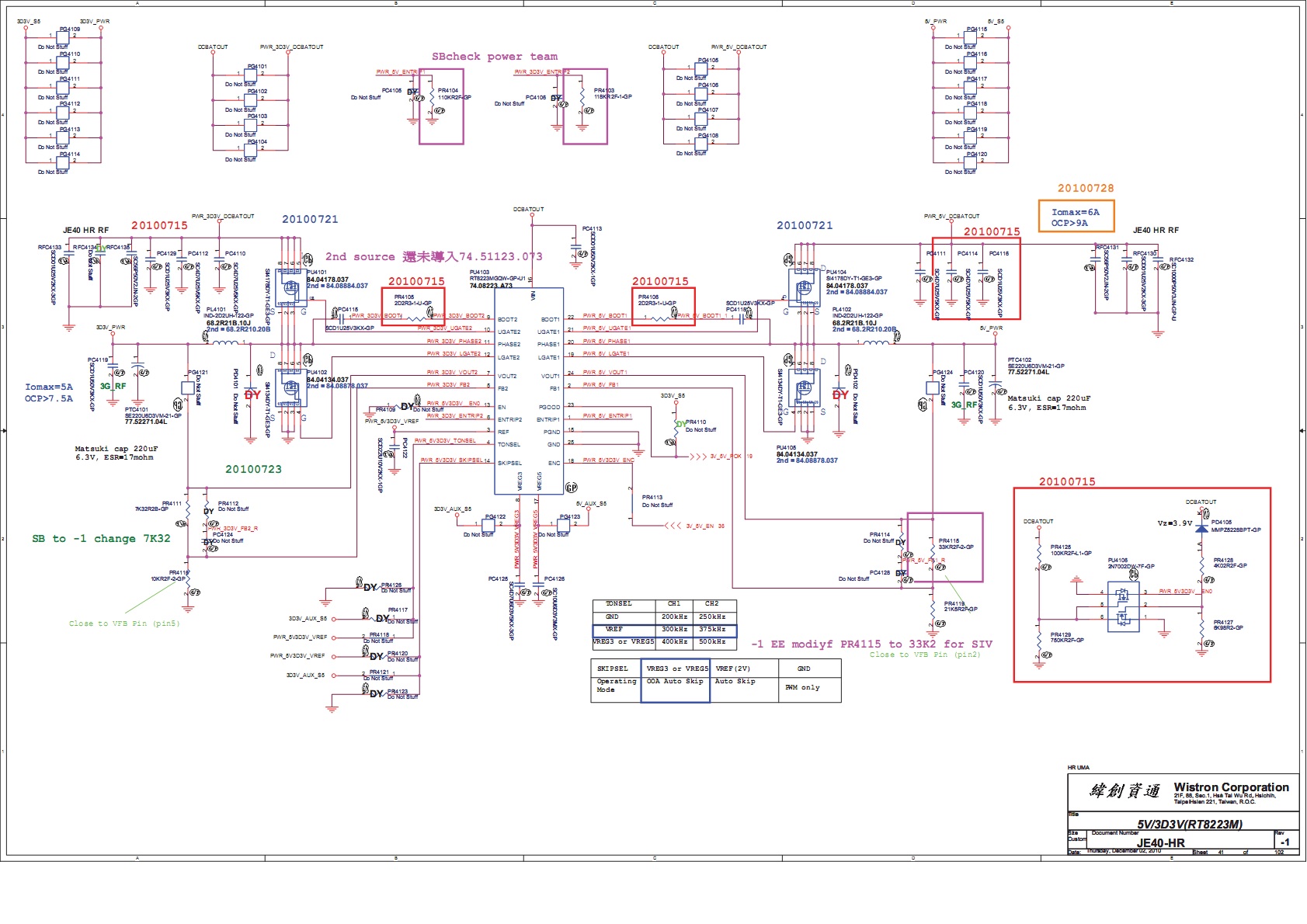

    attached is the picture of the ic
    and schematics
    thanks

      Re: acer aspire 4752 JE40 HR MB 10267-4 no power
      looks like the chip has 3.3v_aux on pin 8 and 5v_aux on pin 17
      and you have on pin 18: 3.35v for enable
      but no 3.3v_pwr and 5v_pwr output
      so you need to replace the chip if you don't have any external shorts
          3.3v_pwr should be on pin 7 and 11
          5v_pwr should be on pin 20 and 24
          also both images sides are identic except that enc pin 18
          here is the schematic without password .

              both 3 and 4 pins are connected to vref which is generated internal in rt8223b
              and is 2v (check the datasheet) also he can't have voltage on bios because 3d3v_pwr on pin 7 must be ok.
              crazypepe try new chip rt8223b

                You need to replace this chip.
