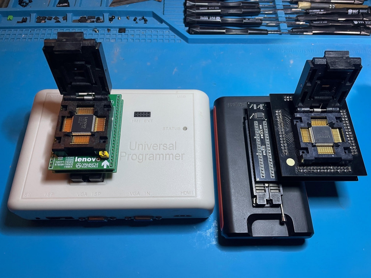

      Hello all, Really sorry for crashing this thread, I am also trying to program this same chip in a zif socket IT8227E-256, 1928-BXA.
      Any help would be very apricated. I am not even sure I have the chips the right way around, I have tried a few ways on both programmers.
      I get the chip busy message on one of them, nothing but errors. Not sure what chip to pick on RT809H in the setup, Please if anyone can help.
      Thanks.

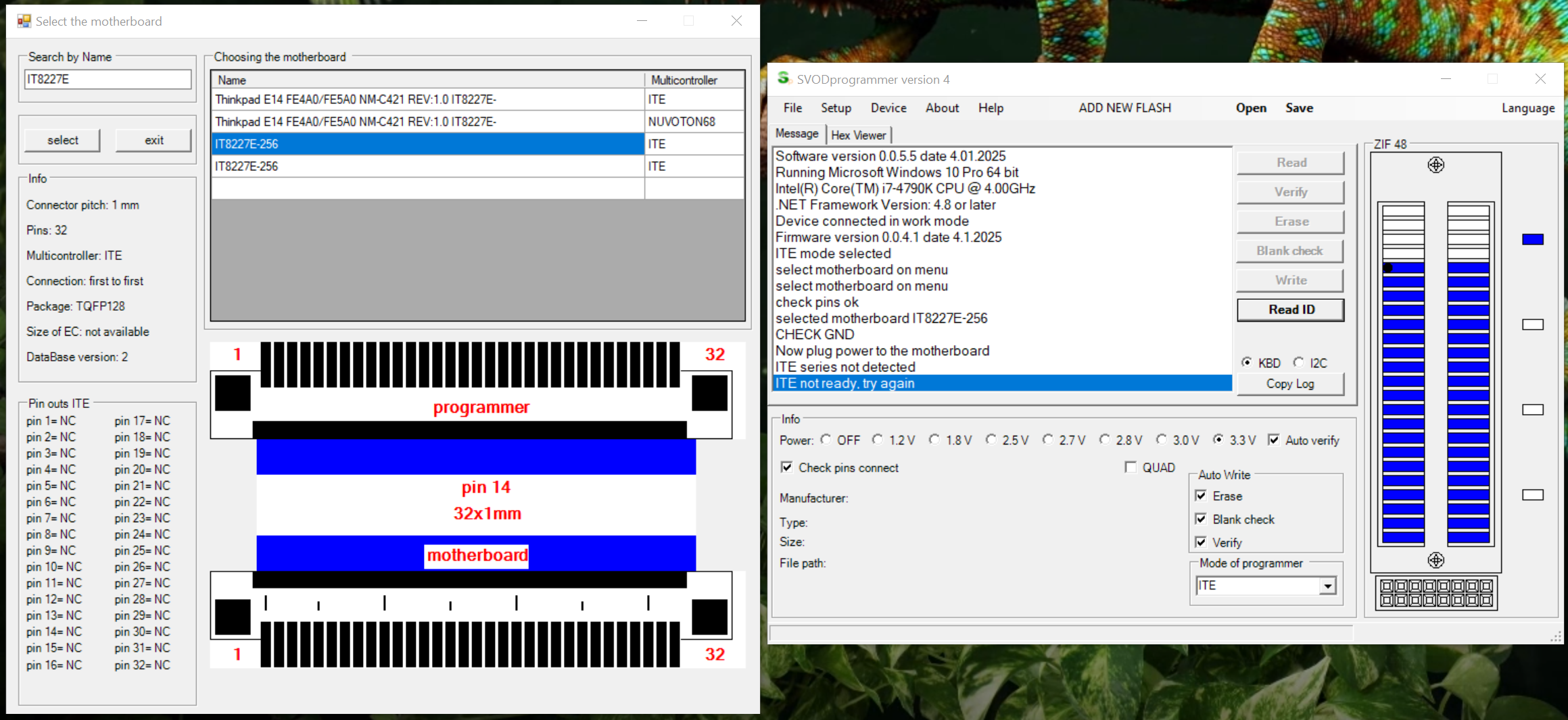

            Hello, I got the chips to read ok but will not erase and on my programmer it will not work on 3v I need 3.3v for it to work.
            I cut a lot of the address errors out so the log is not to long.
            I am sure I was reading somewhere on here the little bios chip 25q is needed to erase the ITE chip is there a recommended chip to use for this?
            Any idea's please?
            Software version 0.0.5.5 date 4.01.2025
            Running Microsoft Windows 10 Pro 64 bit
            Intel(R) Core(TM) i7-4790K CPU @ 4.00GHz
            .NET Framework Version: 4.8 or later
            Device connected in work mode
            Firmware version 0.0.4.1 date 4.1.2025
            ITE mode selected
            check pins ok
            selected motherboard ZIF Socket 128_ITE By Damian
            CHECK GND
            Now plug power to the motherboard
            Device ID: 27
            Device Revision: 2
            ITE series detected
            Flash ID: FFFFFF
            Start reading: 16/01/2025 10:36:39
            End reading: 16/01/2025 10:36:42
            Read OK
            Start erase in: 16/01/2025 10:36:54
            Erase error
            address: 0x000000
            Erase error
            address: 0x03FC00
            End erase in: 16/01/2025 10:36:54
            Erase OK
            Thanks.​

              Device ID: 27
              Flash ID: FFFFFF weird

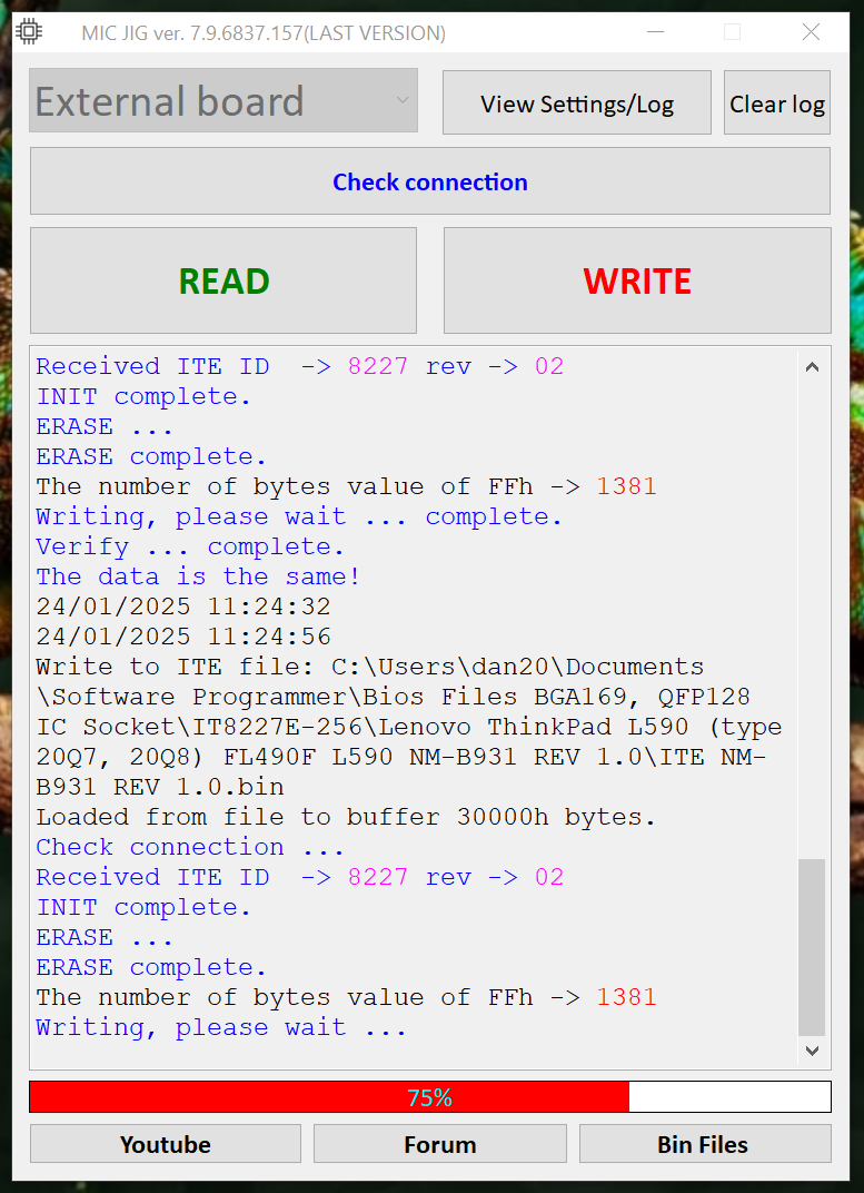

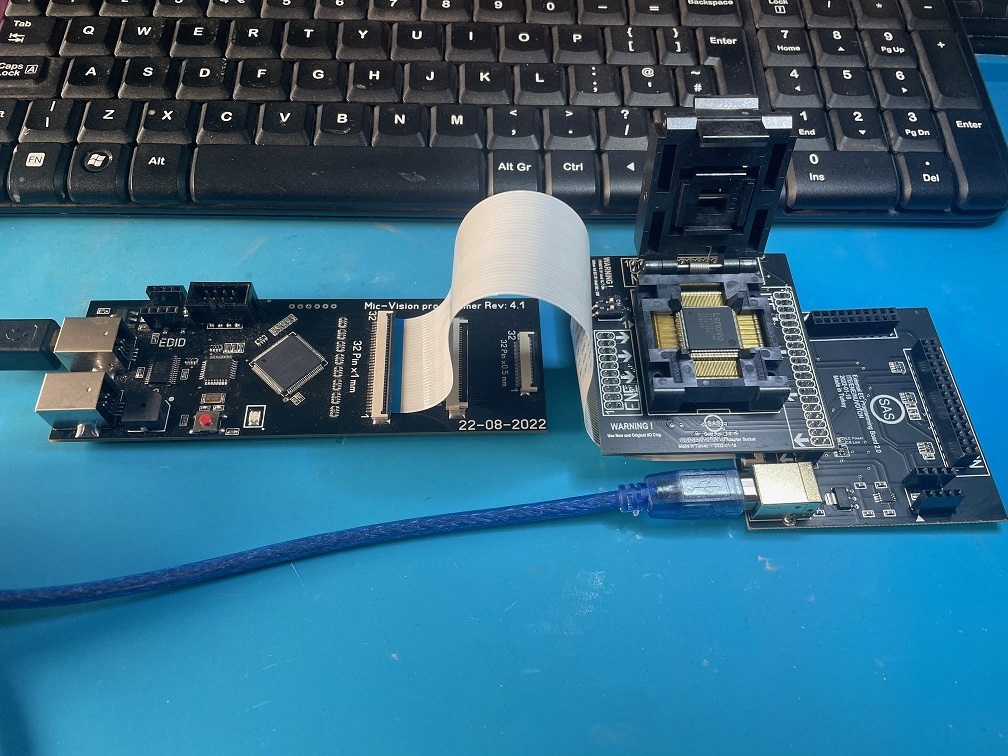

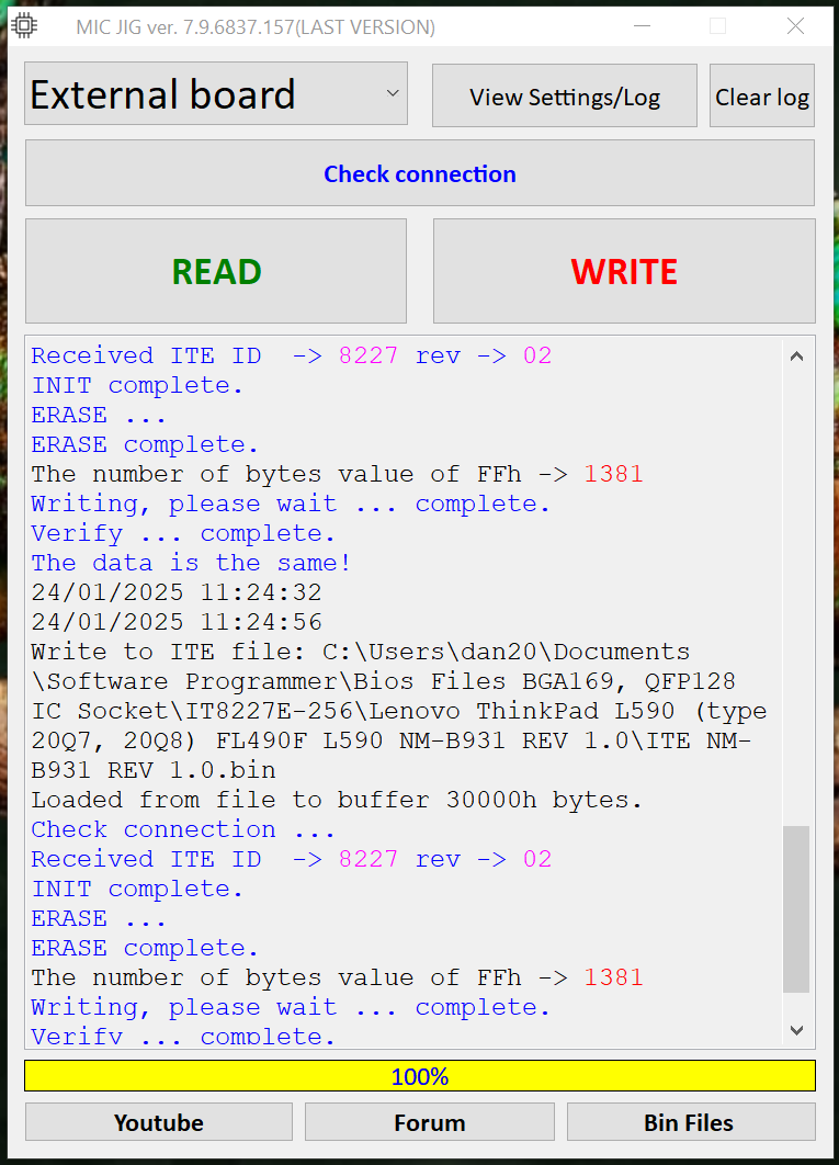

                  At last, I had to get another programmer to do this chip, cannot see why the svod4 can't do it, it has the latest update.
                  I will give it another go with the svod soon. all my chips have programmed fine have about 20 of these chips now.
                  Thanks again.
