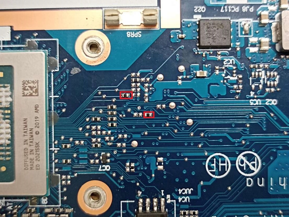

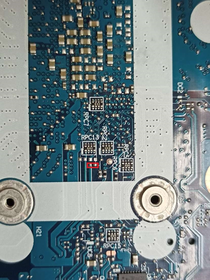

            ongobongo Try disabling the onboard RAM by moving the board ID resistors as shown in the attached photos:

                alexfts20, you my hero of the day. I had already looked at the memory configuration via resistors before, but as there was no option for deactiving the onboard memory, i didn't bother to dig any further. Now, with your feedback, I gave it a try and changed the config to one of the reserved ones (111) which actually disables the onboard modules :-)

                      This Board has 6 six positions for resistors (RC110-RC115) that define the internal board id and, with it, the type and size of on-board memory, see picture attached. Three of those 6 positions are populated with a 10K resistor each.
                      Depending on the combination of the populated resistors, you define a board id. If you have a similar board you will have one of the first six combination from the list attached. I changed my combination to one of the two "reserved" states.
                      To be more precise you need to make sure that the positions RC110, RC112 and RC114 are populated with a 10K resistor, while the others (RC111, RC113, RC115) are open and not populated.
                      Then you are in a reserved state that doesn't define any on-board memory. You must use a stick of memory to get it to boot.
