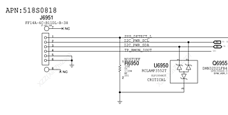

          I have a similar issue.
          I get the charging sign but nothing further, The current draw drops to 0.03Amps.
          • mon2
            • Dec 2019
            • 14634
            Posts #2 & #3.
            • Instafixx
              • Jul 2022
              • 374
              • India
              I plugged in the charger and did the thermal scan. Nothing.
              i am using a 96W adapter. Does this machine boot up without a battery?
              • mon2
                • Dec 2019
                • 14634

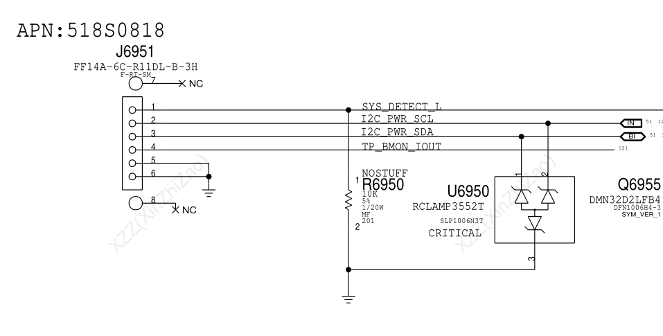

                Remove all power. Meter in DIODE mode. Red meter probe, yes red to ground.
                Black meter to point to test.
                Test the following SMBUS lines:
                I2C_PWR_SCL
                I2C_PWR_SDA
                Share the diode mode measurements of each line. ESD diodes @ U6950 may be defective from an ESD transient and causing these SMBUS lines to fail.
