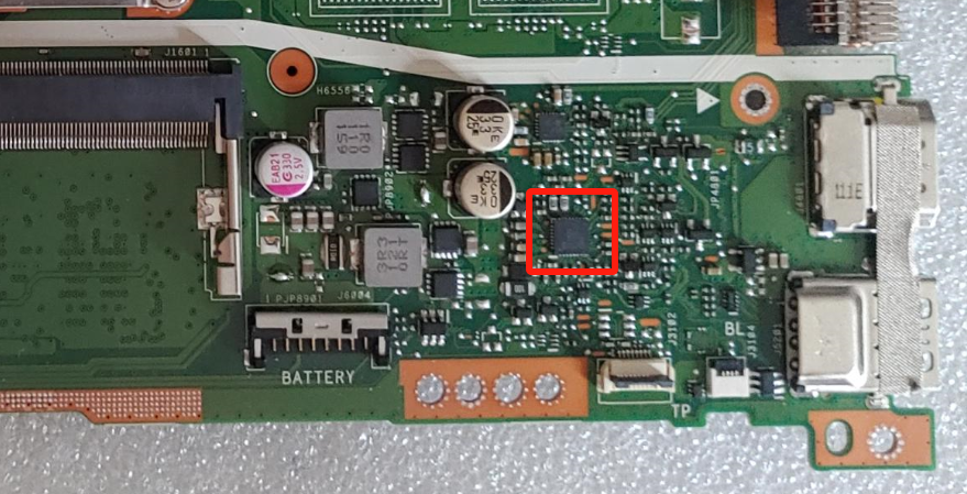

what model this chip is, thank you. X415JA Main board R2.1

ID:	3245066Can anyone tell me what model this chip is, thank you. X415JA MAIN BOARD R2.1

      Post a clear picture of the IC. markings are not visible in your pic.

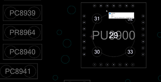

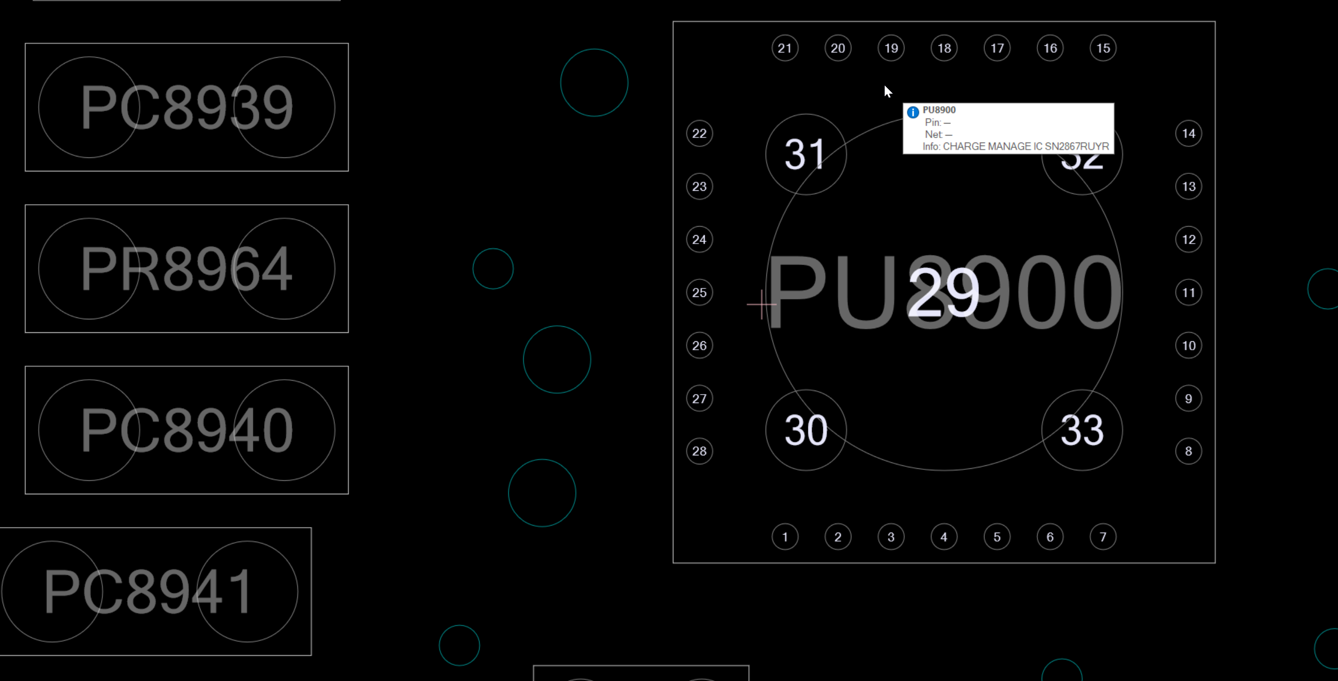

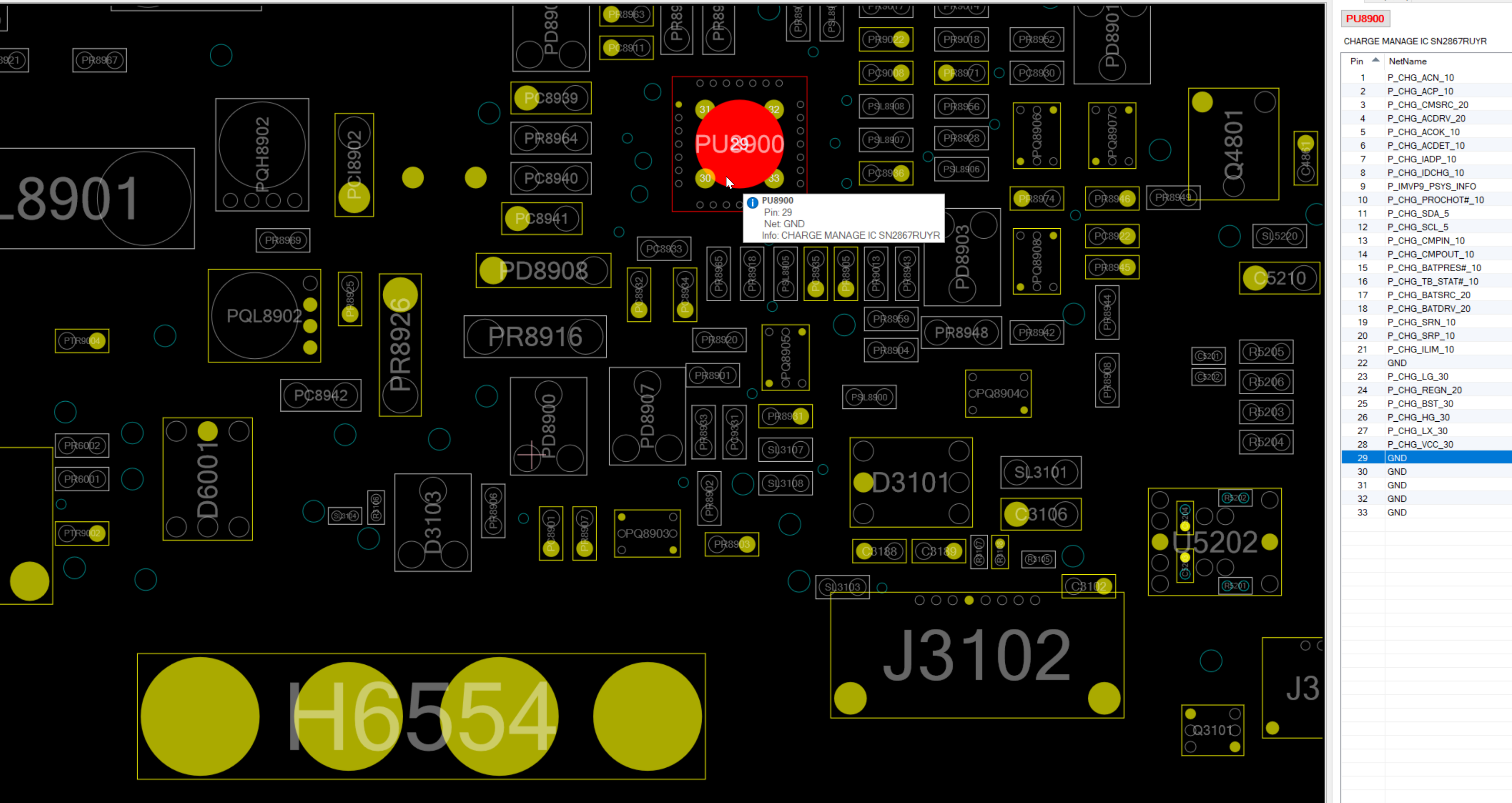

        See attached. PU8900 (from a similar board) and is TI part # SN2867RUYR.
        Do you need the BV file (X415EA) that is similar?

          BQ24780S
