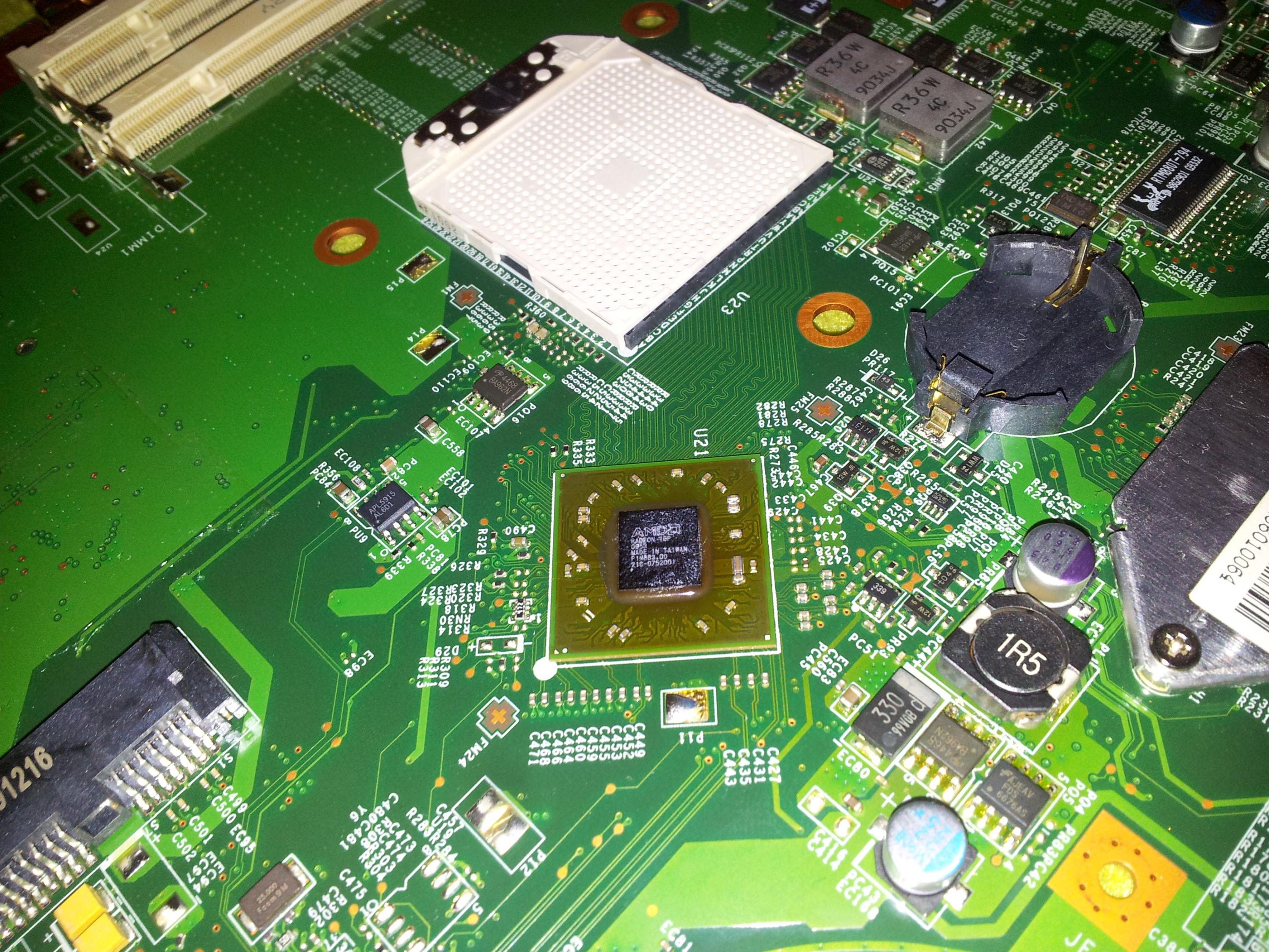

    #2. MSI CR610. Hadn't been repaired before. Had graphics corruption and then the owner reinstalled Windows 7. Booted Windows without a video driver, but would not even boot into Safe Mode once the driver was installed.
    Obvious overheating marks on the backside of the board where the chipset is, and on the substrate of the chip itself. Took the chip off, same overheating marks on the board under the chip, and on the contact side of the BGA. Attempted reball, came out perfectly but the chip didn't make it. Currently it lights up but no video at all, found a dead short on 2 of the little ceramic caps on the chip. Currently waiting for a new chip to arrive, i found a supplier of chips already reballed with lead, so it should work fine then.

                          Well, the result for the MSI is... still no display. Also the original chip does not appear to be shorted once i removed it from the board. The replacement chip measures ok on the board... Well, guess this board is dead. Moving on.

                              I think this board was just bust to begin with. Here the pics. Notice the obvious discoloration marks.
                              I looked at the recent works of another reballing service here in Romania, and among the latest repairs are two with RS880M chipsets, so that pretty much confirms my suspicion.

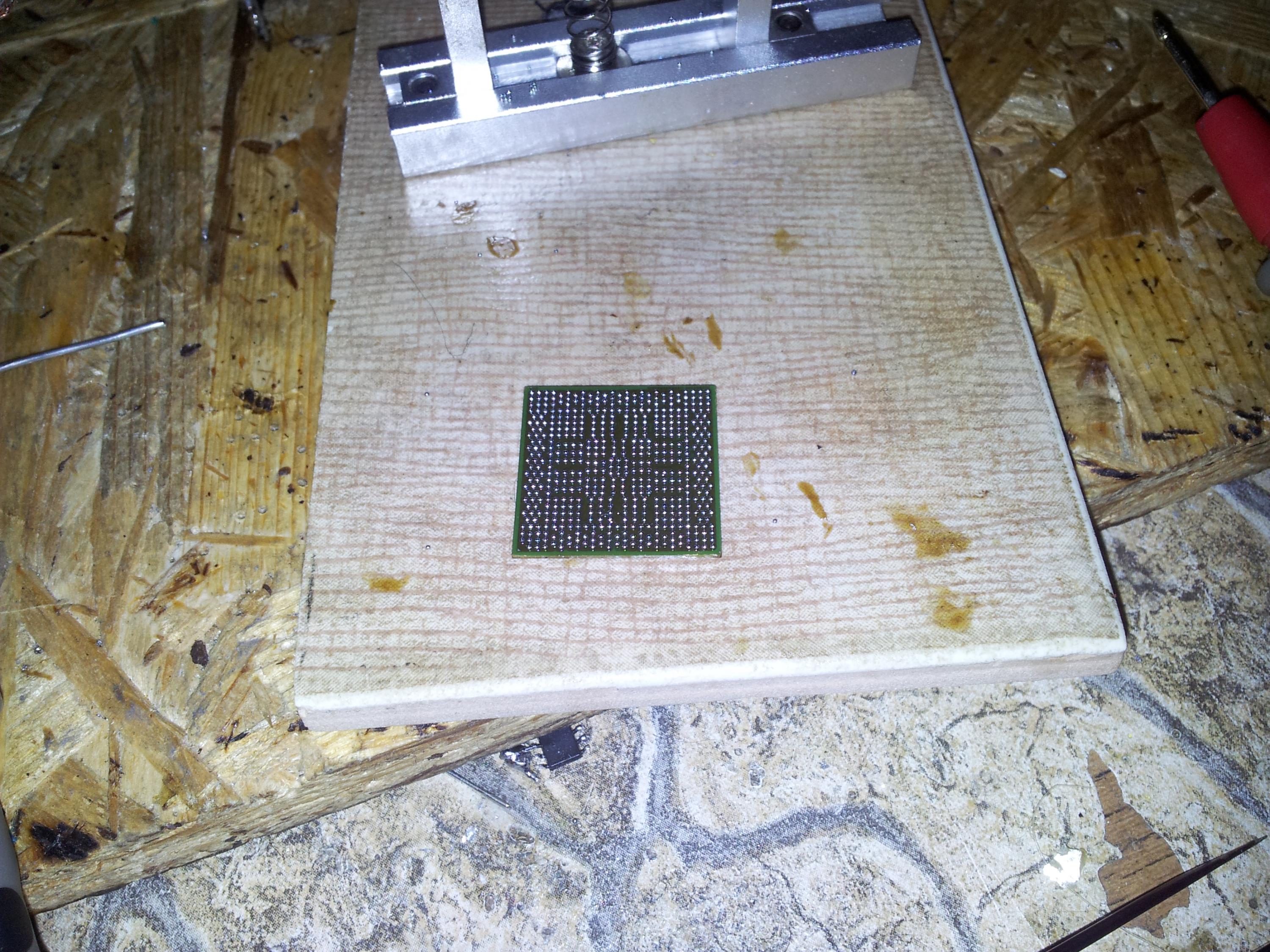

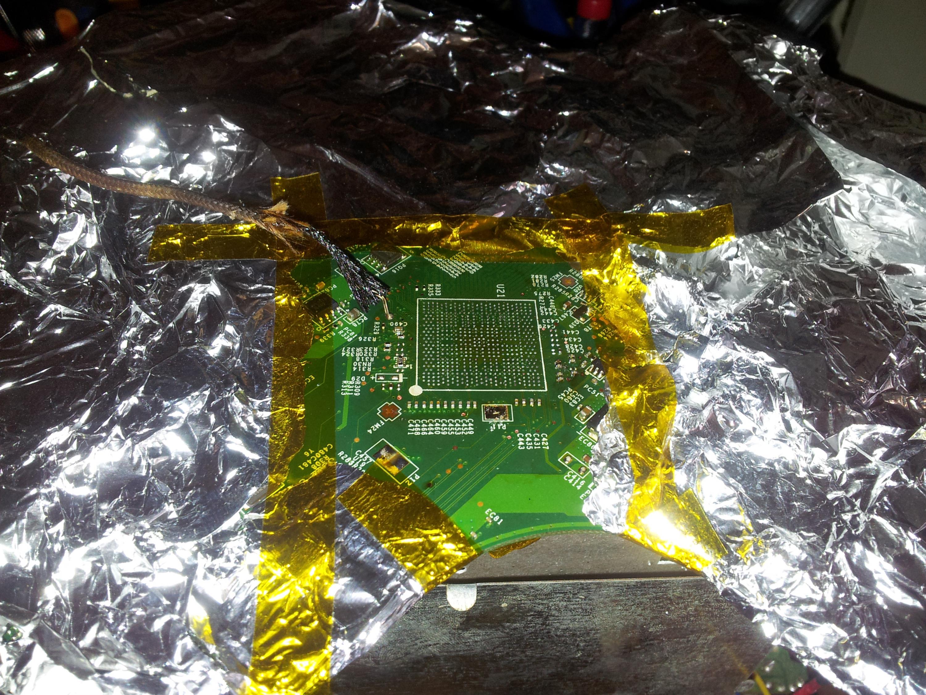

                                        Eventually decided to go by what you said and reball the existing NB chip, did not replace. Working fine now. But darn those pads are small. Before cleaning, they were literally the size of a pin tip - no wonder they get unsoldered.
                                        Managed to move a few 0402 ceramic caps when lifting the chip and cleaning the board, had to place and solder them back. But other than that, reballing went smoothly with no issues.
                                        You can also notice the shit quality of the board's solder mask, which scraped off in a few places.
