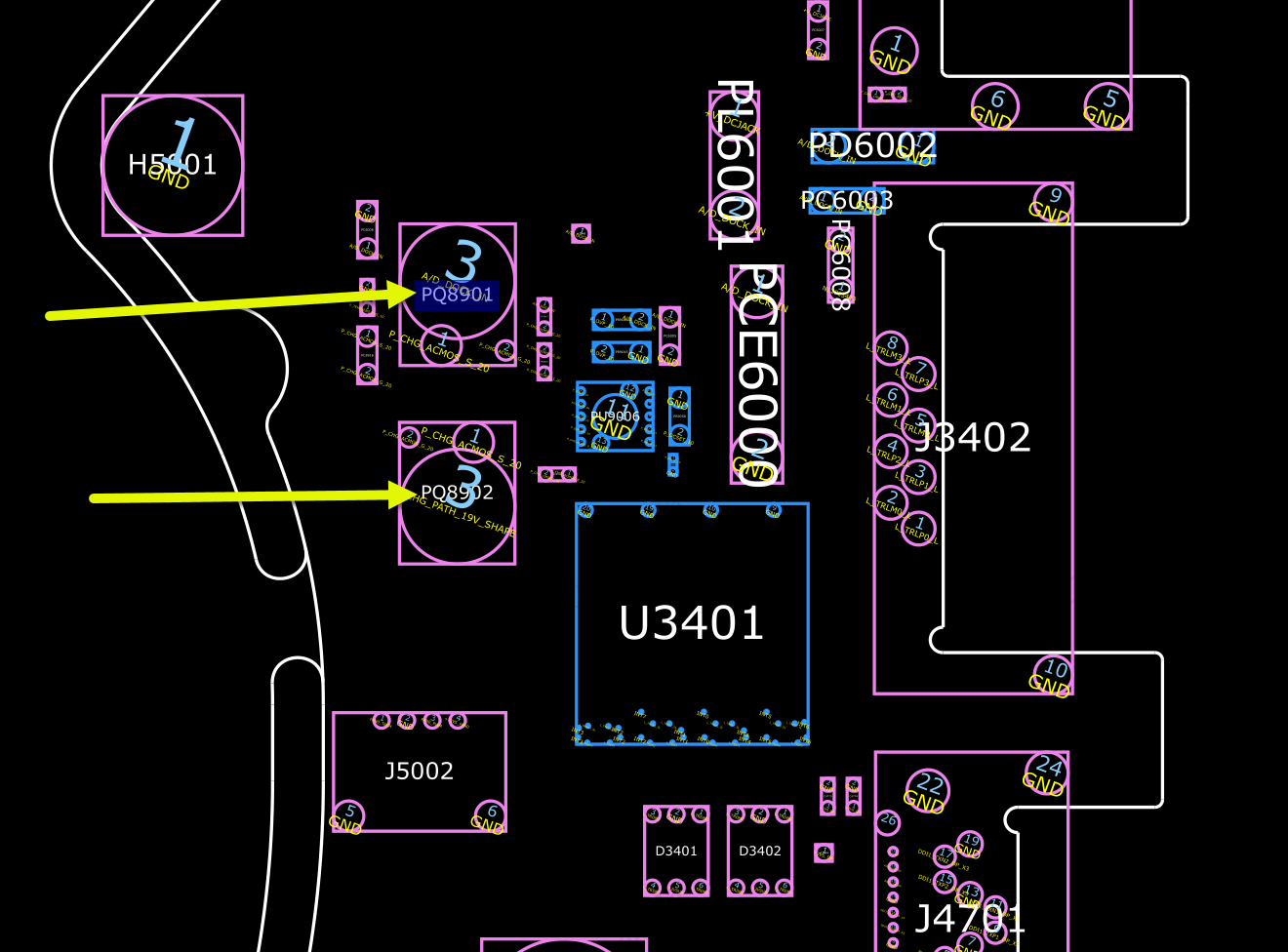

          #104
          I'm a bit lost reading schematics, nor do I actually have them. Where would PQ8901 and PQ8902 be located? Are these the ones you had me test far earlier in this post?
          • mon2
            • Dec 2019
            • 14677
            #105
            I think so but here are their locations again.
            Locate the dimple on the topside = pin # 1. Then proceed to measure as above but only with the power off. Provided the charger IC is soldered in ok, the ACDRV voltage should be ~25 volts unless one of these mosfets is defective. Often, the 2nd DCin mosfets is the bad one but test both.

              Okay, these got a little confusing because I ended up with different measurements going over them a second time to verify.
              (1st time);
              PQ8901
              S+D: 0.0Mohm
              S+G: 4.7Mohm
              G+D: 4.7Mohm
              PQ8902
              S+D: 0.0Mohm
              S+G: 4.7Mohm
              G+D: 11Mohm
              (2nd time);
              PQ8901
              S+D: 5.0Mohm
              S+G: 4.7Mohm
              G+D: 11Mohm
              PQ8902
              S+D: 5.0Mohm
              S+G: 4.7Mohm
              G+D: 11Mohm

                #107
                PQ8901
                S+D: 5.0Mohm
                S+G: 4.7ohm
                I think you mean 4.7Mohms? If they are Mohms - the readings are ok. More concerned then if the solder connections are mating on each PCB pad.
                Remove all power. Measure the resistance to ground of the REGN pin on this charger IC. We are checking if there is a short on this line.
                Flux the IC and reflow the part with enough heat to melt the solder and allow for the charger IC to swim into place. Apply the hot air tool in circles over the charger IC to keep each area of the part heated.
                I think the very first check should be to rework the IC till you have the REGN pin @ ~6 volts. This is fundamental and works by taking in the ~19v and lowers it to 6 volts = LDO regulator. Simple. Since we do not have this - review the soldering / review that pin # 1 of this new IC is where it should be.
                PS: Just reviewed your topview soldering and your pin # 1 is correct on the board. Need to still review if there is enough solder on each pad so flux and reflow it. Low air pressure so the tiny parts nearby do not go flying across the room.
