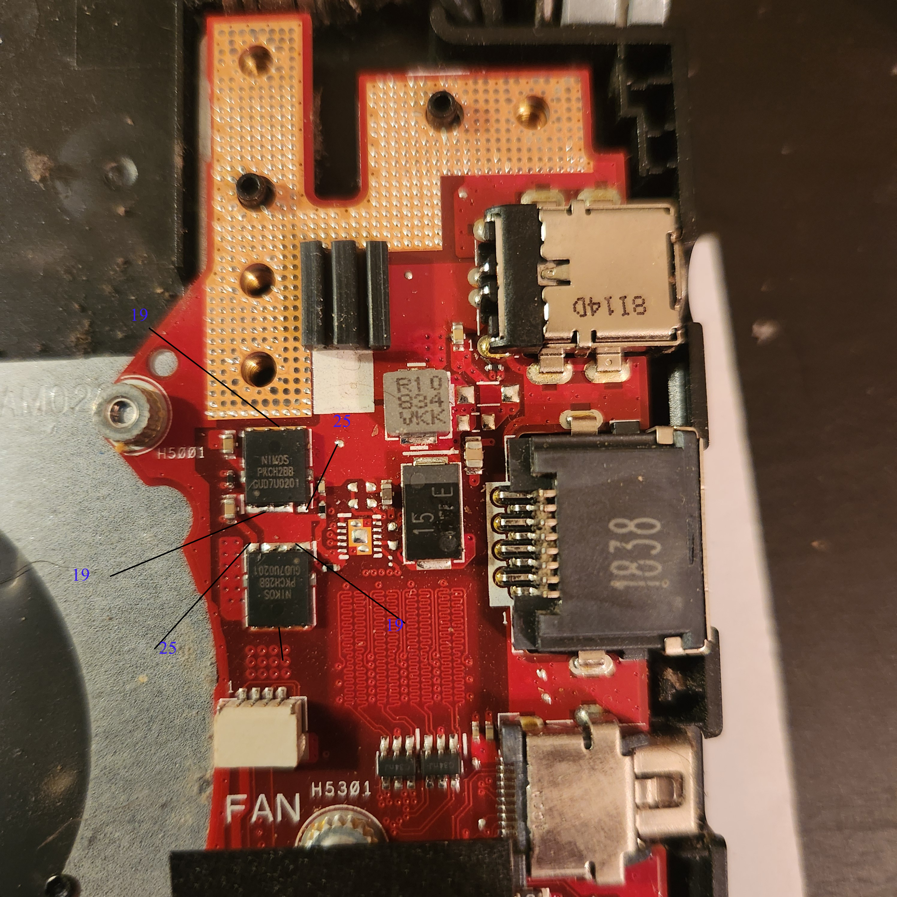

      mon2 Drain pin on PQ8902 is measuring a bit all over. One pin seems to want to measure out 8-10m, another wants to jump around from 26k to 200k. Sometimes I'm even getting 0.002m, so I'm unsure if that's just because of auto on the meter?
      • mon2
        • Dec 2019
        • 14673
        #43
        The drain pins will be pins 5-6-7-8. Any of these pins can be used to mate with the drain cluster of pins. So one meter pin on say pin # 8 on this mosfet; other meter pin to ground.

            #45
            Then you are ok here and the main power rail is not shorted. Next, need to review the charger ic to confirm it is being powered.
            Are your meter probes fine tipped enough to measure the contacts of the charger ic? Remove all power and then check if the probes are fine enough.
            If yes, carefully (!!!) measure each pin’s voltage to ground on the charger ic and share the list.
            While not every pin is of interest, need to know the voltage of the pin that drives these 2 mosfets (ACDRV). The ACOK pin. ACDET pin. Not at my desk but these are common labels on every charger ic.

                              #54
                              reformatt
                              Going off of this previously posted image from mon2, the pin that I measured is pin1. Pin8 did have a reading, but I don't recall what it was. I can measure again when i get back home if needed.
                              That R010 resistor is exactly where I shorted the battery connector clip. Could that be the issue?

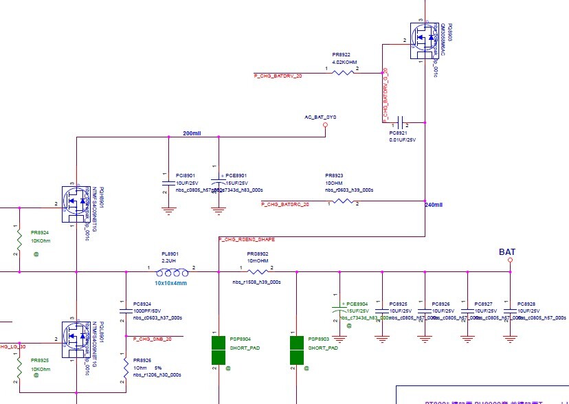

                                #55
                                Pertinent section attached. PR8902 is a current sense resistor and is in series so check this to ground. As you are looking for a short to ground, likely suspects are any components that have a direct path there (like caps PC8925, PC8926 etc, or PQL8901). But shorts like the one you created usually damage silicon components, not passive ones. So PQL8901 would seem to be the most likely.

                                      #58
                                      reformatt I'm not very affluent in reading these diagrams. I'm garnering that PQL8901 is the lower of the two mosfets? What should I be measuring to ground? Both voltage and resistance have been measured already.
                                      • reformatt
                                        • Feb 2020
                                        • 1507
                                        #59
                                        Yes it's the lower one, PQL8901 is the component designator, which we would use to marry that up to its physical location on the board with a boardview (which to now I haven't located anywhere).
                                        As nickstyle alluded, it's becoming very difficult to track what has and hasn't been checked as the thread is quite long. So I'd start over. All resistance checks are without power, and no battery connected.
                                        1. Check main +19V rail for resistance to ground at the current sense resistor PRS8901. It will look similar to PRS8902 near the battery connector, and might be on the other side of the board. Should be marked R005 (5 miiliohm resistor).
                                        2. Check charger output resistance to ground at PRS8902 (R010 resistor).
                                        3. Assuming non-zero value at PRS8901, plug in power, confirm voltage at this resistor (previously reported as 0V).
                                        PU8900 is the charger IC. Schematic has SN2867RUYR, but ASUS boards are often fitted with a BQ24780S IC as that is a direct replacement. It controls the first two MOSFETS PQ8901/8902 which are disabled unless certain conditions are met (or the IC itself is defective). Most incidents like yours usually destroy that IC, but you need to locate the source of this short first.
