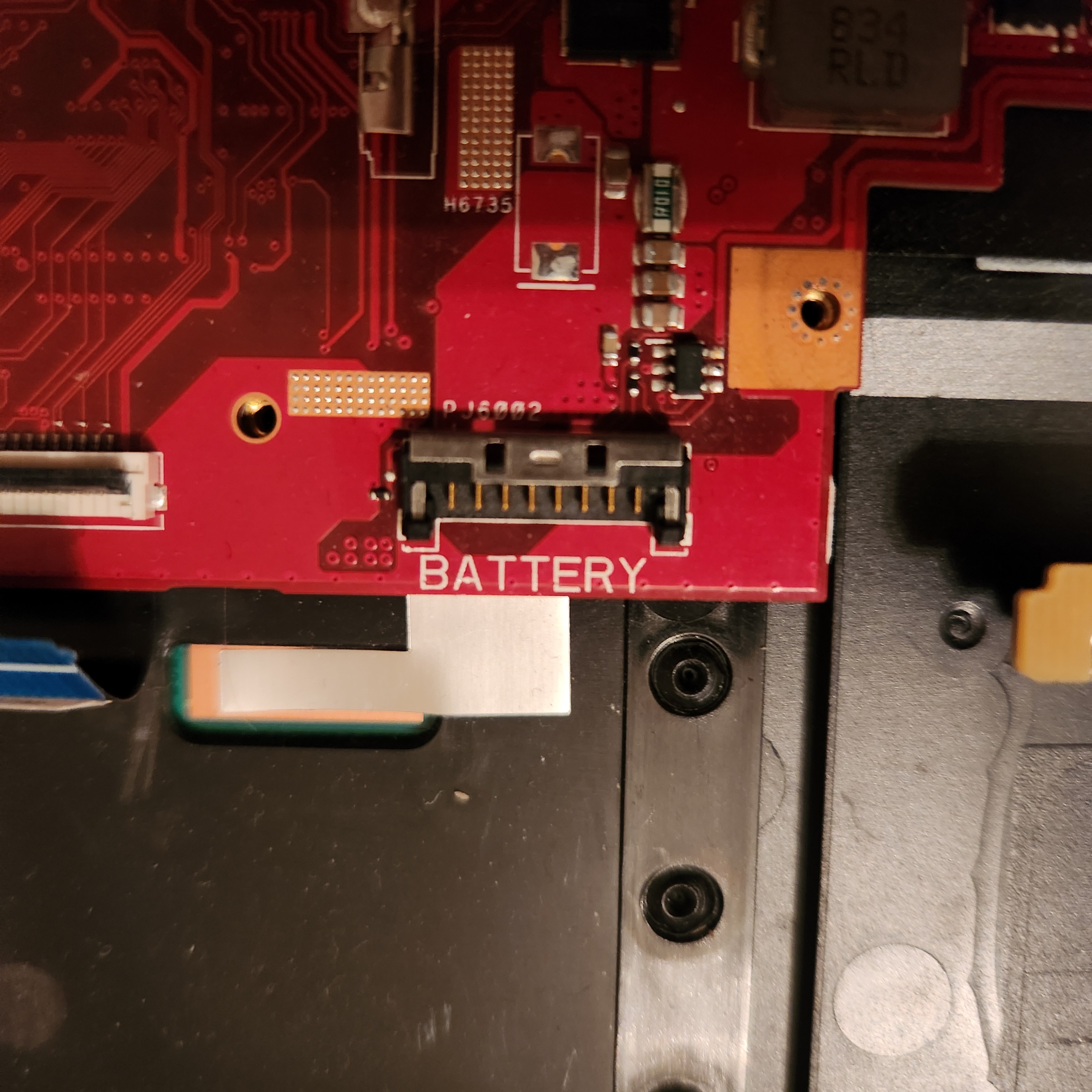

    Are you measuring across these components, or with one probe on ground?
    As far as measurements go, small m is milli, large M is Mega. 6milliohms and 10 millohms appear to be across the current sense resistors, not resistance relative to ground.
    • GlassMonolith
      • Mar 2024
      • 63
      #62
      reformatt I'm measuring everything to power connector ground. I haven't noticed if my meter is showing lowercase m, I think it's always M but I'll double check. **edit; Yes, it's all M**
      Do i need to measure across both sides of the resistors though?
      • reformatt
        • Feb 2020
        • 1507
        #63
        Well none of that makes sense to me. You say that pin 1 of the battery connector (which should be your positive terminal) measures 0 ohms to ground, however it measure 6Mohms at the current sense resistor? They are connected together so should measure identically.
        • GlassMonolith
          • Mar 2024
          • 63
          #64
          reformatt Measuring pin 1 again. Just to be sure, I've taken a photo and measured the end pin on both sides.
          Far left: 5M ohm
          Far right: 0.0 ohm
          • reformatt
            • Feb 2020
            • 1507
            #65
            So neither your main rail, nor your battery rail is shorted. So go back to mon's post #45, you need to check out your charger IC voltages. Likely based on what you did originally, you destroyed this IC.
            Where this got derailed (for me anyway) is you put down your battery rail resistance to ground was 5 milliohms, but this proved to be 5 Megaohms 🙄.

              #66
              reformatt Learning from my mistakes here. 😅 Can a multimeter even read milliohms, though?
              Alright, so would you be able to elaborate a little better what Mon is asking? Being very very careful with fine tip probes, I'm measuring what pins with DC voltage?
              • reformatt
                • Feb 2020
                • 1507
                #67
                These are the main ones, expected values are adjacent if the chip was working correctly.
                Pin 28 (Vcc) --> 19V or so with adaptor
                Pin 24 (REGEN) --> 6V
                Pin 5 (ACOK) --> 6V
                Pin 6 (ACDET) --> 2.6V
                Pin 4 (ACDRV) --> 25V
                You can use a BQ24780S as a replacement for this chip, might even be what's fitted on the board instead of SN2867.

                  #68
                  reformatt Honestly, I'm not even sure where these pins are supposed to be located.
                  I can assume different components, but which ones eludes my knowledge here.
                  • GlassMonolith
                    • Mar 2024
                    • 63
                    #69
                    I'll take all the photos you need if you're able to point them out for me.
                    • reformatt
                      • Feb 2020
                      • 1507
                      #70
                      No boardview for this model unfortunately, but you can use the datasheet for the BQ24780S
                      https://www.ti.com/lit/gpn/BQ24780S
                      Page 3 has the pinout. There is a small dot on the chip to show where pin 1 is.
                      If you don't have the equipment or skills to replace a QFN IC I would highly recommend you send this board off to someone who does.

                                #75
                                That was going to be my next question; could I measure to the nearest component/closer side on the circuit. I did notice that half the pins have nearby test pads too, so I think I should be able to knock this out pretty smoothly now.
                                • GlassMonolith
                                  • Mar 2024
                                  • 63
                                  #76
                                  reformatt Alright, got some positioning probes and here's what I have:
                                  1: 0.02v
                                  4: 0.02v
                                  5: 0.02v
                                  6: 2.6v
                                  24: 1.2v
                                  28: 19.0v
                                  6 & 24 was measured to the nearest resistor end. Let me know if I need to measure anything more. I'll do every pin if needed.
                                  • reformatt
                                    • Feb 2020
                                    • 1507
                                    #77
                                    Pin 24 is your REGEN voltage, should be 6V. This is an internal linear regulator within the IC derived from Vcc (pin 28). The chip is very likely faulty.
