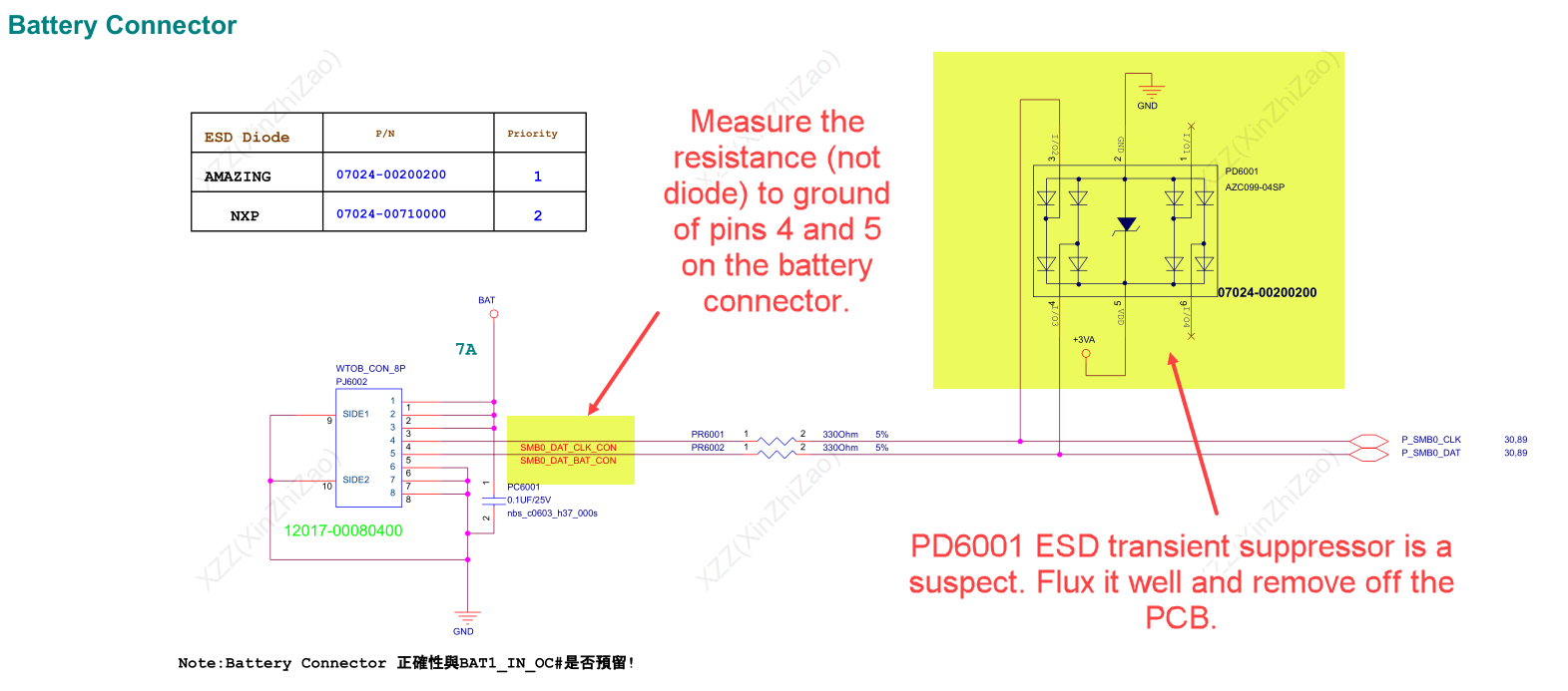

    With no power, meter in resistance mode (not diode mode), measure the resistance to ground of each of the battery connector pins.
    concerned about the 6 pin part that is with the ‘c34’ topside markings. Suspecting this to be an esd device. This device, if shorted, will tank the smbus communication with the charger ic.
    if convenient, flux this c34 part well and remove it off the board. Then measure the resistance to ground again of each of the battery connector pins. Do not lose this part. We may need to place it back. Protect plastic parts from heat with aluminum foil.

      See attached. Measure the resistance measurements without a power adapter and without a battery.

        Measurements using the power connector as ground still, are;
        Pin 4: 0.83kΩ
        Pin 5: 0.67kΩ
        (I may have the pin numbers backwards)
        If this isn't conclusive enough, I'll remove the esd, I'm just slightly intimiated by how small it is.

          These smbus / i2c lines are not shorted.

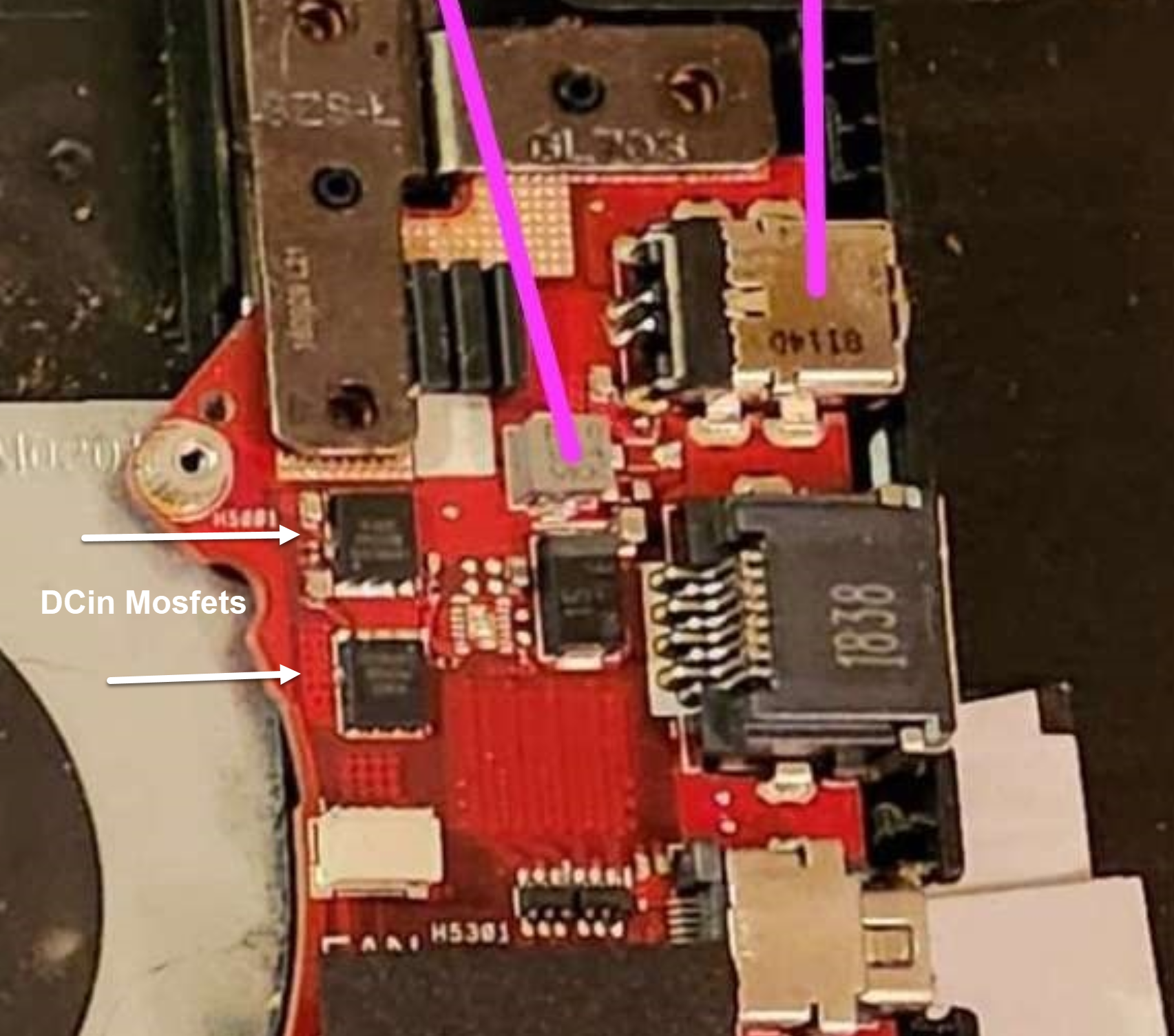

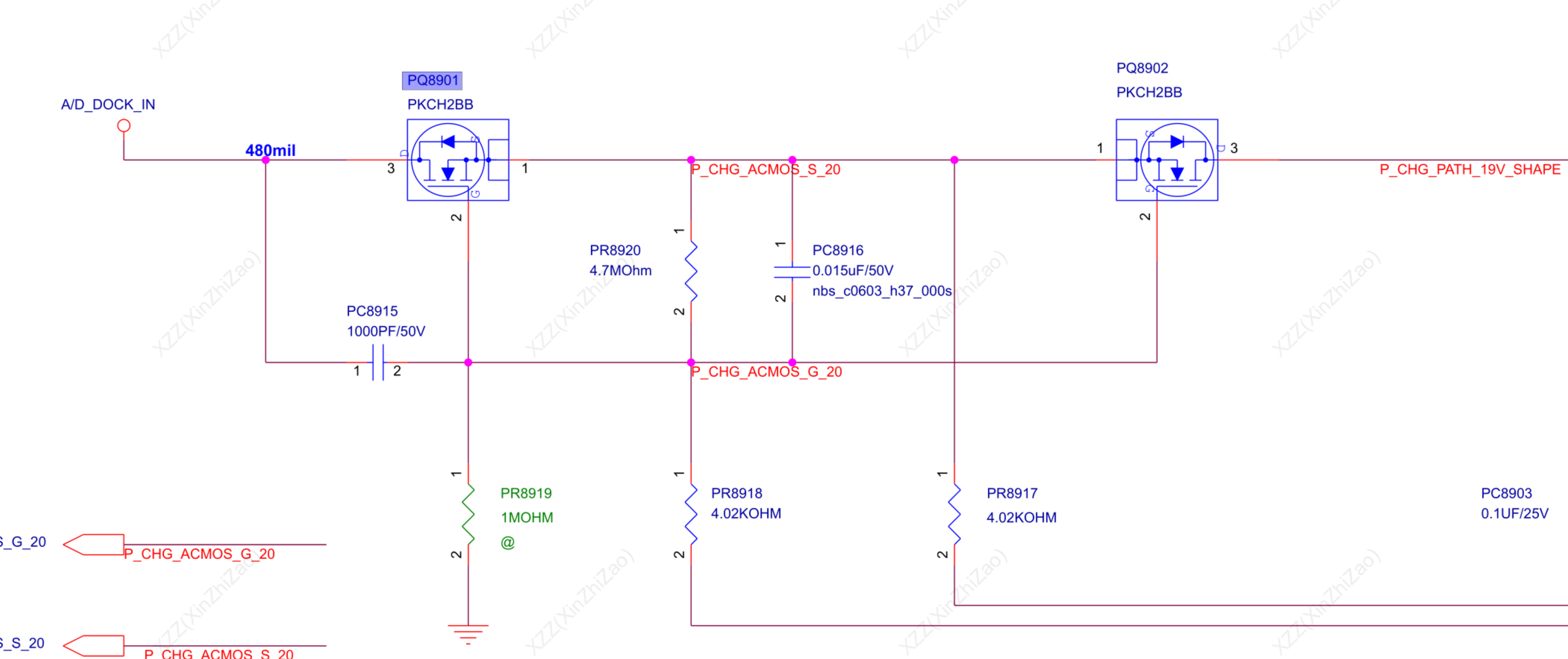

                        See attached. These are the DCin mosfets. Measure the voltage to ground of each pin with the power adapter connected.
                        Click image for larger version  Name:	dcin_mosfets.png Views:	0 Size:	294.3 KB ID:	3259324

                          DC voltage?
                          Top pins of upper mosfet measure 19v, all other pins on both mosfets meter somewhere between 0.01 and 0.02

                            Continue to review these mosfets. Meter in resistance mode. Remove all power.
                            Measure the resistance across these mosfets again.
                            source (1-2-3) & drain (5-6-7-8)
                            source (1-2-3) & gate (4)
                            gate (4) & drain (5-6-7-8)
                            post each measurement for each mosfet.
                            • GlassMonolith
                              • Mar 2024
                              • 63
                              #34
                              mon2
                              Top:
                              S+D= 9.2m
                              S+G= 4.7m
                              G+D= 10.8m
                              Bottom:
                              S+D= 9.0m
                              S+G= 4.6m
                              G+D= 13.0m

                                These mosfets are not shorted but not turning on.
                                With no power, measure the resistance to ground of the drain pin of PQ8902. This is the main rail for the logic board. Checking if this main rail is shorted.

                                  I'm unsure which one would be pq8902.

                                        PQ8902 is the mosfet that does not have the 19 volts. The first mosfet that is mated with the DCin adapter has its drain pin connected directly to the raw power pin.
