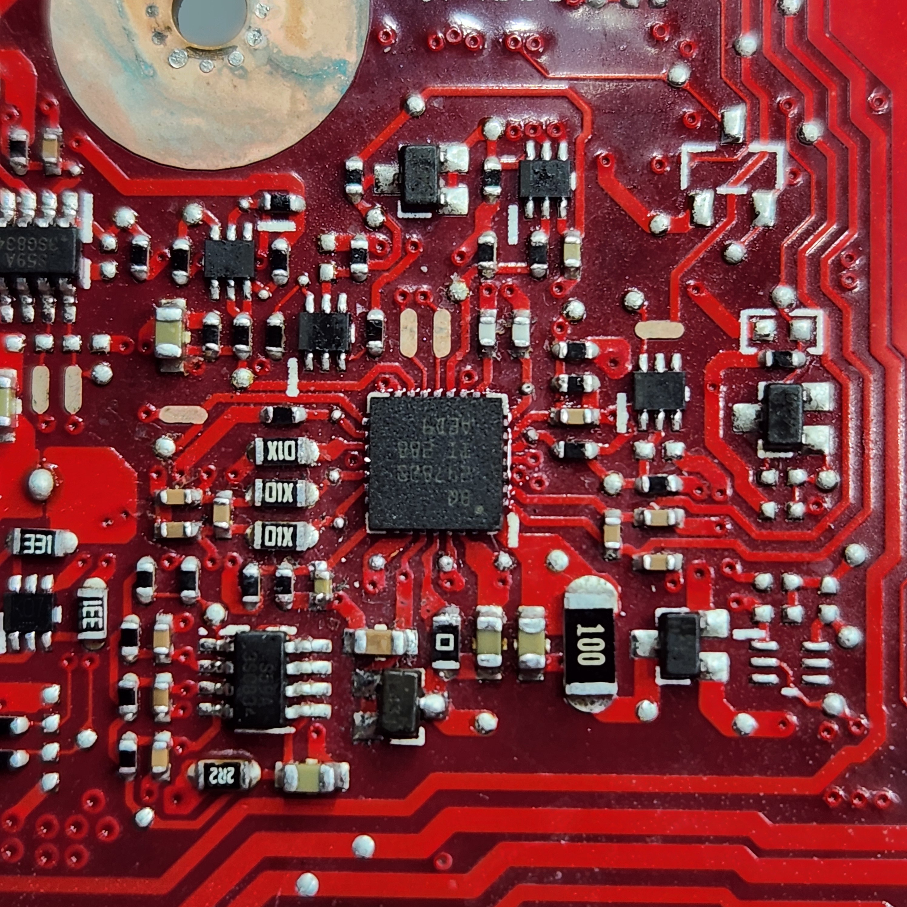

    To me, that is a low resistance. For giggles, flux and remove the cap that is on this rail. Then measure the resistance again on this pin.
    • GlassMonolith
      • Mar 2024
      • 63
      #82
      mon2 Okay, so I took off the cap circled in the photo. Still measured 50ohm.
      On an unfortunate note; I managed to accidentally swipe off an additional cap (as seen in photo) and have no idea where it even went (I cleaned my iron tip before realizing it was gone). Hopefully it's easy enough to figure out what cap to replace it with?

        Yes, we should be able to determine the missing cap details from the datasheet of the bq24780s charger ic.
        Meter in resistance mode. No power to the board. Measure the resistance from the top pad of the missing capacitor to each pin on the charger ic. Stop when you find the pin that shows ~ 0 ohms.
        Also, carefully flux and remove the sot23 3 pin part with L43 markings. Do not lose the part.
        Then measure the resistance to ground again of this REGN pin. Still at 50 ohms?

          mon2 Okay, I measured every pins resistance, and the one with 0 appears to be pin 18. I'm going to work on pulling the sot23 in a couple hours.

                #87
                Replace the BQ24780S IC.

                    #89
                    Cap on pin 24 is 2.2uf 16V 0603, pin 21 is 0.1uf 25V 0402

                        #91
                        Originally posted by GlassMonolith
                        reformatt And just to verify, that's for the cap that measured 0ohm on pin 18?
                        According to the schematic, nothing is connected to pin 18. Pin 1 starts from the RHS where the dot is and counts counterclockwise. In your photo you have removed two caps, one is on pin 21, the other pin 24. X5R should be fine.
                        No difference between the two BQ chips - difference in numbering is just for tape and reel packaging. Check the datasheet.

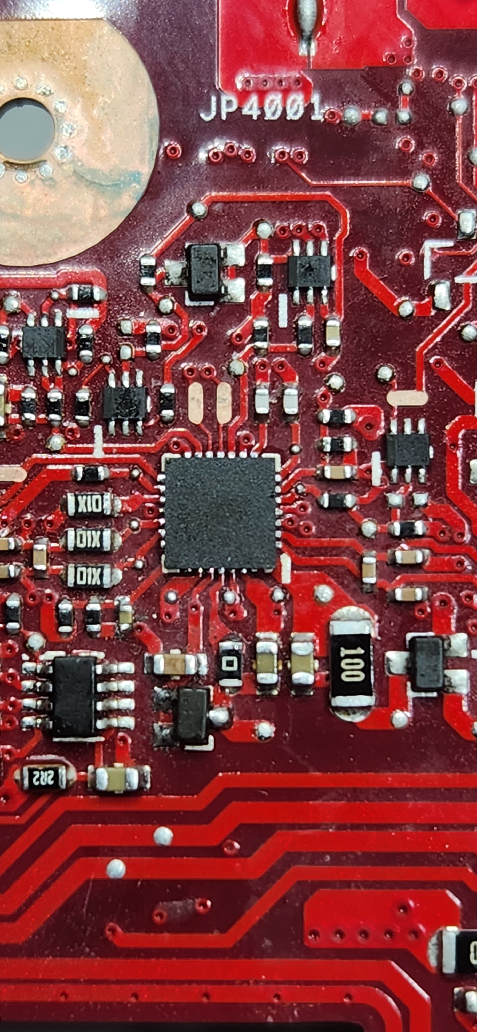

                                    #97
                                    Post a pic of the reworked charger ic.
                                    Does the logic board boot with the power adapter?
                                    Carefully(!!) measure the voltage to ground of each pin on the charger ic with the power adapter connected.
                                    Post the table of values with each pin / function label.

                                      mon2
                                      Working on the measurements asap, but here's the photo.
                                      • mon2
                                        • Dec 2019
                                        • 14673
                                        #99
                                        Top view looks good but be sure that the writing on the replacement is 100% in the same orientation as the original.
                                        Only then we know that pin #1 on the IC = #1 on the PCB.
                                        Pour some alcohol onto the top side and share an angle pic so that the writing of the topside is visible. Only for inspection by the internet techs.

                                          #100
                                          Full IC pin;

                                          And photo for the internet techs;
