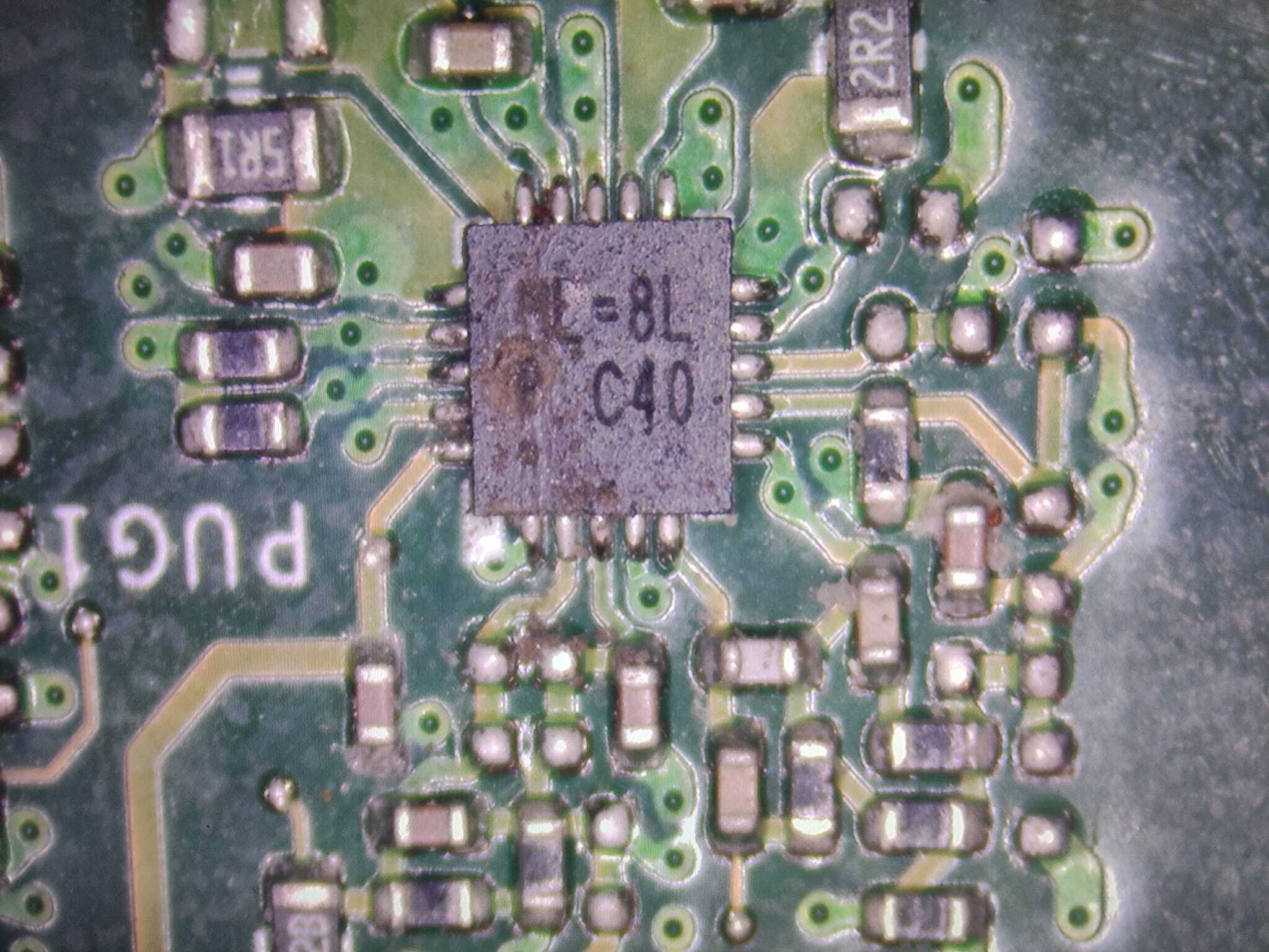

Can anyone identify this chip ML=8L and what it does?
    My computer is dead and I think this burnt chip might be the cause.
    All it says on it is "ML=8L C40" and when I do a google search, there is nothing. I have the schematic (FH5LI LA-J801P Rev:1.0 in boardviewer but it does not give the names and numbers for ANY of the chips.
    Anyone else got a better schematic of this board or something that will identify this chip?
    Click image for larger version  Name:	431625681_1048976662872351_4626859579409988198_n.jpg Views:	6 Size:	281.3 KB ID:	3231176
    Thanks.

    Anything with '=' is from Richtek. So search for 'ML= Richtek' on Google and you will get a hit:
    High Efficiency Single Synchronous Buck PWM Controller for INTEL VCCIN AUX ICL ,and TGL (richtek.com)
    Part # RT6543AGQW

      I just made an enquiry about it and they said it needs programming but I've no idea whats involved.

        What do the codes mean on the top?

          often modell and funktion (xxxx) Date (xx) and Batch no: (xx)
