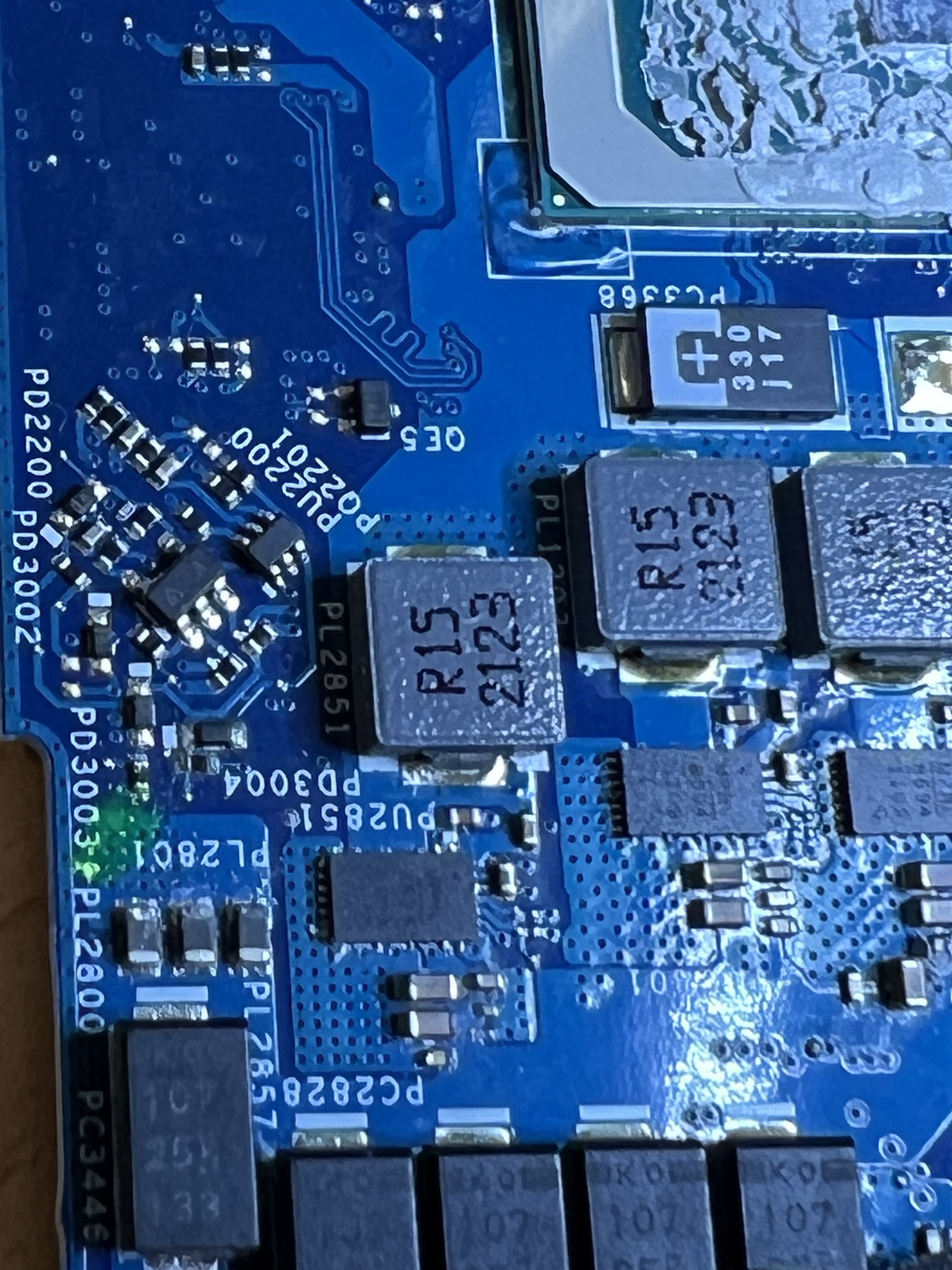

    Removed the board and found dust corrosion around the following: PL2801 PC2828 (top right corner above the CPU) which looks like one of the CPU phases. Remarkably none of those components there read short. PL1600 & PL1602 (mid left corner above the second VRAM chip) were completely charcoal due to a shorted line, which seems to be caused by corrosion on a MLCC directly on the other side of the board through 6 via. I have not removed any caps yet though so can't say for sure.I did however remove both burned inductors and it is the bottom pad towards the DIMM slots that is shorted 0.7 ohm. There also is dust corrosion around the passives above UV22 (top left corner diagonally left from the third VRAM chip) and the two MLCCs read dead short which looks like the power regulation for the video memory.
    Given that the corrosion is around the worst two spots on the board, CPU & VRAM, does anyone have known good readings of the CPU and video memory? This board's using GDDR6 Samsung. I don't want to dig into what's happened to find out congrats your GPU or CPU is dead.
    I unfortunately have not been able to find the correct schematic for this board, only the LA-H331P which seems to be the previous year's model. No boardviews either.
    I've attached two photos of the corroded areas for reference.

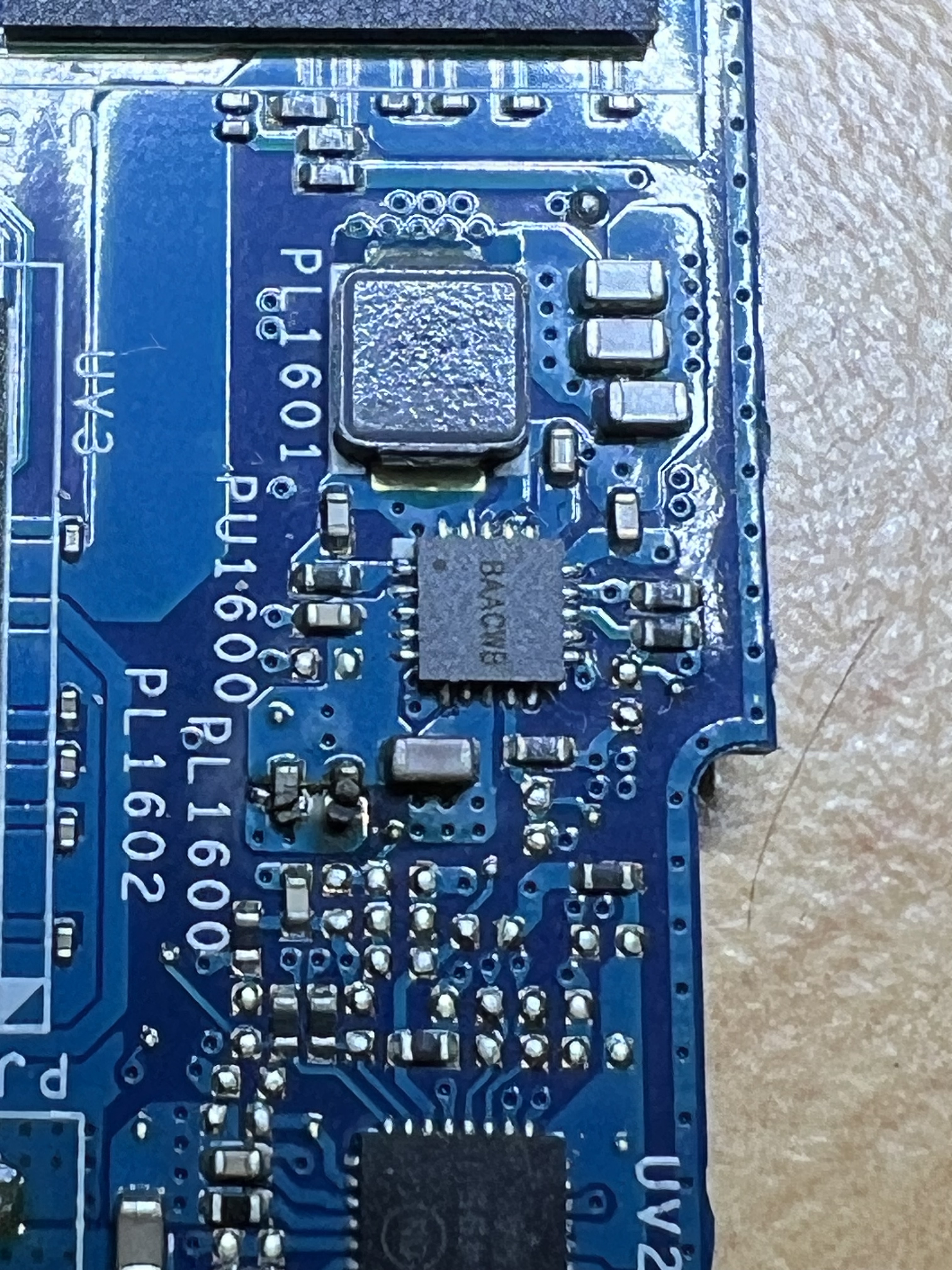

    PL1600/1602 is VIN for PU1600. Remove PL1600/1602 and checck resistance to GND on both pads of PL1600/1602. Lets first check whether there is any shorting.

      Thanks for the info. Removed both PL1600 & 1602 and found the second pin was shorted (pin closer to the RAM slot, apologies don't have the schematic, so I don't know whether it's pin 1 or 2).
      Turns out the cap I thought was shorted was indeed shorted. The big MLCC that is directly on the other side of the board through the 6 vias next to the two burned inductors. Removed that cap and what do you know she's working!
      Curious to know, what is that line for? Just want to try get a understanding of what happened and what caused it, and more importantly what could of been damaged and weakened in the process. She's working for now, even the 3050ti is showing up in device manager no dreaded error 48. But for how much longer.....?

        The IC marked BAA on the pic is silergy product used as DC-DC regulator. It can be configured to output 4V-23V,so very likely its either used for 3.3V/5V rail.
        The cap is very important here and should be replaced. In the absence of schematic,try any cap rated for 25V and atleast 1uF(better to use 10uF/25V)

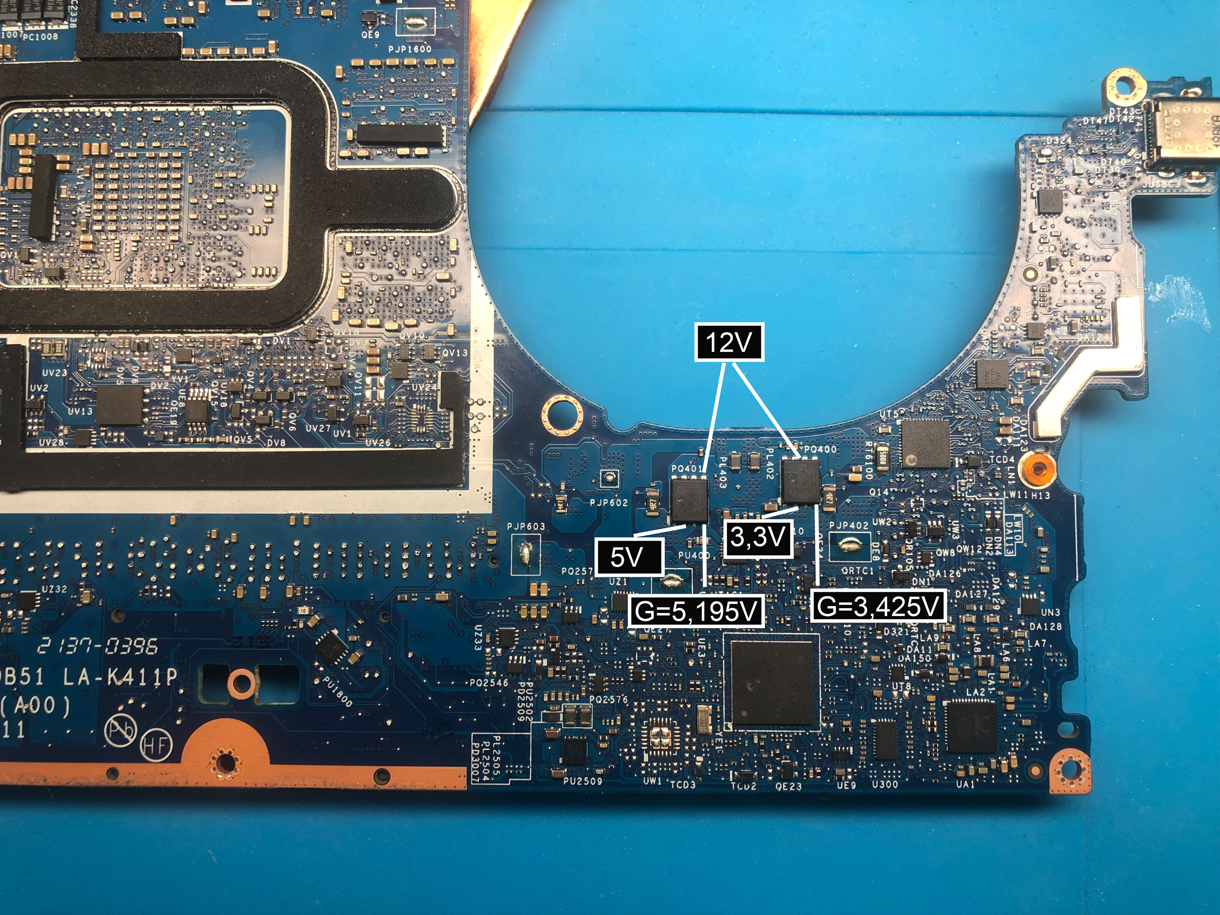

                      I continued to look for faults and measured the transistors for the 3.3V and 5V voltage. I also measured and listed the gate voltage. I measured whether the 256MB Winbond 25R256JVEN is connected to this 3.3V rail. It is not. Maybe someone needs it.

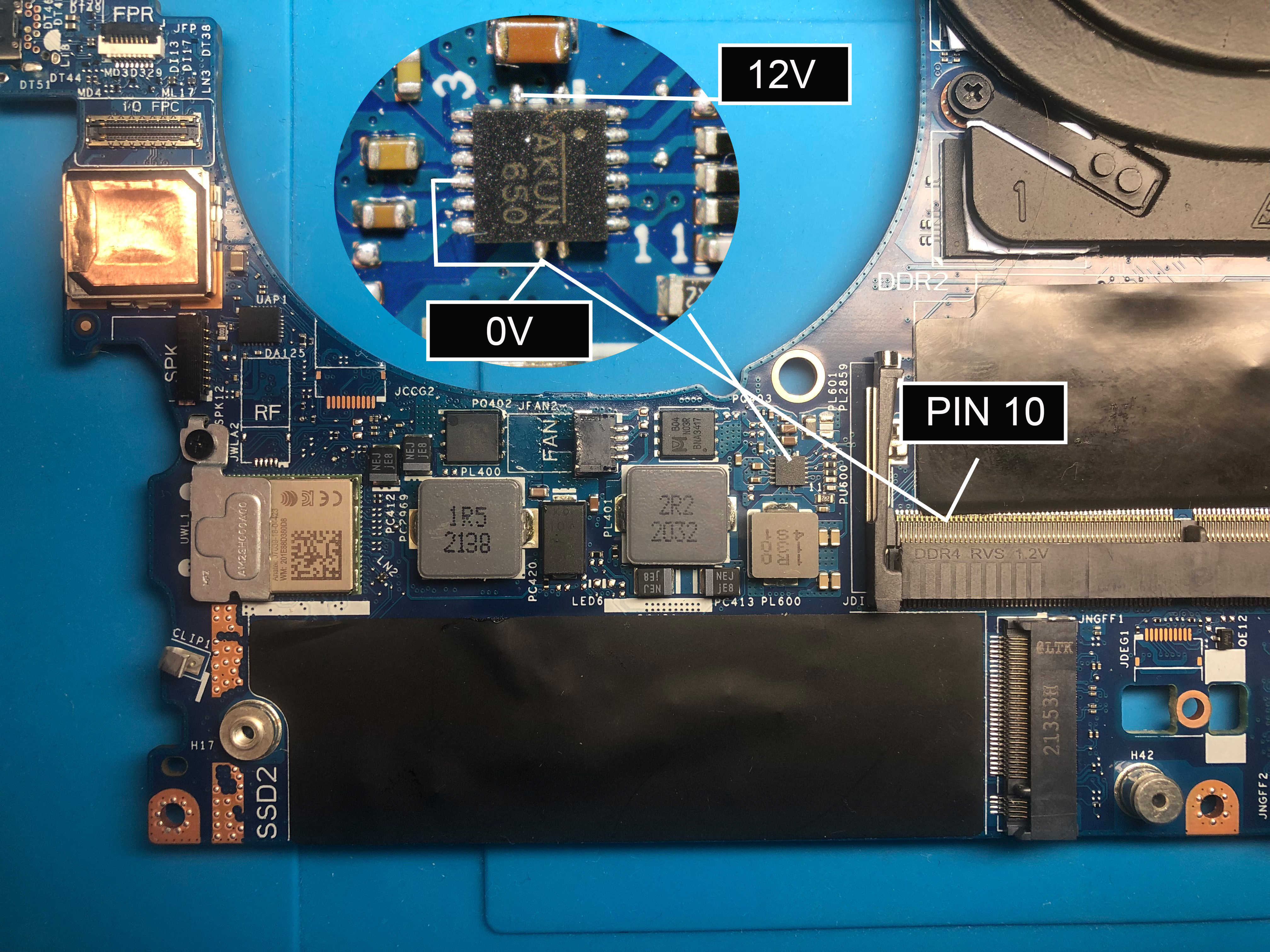

                        I have also measured that 12V is present at the AKUN 650 (see photo.Does anyone have a datasheet for this IC?). The output is switched through to PIN 10 of the RAM memory. I assume that this is the power supply for the RAMs. I would expect 1.5V at the output, but I could not measure any voltage there. It is possible that this is only switched on at startup. Does anyone know which PIN the power supply for the RAM should be connected to? Is it PIN 10 as I assume?
