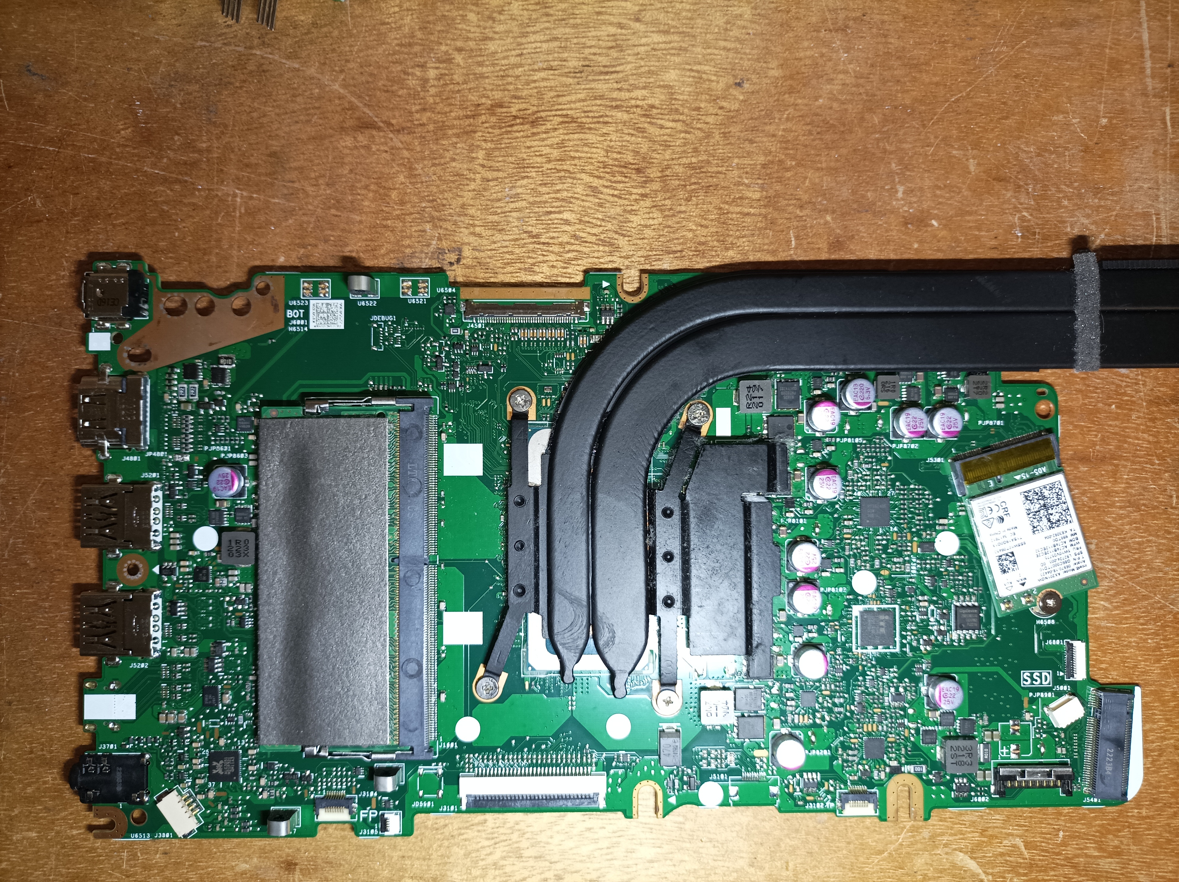

    I have an Asus X1403ZA board. Came in with no power or charge light. One screw of the hinges let loose and was dancing around inside the laptop.
    I have 19v coming in the first mosfet, but nothing on the source or gate. (also no voltages on other rails, no shorts on coils)
    The current resistor and source of the second mosfet are short to ground. I have looked for schematic or boardview, but nothing to be found.
    Anyone have tips where to start ?

      Review the topside markings of the DCin mosfets and also the nearby charger IC. Post each of these details for a review.
      Post pics of your logic board where you are noting the first mosfet to save on some time against the review of the boardview file.
      From the BV review,
      PU8901 BQ24800RUYR//TI is the charger IC.
      PQ8901 & PQ8902 DCin mosfets are the suspects. Carefully flux and remove the 2nd DCin mosfet.
      Check this removed mosfet after it is cool and on your work table. Likely it is defective.

        i have no 5v or 3v
        PQ8901 and PQ8902 are E180AJ
        PU8901 is BQ24800TI 258 A1J3
        I removed the second mosfet. From Source to drain I have 1.8Oms resistance, from Source to gate and drain to gate no continuity.
        After removing the second mosfet still 0v after 1st mosfet

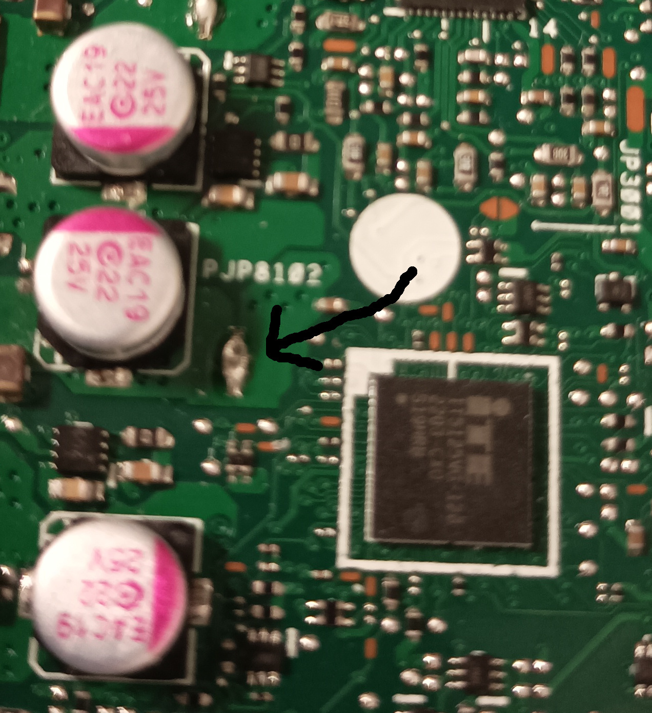

                                  the cpu and PCH don't warm up, not even a little bit.
                                  On inspecting all components in AC_BAT_SYS, I noticed PJP8102 looks like it is pressed down a little bit, maybo from that screw, I dont' know.
                                  Could it be possible this is short to ground from a trace underneath ?

                                        I injected 1V/5A for about 20 mins, the cpu feels a little bit warmer than the rest of the board. No other components feel warm.
                                        IPA on CPU vaporises very slow, but little faster compared to other areas.
                                        So this is probably end of story ?
