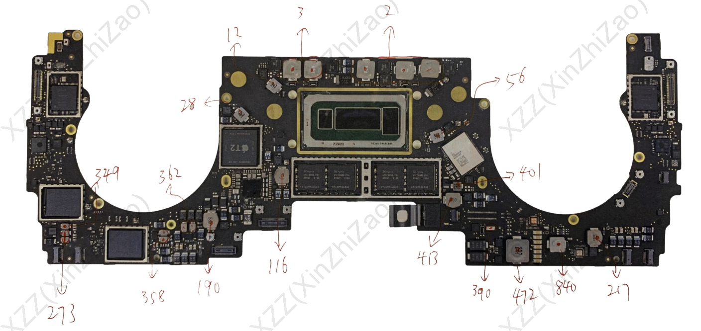

                Sharing a diode chart for the inductors on this board. Remove all power. Meter in diode mode. Red probe to ground. Black probe to the inductor to test.

                    Yes, the low voltage rails will tone beep due to the very low resistance to ground on the respective tested rails. What about the other inductors on the board? Do their diode mode readings match the posted reference diagram?
                    • rarinpear
                      • 9
                      • Italy
                      Here are all the measurements in diode mode (red on ground):
                      Inductor: Expected - Actual
                      L9021: 273 - 320
                      L9020: 273 - 320
                      L9030: 349 - 295
                      L9080: 358 - 310
                      L9081: 358 - 310
                      L6900: 362 - 316
                      L6901: 362 - 316
                      LB700: 190 - 407
                      L8102: 28 - 130
                      L7270: 12 - 35
                      L8100: 116 - 199
                      L7220: 3 - 9
                      L7210: 3 - 9
                      L7410: 2 - 9
                      L7420: 2 - 9
                      L7430: 2 - 9
                      L7702: 56 - 70
                      L7600: 401 - 334
                      L7660: 413 - 348
                      F7000: 390 - 332
                      L7030: 472 - 385
                      L8410: 840 - 806
                      L3500: 217 - 412
