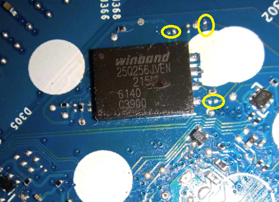

    hp elitebook 840 G8 dont come on
    i have this hp elitebook 840 G8 mb corvette 6050a3217501-mb-a01
    after flashing a bios ( u366) it does not comes on. when i press power button the lockscap key blinks 7 times. it does not take more than 4ma . i tried resouldering the bios . also i tried flashing another bios but nothing changed.
    if someone can help me with this. thank you

      i did all this, i even put replaced the bios chip.
      i think im missing 2 tiny resistors, but im not sure

        I have one working board and two other with fried CPUs, which place do you need measured/checked?
        • Hachem25
          • Aug 2021
          • 45
          • algeria
          the area around the bios chip on back of the cpu please. if you can take a close picture of the components near it . i think i knoked some resistores there. thank you

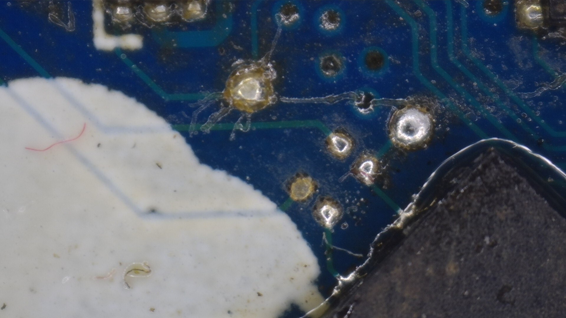

          • chocouy
            • Jan 2024
            • 12
            • Philippines
            hi can you measure these components that I am missing and maybe some others that I have missed. I have been looking for a schematic where I can cross reference this BIOS chip but couldn't find any online so the only hope now is to find a working board which is not possible for me as of now. would greatly appreciate it.
            this is the BIOS chip from the back near the EC chip.

              i have the same probleme here . i think im missing 2 components. Click image for larger version
Name:	pin 5 and 6.jpg
