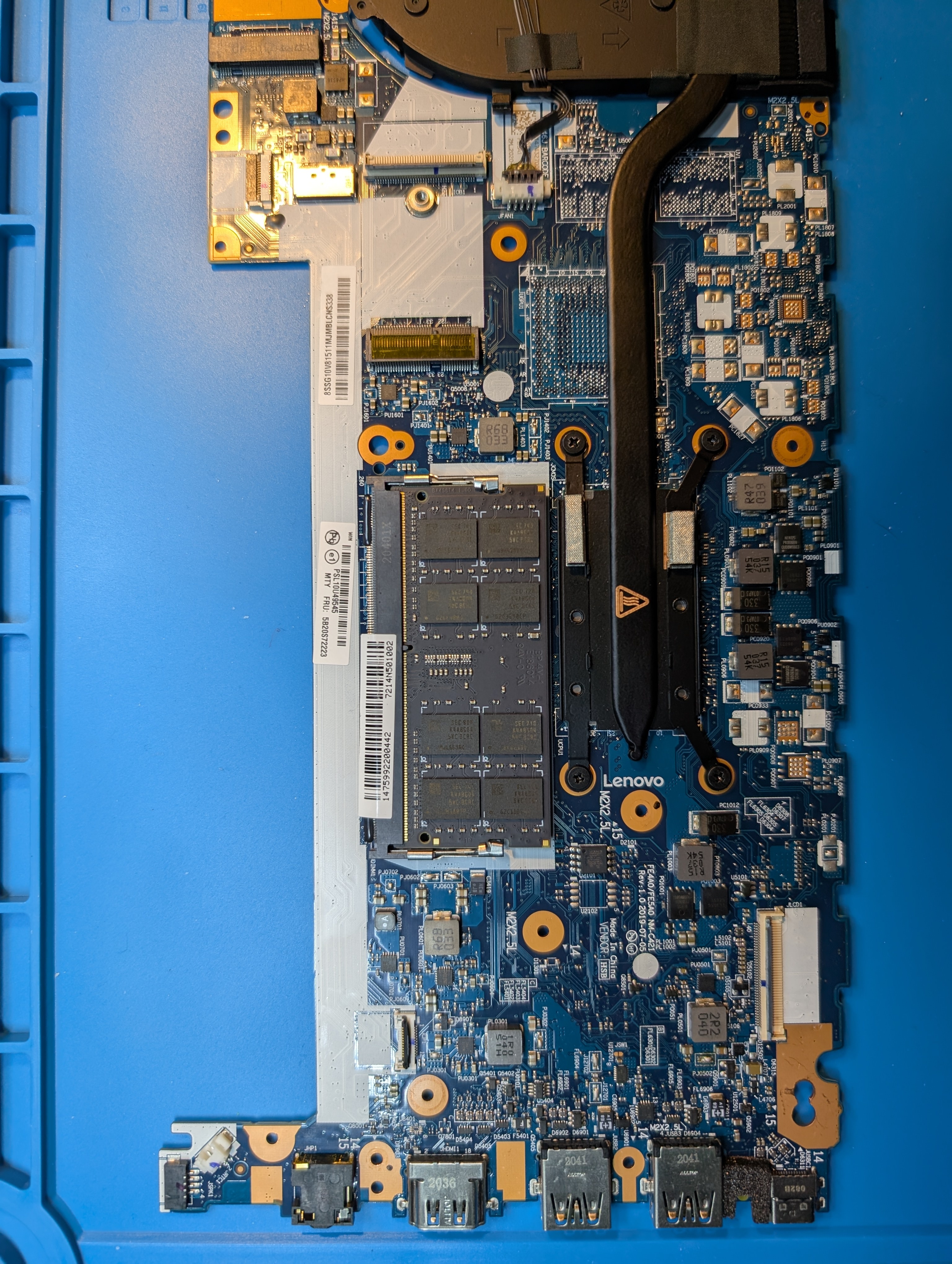

                    • Lifeisfun
                      • Apr 2025
                      • 47
                      #30
                      Got the DDR4 memory but sadly still no picture, it will consume 40mA before I press the power button, then it will settle on 500mA, CPU is warm and if I leave it on for long time the fan will kick in.
                      If I hold the power button it will reboot after 10 s or so, if I do that two times in the row it will turn off and not reboot.
                      What I noticed is I get no VCCGFXCORE_I voltage on the PL1003 coil, is this normal?
                      Any ideas welcomed.

                      • m1ch43lzm
                        • Mar 2019
                        • 919
                        • Peru
                        #31
                        https://www.badcaps.net/forum/troubl...rpose-of-vccgt
                        From post #2
                        I am missing VCCAXG/VCCGFX/VCCGT (iGPU core voltage), how do I solve it?
                        The iGPU core voltage is almost never relevant. It typically only comes up when there's a significant load on the iGPU. It can often be seen spiking a couple of times on the oscilloscope when POSTing.
                        In other words, it's generally normal that it's missing. If you have some kind of issue with the machine, the cause is most likely elsewhere.
                        Does the laptop react to caps lock key? Same with a basic, cheap USB wired mouse, it should light up the sensor (don't use a gaming mouse with RGB lights, it will mislead you)
                        If the caps lock LED turns on/off as you press it, then the issue is "No display"
                        Otherwise, is "No POST/no boot"
                        Do you still get the beep codes? If yes, you can check with "Lenovo PC Diagnostics" app for your phone
                        You can also build this simple USB port tester, the red LED blinks if there's activity (system is alive)
                        Click image for larger version  Name:	probador-puertos-usb-R-FZDA6s.jpg Views:	0 Size:	11.4 KB ID:	3634346
                        The resistors are 100 ohms (i saw several versions of the same circuit, with resistors from 100 ohms to 1k, whatever works), the red LED is connected to D+ through a 100 ohm resistor
                        Also wait for Sephir0th reply

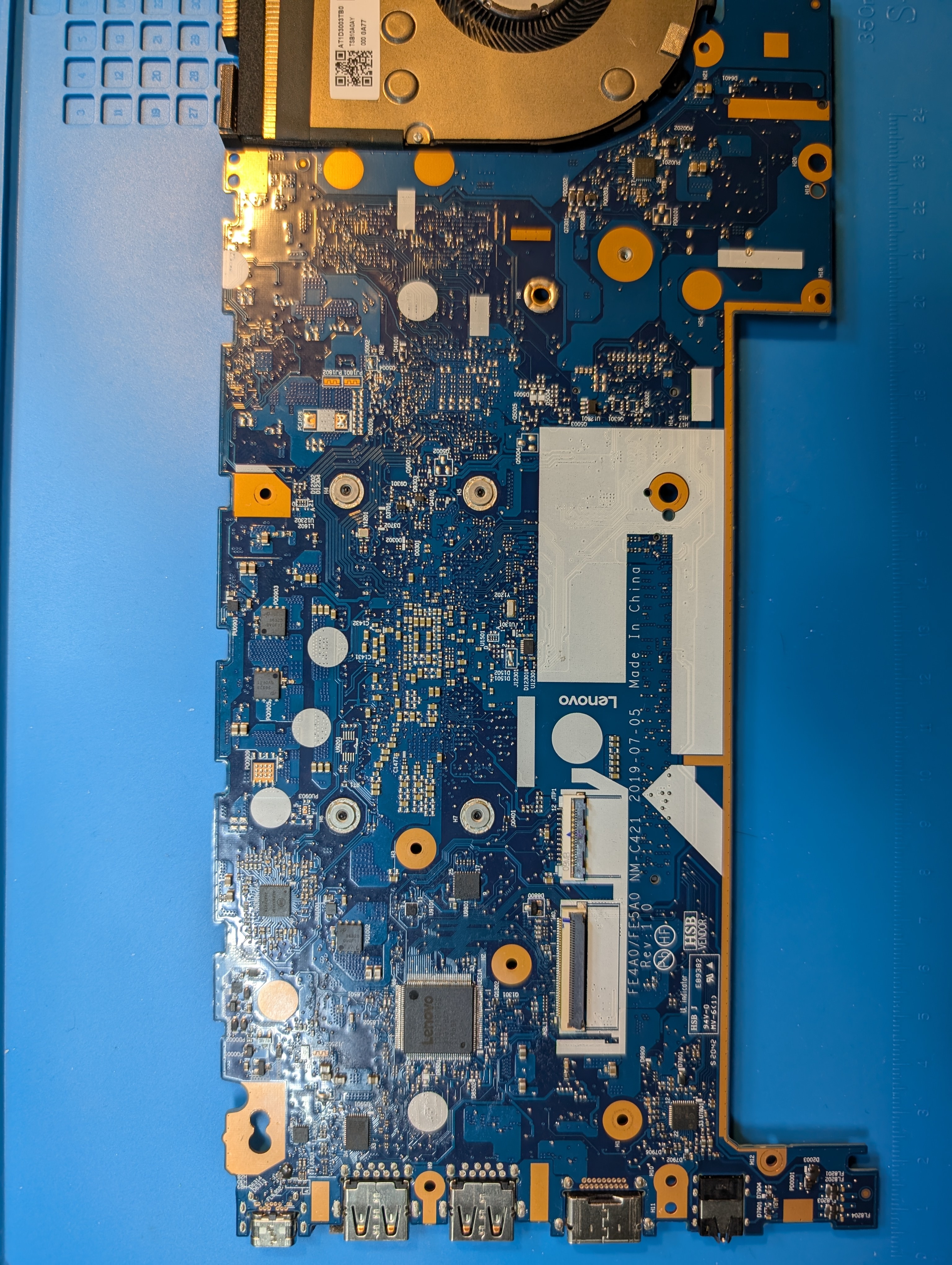

                          • Lifeisfun
                            • Apr 2025
                            • 47
                            #33
                            Originally posted by Sephir0th
                            Oh, you are right. Missed that it was already done.
                            Well, then it could be still a underlying problem, which more or less means that we have to start over with the diagnostics to fins the next problem. I would begin with a close look at pictures of how the EC was soldered...
                            Of course only when inserting the RAM doesn't change anything
                            I know it doesn't look pretty but I checked every single pin and they are all soldered.
                            Click image for larger version  Name:	PXL_20250511_081336244.jpg Views:	0 Size:	3.93 MB ID:	3634471 Click image for larger version  Name:	PXL_20250511_081841191.jpg Views:	0 Size:	3.56 MB ID:	3634472 Click image for larger version  Name:	PXL_20250511_081857938.jpg Views:	0 Size:	3.69 MB ID:	3634473

                              • Lifeisfun
                                • Apr 2025
                                • 47
                                #35
                                Just some additional info on what I tested so far:
                                I did check the EC chip soldering pin by pin and they are all connected
                                I checked all coils and looks like all voltages are present except the VCCGFXCORE_I voltage I asked above.
                                Since there is no response from the keyboard I checked for power on the connector and there is 3.3V present.
                                When I power it on (without battery and cmos batt connected)
                                The power button (on its own) blinks 2 times then it turns on, fan turns on for couple seconds and turns off again.
                                It takes 20V and power meter shows after while about 450mA
                                It will sit like this long time without any change (nothing is hot, only some components warm to touch like the CPU and some coils)
                                If I press the power button nothing happens
                                IHold it it will blink twice again and reboot to the same state. (no change from above)
                                When I attempt to reboot it for the 2nd time holding the power button it will turn OFF and the power meter shows consumption about 42mA
                                After this the power button no longer responds. (also tried keyboard but nothing)
                                To reboot again I have to unplug the USB-C and plug it in again.
                                Mouse connected to USB port blinks couple times and after the amperage settles down it stays lit.
                                Any ideas would be welcomed!
                                Thank you!
