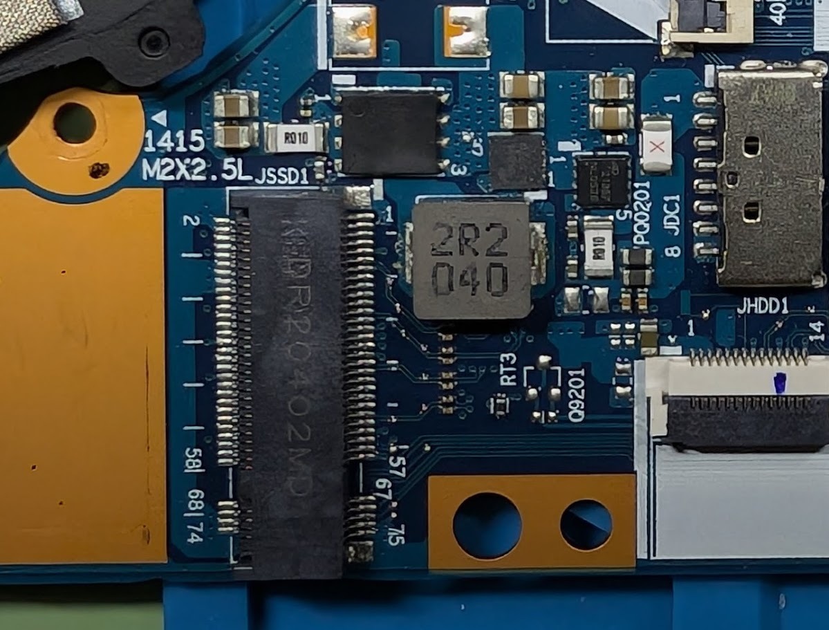

                Sorry, that was oversight on my part ( assumed and I was wrong)
                It is actually very strange, since even the board view doesn't ID that coil or the larger mosfet to the left above it.
                Click image for larger version  Name:	image.png Views:	0 Size:	94.2 KB ID:	3636748 Click image for larger version  Name:	coil2.jpg Views:	0 Size:	314.0 KB ID:	3636751
                The PL0201 is not present and the jumper is in place (jumper is 49K to ground) Yes there is 20V on that jumper and 20V on pin 1 of the BQ chip.
                Click image for larger version  Name:	coil1.jpg Views:	0 Size:	304.3 KB ID:	3636749
                PL0202 (I assume since is not marked anywhere) is the one getting hot when battery is connected and warm without battery. (1K to ground on that coil)
                The BQ chip is slightly above it on the other side of the board (BQ chip is definitely hot 50C or so)
                Click image for larger version  Name:	coil.jpg Views:	0 Size:	237.8 KB ID:	3636750
                Once again sorry for the wrong info before.
                Thanks!

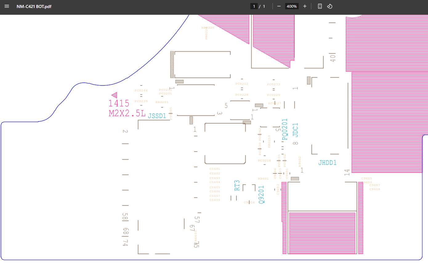

                  #48
                  Get the board view from post #19 https://www.badcaps.net/forum/troubl...16#post3231416
                  You can open it with flexbv free
                  https://www.badcaps.net/forum/troubl...acos-and-linux
                  That will help identify those components
                  Anyway, from the resistance measurements, likely PU0201 is faulty (BQ25700A), according to schematics there shouldn't be a way to get 1k resistance to GND at PL0202 unless either PQ0204 and/or PQ0205 are faulty, or the BQ itself is faulty
                  Now remove the BQ and check resistance to GND at PL0202, you should get OL
                  Don't apply power to the board unless you replace the BQ
                  The charge circuit while in operation shouldn't get hot at all, at most around 30-35 deg C, I checked on my laptop (HP), while the charger IC is an ISL the topology is similar NVDC, i couldn't feel anything hot with my fingers while charging the battery (I don't have a thermal camera)

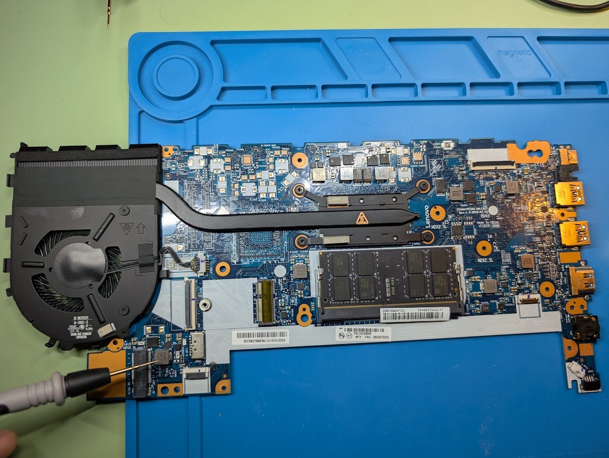

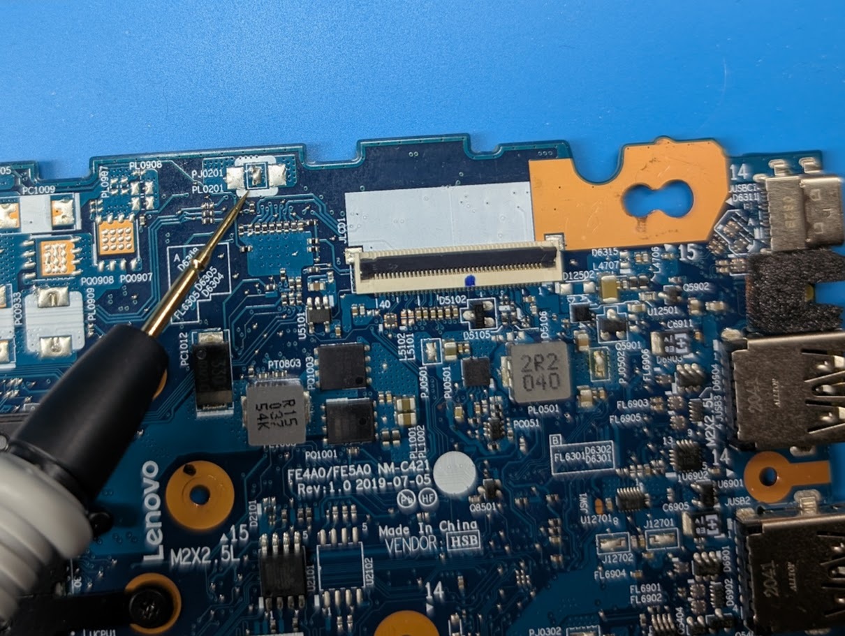

                            Just tried again and it will not power on with only battery connected, I have to have the USB-C power connected (it ramps up on connecting power to 20V and about 0.48A)

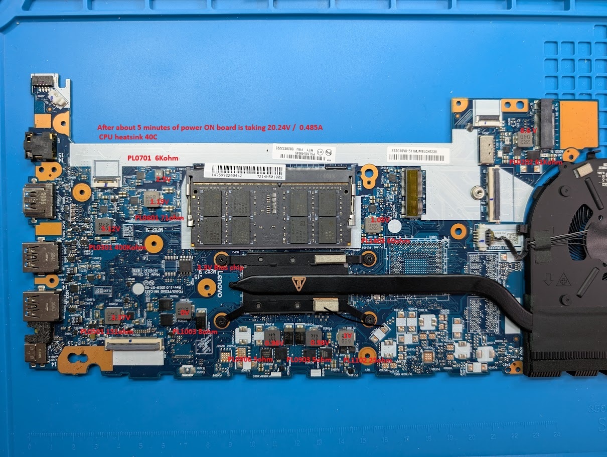

                            Tested again and now with battery connected the PL0202 coil has 9V with battery connected or disconnected.
                            CPU is warm
                            Only power button response is holding it for 10 seconds or so, on first attempt it will reboot and doing it second time it wit shut off but the board is still taking about 40mA.
                            I will start all over again.
                            Is there any risk to have it powered on for long time when measuring? Also should I measure with or without battery connected?
                            Board resistance and voltages
                            PL0701 2.5V 6Kohm
                            PL0601 1.19V 71ohm
                            PL0301 5.12V 400Kohm
                            PL0501 3.37V 151ohm
                            PL1003 0V 8ohm
                            PL0906/0903 0.96V 5.5ohm
                            PL1102 1V 25ohm
                            PL1403 1.05V 60ohm
                            PL0202 8.6V 61Kohm
                            Click image for larger version  Name:	Board coil resist.jpg Views:	0 Size:	402.9 KB ID:	3641665
                            • Sephir0th
                              • Oct 2020
                              • 1289
                              #54
                              So it is most likely like assumed. A additional issue in the charging circuit. Battery could be simply locked in worst case.
                              But also 151 Ohms at the 3VALW, which is per 99% a partial short circuit of this rail. Something is faulty on this rail and we need to find out what it is. A almost impossible job without a thermal camera available.

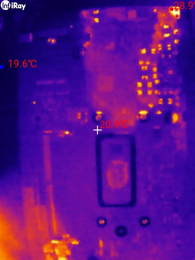

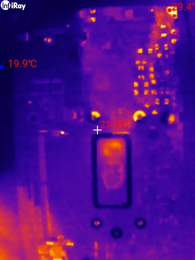

                                  The only hot thing glowing is the BQ chip at 59C all other smaller chips are under 30C, and the EC chip has no longer hot spot on it but it's evenly distributed 28C.
                                  The replacement BQ chip should be here any day, I'll try to swap it to see if it will run cool.
                                  Once again thanks for your time and knowledge!
                                    I did unsolder the PJ0502 jumper to separate the rail from the power supply, and yes the partial short is there.
                                    What would be safe voltage and amperage to inject to find the problematic component?
                                    This rail feeds lots of stuff incl. the PCH, I just hope the PCH is not partially shorted, that would be the end
                                      This is what I would fear the most too...
                                      The track will with 150 Ohms not draw much current anyway. So no need to set it up higher than 1 Ampere. Regarding the voltage you probably need to move directly to 3 Volts. Less would most likely don't reveal anything. More will harm what is still healthy on this rail.
                                        Thank you!
                                        Will give it a shot today and report back
                                          Here are the results, I'm afraid it ain't good unless I see it wrong.
                                          @3V the rail takes 120mA, and the only thing that I see slightly glowing is the PCH (pics before and after injecting voltage)
                                          Makes me wonder what caused the damage, the EC chip was bad for sure since it was shoring the LDO 3V rail but why did it take out the PCH as well is beyond me.
