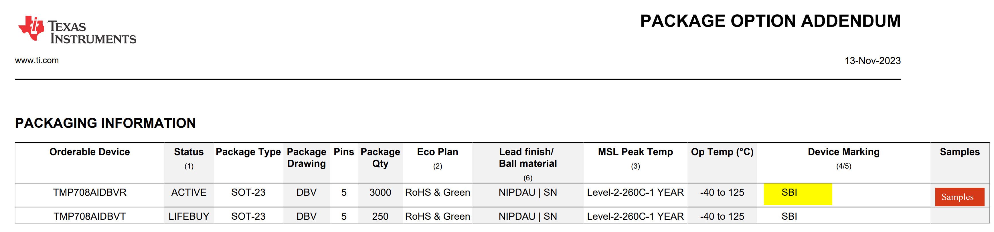

Board is Razer RZ09-02385, pin 4 and 5 is 5V pin 3 is ground. Please help identify this component
Razer RZ09-02385 ,Help identify IC

Thanks SMDFlea. Your hint gave the boost needed to hunt this one down like a dog.
TI P/N TMP708AIDBVR
Datasheet:
TMP708 | Buy TI Parts | TI.com
Free samples available from the TI.COM website. SMD Markings = 'SBI'.
reference:
The original factory supplies TMP708AIDBVR temperature switch chip silk screen SBI new original genuine products in stock (1688.com)

I don`t know the exact part number,but with the mark on the left and the overline and underline i`d say its made by TI texas InstrumentsComment
