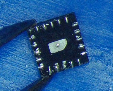

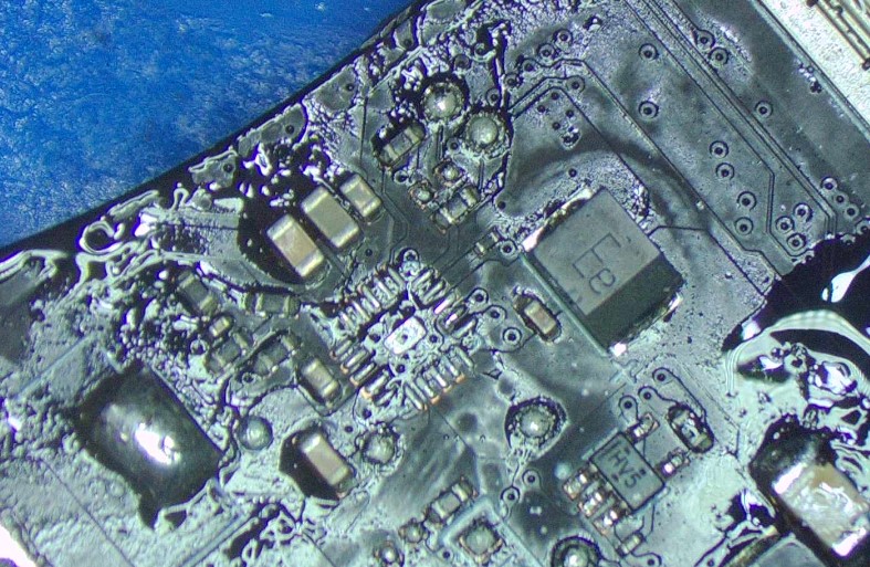

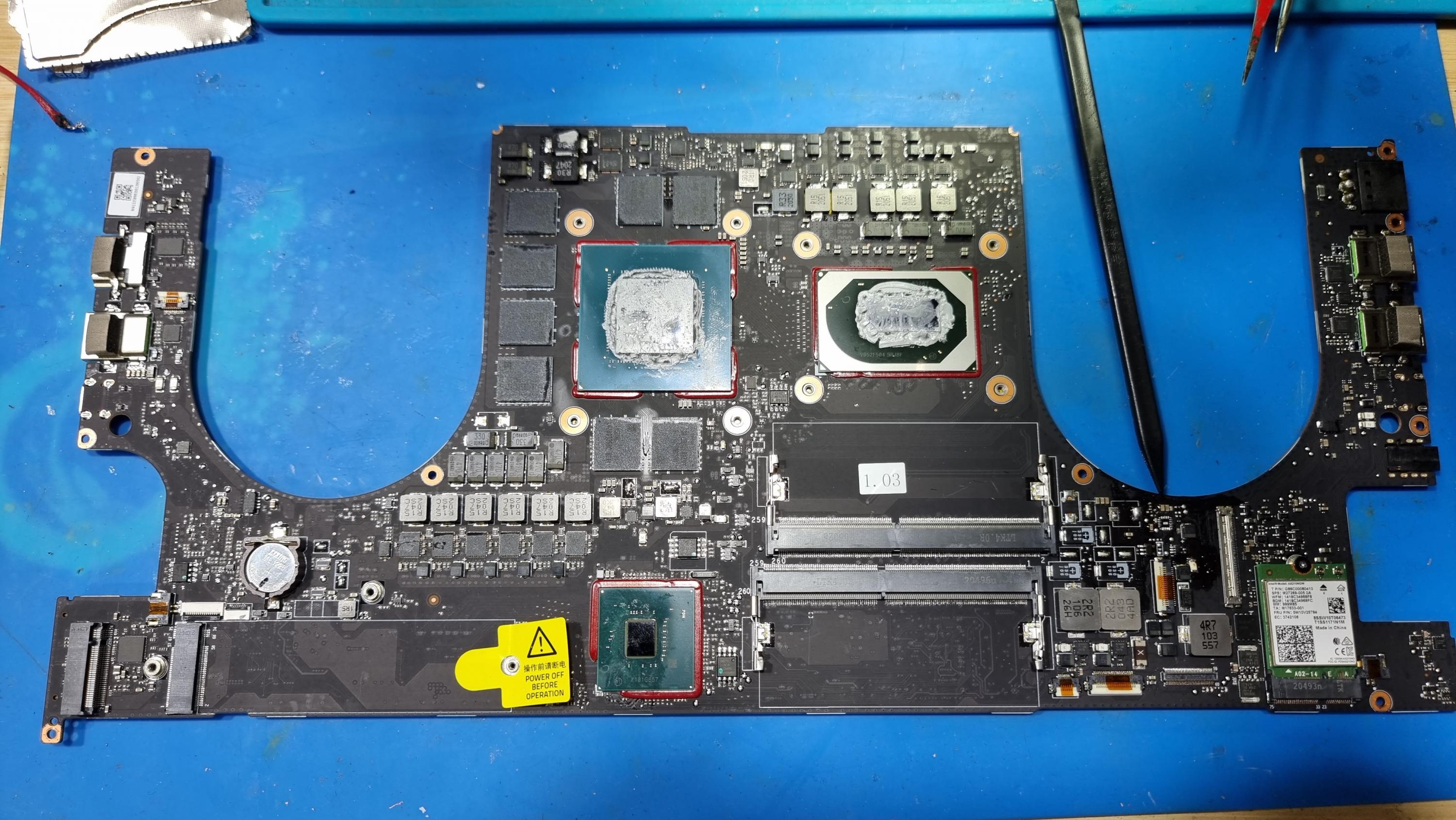

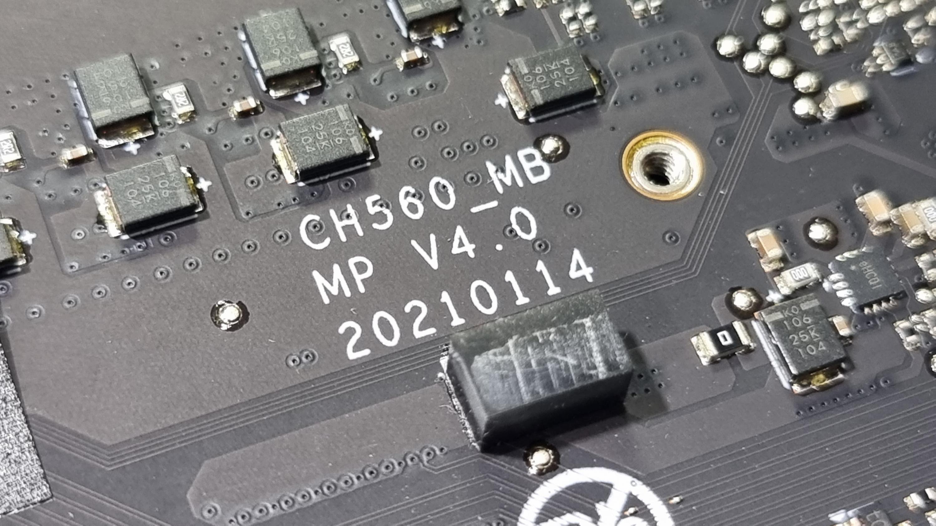

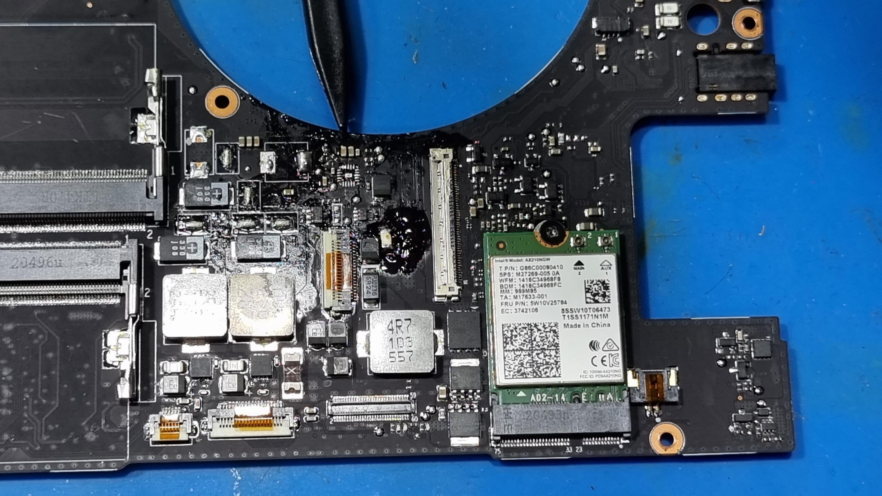

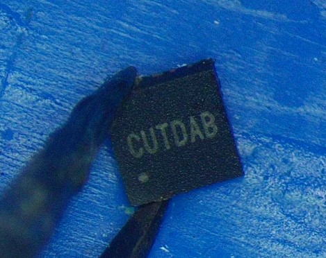

    Hi team,
    Laptop model: rz09-0367bed3
    Motherboard model: CH560-MB MV V4.0
    Chip label: CUTDAB QFN type.
    • 21960

    It could be a silergy SY8310DRAC not 100% sure at the moment.

      Re: Help identify chip CUTDAB QFN IC Razer
      You've got it. Thank you Sir!
      SY8310DRA SY8310DR SY8310D CUTxxx
