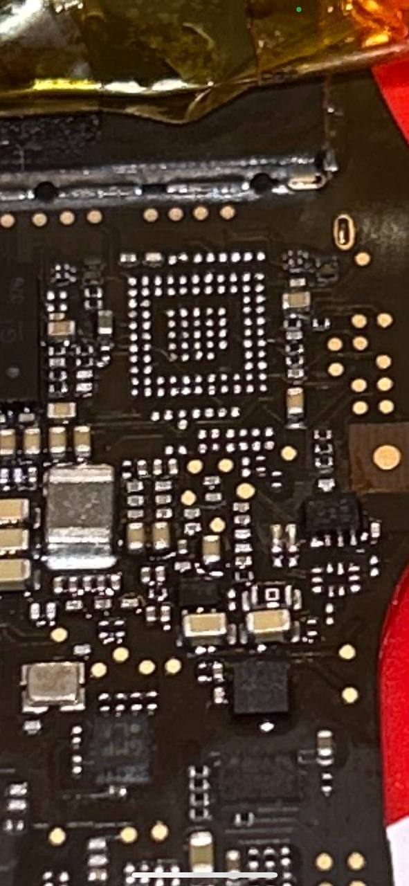

    Hi everyone, this is my first time trying to repair my 15" MBP 2018 A1990. I've been watching logic board repair videos for a long time so I wanted to experiment with reviving my own MBP, board number 820-01814.
    This is all the information I gathered so far:
    - All USB-C ports are dead with 5V 0A, none of them loops

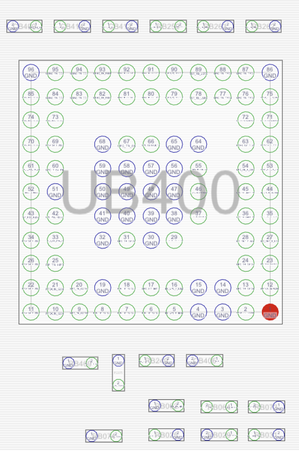

    - Weird fact: when charger is connected to the port corresponding to UB400 and I try to measure the volts at CB401, the charger is restarted. It happens only with that port and UB400. CB401 is not shorted. I don't know enough to explain this.
    - PPBUS_G3H measured 0V and shorted when measuring continuity to ground at F7000. F7000 and F7001 fuses are okay though.
    - PP3V3_G3H_RTC 0V, however C3100 not shorted. Measured around 440Ω when measuring for continuity
    - PP3V3_G3H_RTC_X also 0V
    Today I got a simple PSU from Amazon so I tried injecting 1V 4A into the board from F7000 using the probs. Volts dropped to 0.7V so around 3W as output. I don't have a termal camera, so I used a infrared thermometer with laser pointer. Found a hotter area around C7605. Used isopropyl alcohol around that area then. It was clearly visible that C7605 was getting hotter faster then the rest of the area, even hotter than C7607 next to it. However, when measuring for continuity, both C7605 and C7607 seemed okay, i.e. no continuity and resistance around 440Ω. So they're not shorted right?
    I thought it might something else on the opposite side. PPBUS_HS_3v3GH_T is definitely shorted on that side. C7680,C7660,C7661,C7662 all shorted to ground. But they don't seem to get particularly hot (isopropyl not evaporating faster) as C7605 does.
    What should I do next?

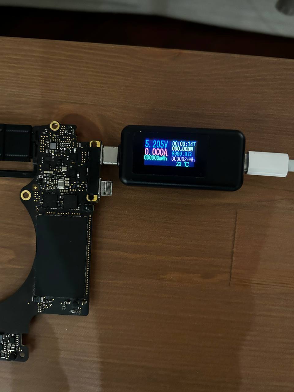

    post the exact current draw on your type C meter. There must be some current draw in the mA range?
    post a pic of your meter used to confirm it is a bidirectional type.

      - Current draw is exactly 0A. Will attach photo.
      This is the meter I'm using: https://www.amazon.it/dp/B00TM0W8ZY

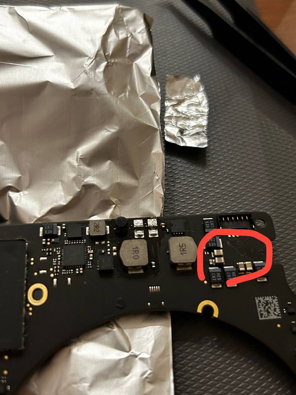

                    Most common fault I see on A1990 are the caps getting corroded and shorting near the fan intakes. Or the SSD regulator going short and pumping 12V into the SSD's. First thing I do is check resistance to ground on L9080/9081, then check caps at the edges. Have seen bad trackpads too cause low impedance on PPBUS.
                    Check C9081, C9087 etc as these are the most common.
                    MAC boards have large ground planes so will suck up a lot of heat especially in the middle of the board. Using too small a nozzle is often a cause of inadequate heat delivery. You should be using 5mm at least and 400 is way too low on a board like this.

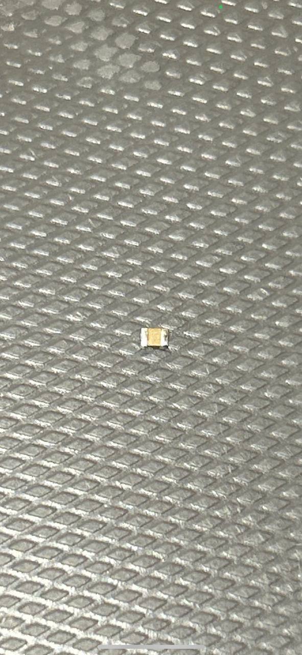

                          Thanks to all of you for the tips. I was able to find the shorted cap indeed!
                          Using a 9mm nozzle, max air pressure + some flux was very effective to desolder any component other than those two fuses at the center of the board. But actually keeping them soldered was useful as I injected 1V and 3-5A and tried to find where it was hot. It was very difficult and I had to take some wrong attempts, but eventually I was able to notice a barely noticeable warmer temperature around C6503 near the right audio J6500. It was also indeed in the area where I initially noticed a warmer capacitor C7605 as stated in my first post! I wasn't really able to tell exactly which one was shorted despite the usage of alcool, so I desoldered at once the several capacitors in the area and one of them was shorted indeed! It's one of those with 22UF and 0805-1 as spec.
                          Re-testing F7000 and F7001 proves that PPBUS_G3H isn't shorted anymore.
                          Now I need to buy a replacement cap. I think I'll buy several copies of each that I desoldered, they basically have similar specs like 22UF. I just have to find where I can buy them online in Italy/EUrope. Then I hope I'll be able to solder back the poor UB400/CD3215 that I thought was shorted.
                          Thank you again for the support, I'll keep you updated if I'll be able make the MBP live another day!

                          Quick question: how do I choose which cap to pick as far as they seem all to have the specs specified by Apple?
                          E.g. https://www.mouser.it/c/passive-comp...%20dc=25%20VDC
                          The spec on the board schematics is 22UF 20% 25V X5R-CERM 0805-1.
                          • mon2
                            • Dec 2019
                            • 14657
                            Good. It is a bulk capacitor and there are others on the same power rail. Therefore this removed defective capacitor will not be missed.

                              I'll buy a donor board then as suggested. My biggest worry now is how to get the CD3215 IC back to the board. I need to either trust buying it online, already reballed, or learn to reball it myself right?

                                  Small update. I followed the tip and bought a cheap A1989 donor board (2018/2019 MBP 13") and got the donor caps. Now the board is taking 5.2V and 0.27/0.25A, so not completely dead anymore. It doesn't work yet because I have not yet restored the CD3215 chip.
                                  But meanwhile I've tested that PPBUS_G3H now has 12.26V, not 12.6V, which is expected since one UB400/CD3215 is missing and thus T2 is not booting (AFAIK). I've also checked that PP3V3_G3H_RTC_X has 3.35V measured both in CB300 and CB400. So all seems good.
                                  The remaining issue seems indeed to be the UB400 chip. Other than putting it back to its place, I've unfortunately knocked off some parts next to it during the removal. Now I'm more careful and I use some kapton tape to keep the surrouding in place and limit heat exposure, but the damage is done and I had to remove all the displaced parts. So my question is: do I have to put all of them back? Looks a annoying work due to their size. They are not marked as critical in the schematic but they seem to belong to the PP3V3_TBT_T_SX line, which is input of the UB000 thunderbolt controller. I'll attach some image.
                                  The CD3215A is very simple, it is not a processor and temperatures at 420C will not damage it
                                  That's good news, thanks for the info.
                                  EDIT: with lots of patience, I've resoldered the tiny resistors and caps back the to board.
