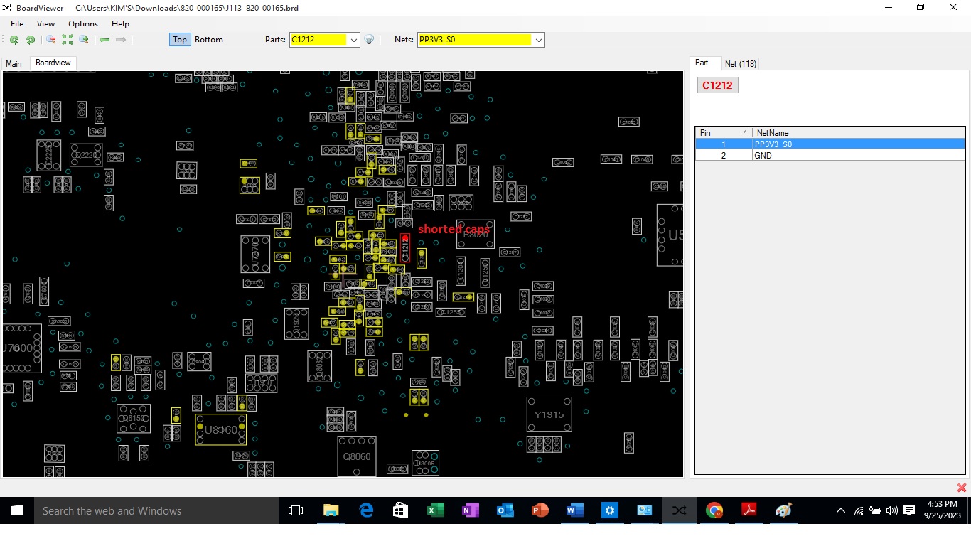

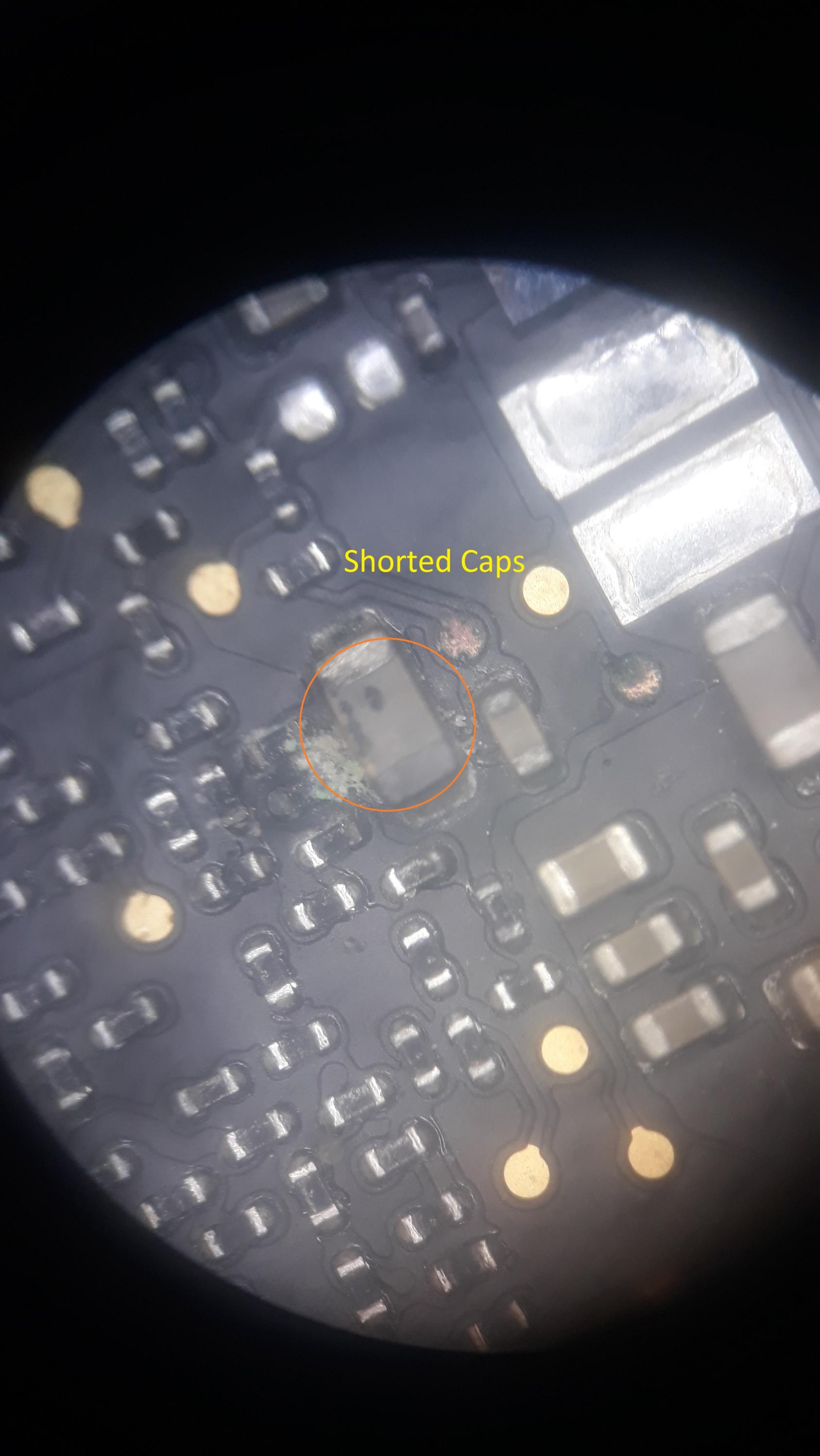

    1. Problem of macbook is No Display
    2. Found shorted caps on c1212
    3. After removing the shorted caps (c1212) the reading in the c1212 pin1 is .003 in diode mode test, still shorted.
    4. Help me..

    Re: MacBook Air A1466 EMC2925 (820-00165-A) Shorted PP3V3_S0
    Pour alcohol in this same area and clean it up with a cotton swap / Q-tip. Appears to be some sugar crystals on the parts.
    The shorted rail travels all over the logic board so the fault could be anywhere.
    If you have an adjustable power supply -> dial it up to 1 volt (not higher) and inject it onto this rail. No other power sources.
    Then check the current draw which should peak and hunt for which part(s) heat up.
