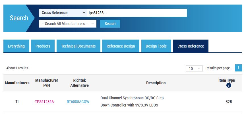

                        #271
                        Re: List of pin compatible Laptop ICs
                        It's used in conjunction with bq24780s on asus motherboard as upgrade of
                        tps1285a , someone can confirm this cross reference ?
                          • 22168
                          #272

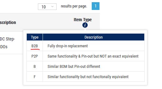

                          Are you asking for a compatible part for the tps1285a or asking if its compatible with the TPS51275B / rt6575dgqw ?
                          The richtek cross reference says the RT6585A is compatible with the tps51285a .It says B2B meaning its a Fully drop-in replacement. Check both datasheets though to make sure
                          https://www.richtek.com/Design%20Sup...ss%20Reference
                          RT6585A marking code 3J=
                          https://cdn.badcaps-static.com/pdfs/...ae9d171f8c.pdf

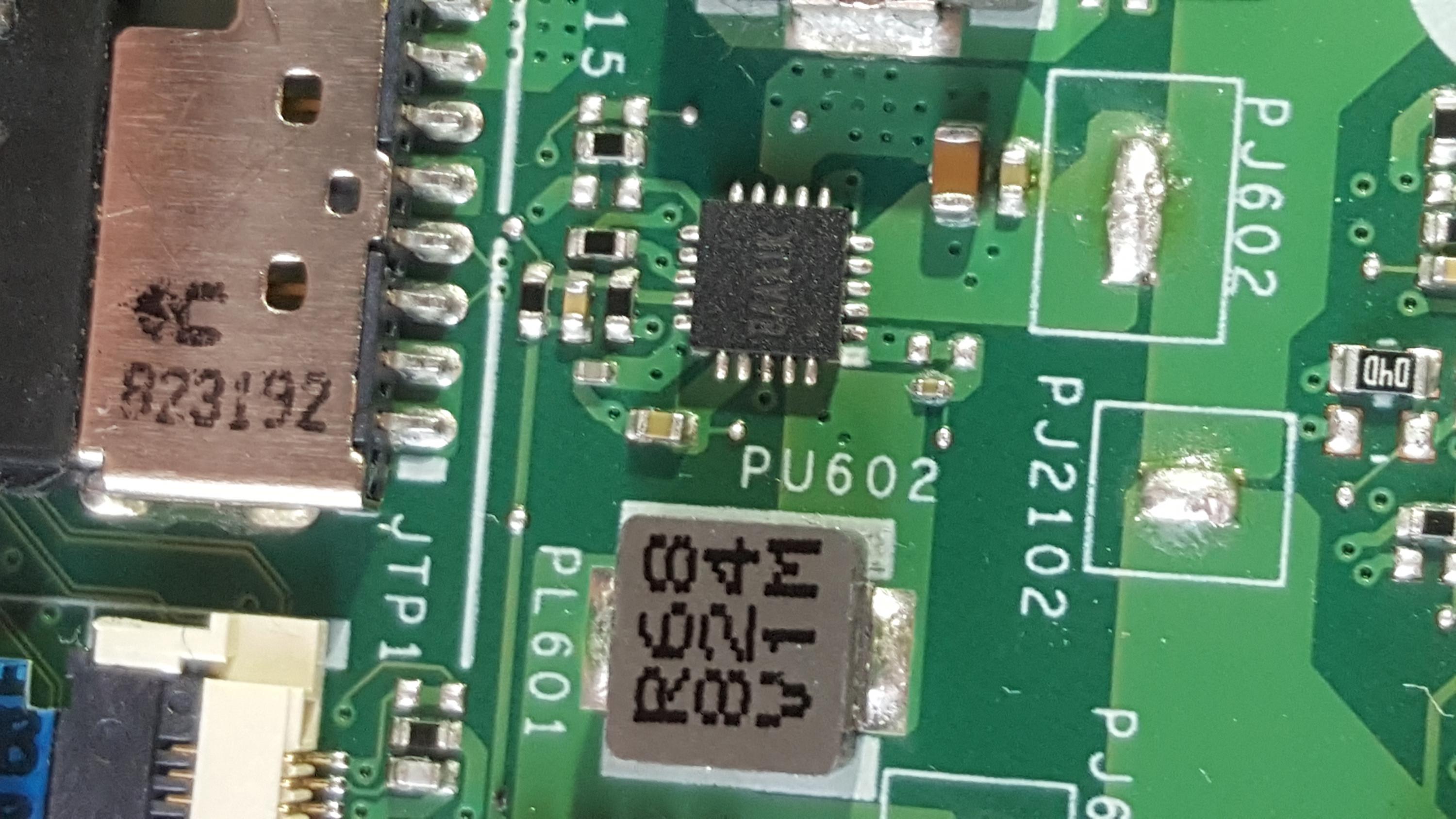

                                Hello
                                Any help for replacement for BAAAIK Its near the Battery port on Lenovo V130-14ikb Mainboard LA-F486p Rev 1.0 or if anyone has Schematics for it.
                                Thanks B.R.

                                  #276
                                  Sorry for LQ Picture
                                    • 22168
                                    #277
                                    Originally posted by elvirpa800
                                    Hello
                                    Thanks B.R.
                                    Schematic - https://www.badcaps.net/forum/showthread.php?p=1060162
                                    https://www.badcaps.net/forum/showpo...1&postcount=12
                                    BAA*** SY8286RAC
                                    No cross compatible part afaik .

                                      #278
                                      Thank you very Mouch bro,you saved me ...
