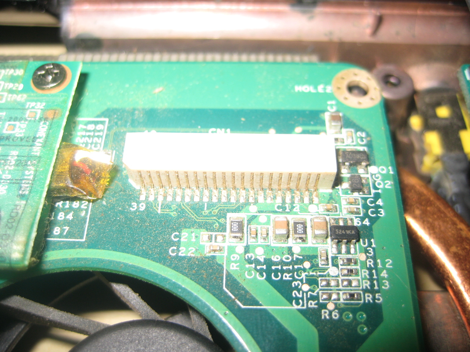

    Hi guys,
    I messed up LVDS connection on this laptop, hope you can help me out..
    It all happened when i was replacing the LVDS cable, and the replacement was shorted without my knowledge.. a spark came out, and when i replaced back the old cable it wasn't working anymore.. I have neither image or backlight.
    I thought it might be a broken fuse like in other laptops, but i've searched around and didn't find any fuse.. Do you guys know what i should check?
    Thanks.

    perhaps pictures of the area around the connector would help and of
    the inverter board in the screen and perhaps the board if there is one on the
    back of the panel.
    Have you tried with an external monitor?
    If the cable is damaged and in place there doesnt seem much point in trying to fix the laptop as it will just blow again. Have you tried continuity testing each wire in the cable and also for shorts between the pins.

      Yeah, forgot to mention, VGA output is working fine.
      Not sure how pics would help, but the schematics might..

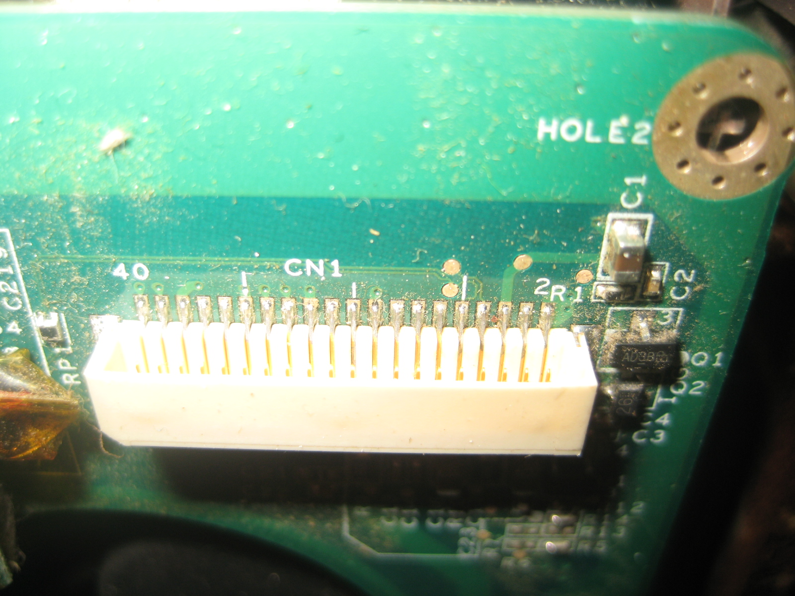

        Here's some pics.
        Thanks.

          I am not good on schematics but better at pictures. I was looking for components that might blow like a fuse.
          Perhaps test the zero rated resistors for continuity - ones with 000 on.

            Re: messed up LVDS on a acer 5920
            These resistors have continuity. I also checked connector for 3 and 5V, and it's present.
                  It's not the inverter cuz i was using a different inverter/screen/cable when it happened..
                  18V in R9, and 3V present in pins 3&5.
