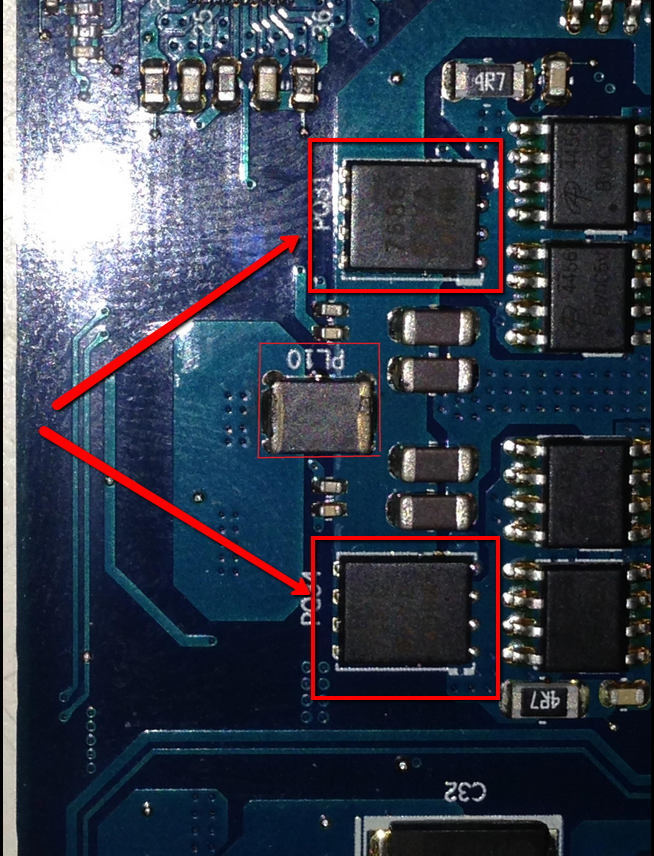

        I am looking to doing the reball myself, Does anyone have any good heating profiles for this kind of chip?
          Re: Gateway Nv3717u not posting
          So does anyone know of an easy way to remove and resolder smt parts?

            hi, have you check the N-channel MOSFET, i have simmilar case and the MOSFET were bad (shorted)
              What is the best way for someone who has never done it to check and see if they are shorted
                Unsolder the MOSFET from the board. First check to see did you have short base - collector - emiter. You can search youtube for tutorial.
                  Do you have a recommended way to desolder it easily?

                    I use hot air, i thik this is the best way.
                      Take a look at these videos - http://tinyurl.com/n6mcbph

                        Anyone have a tip for getting the old solder on the motherboard to melt? It seems to not want to melt when the iron is applied

                          Some people add a little more lead on those points allowing melted lead to combine on old lead. Do both on other sides. I used 60 watts soldering iron and a flux. But then hot air does the work fast.
