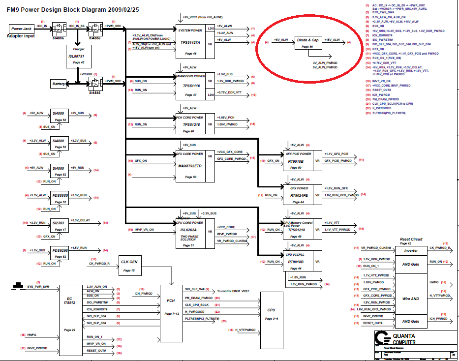

    have a studio 1558 (FM9B MAINBOARD )
    no power but does charge battery ,anyone have any suggestions or better still a schematic (must be fm9b not fm9)

    power adapter or power jack. Dells like yours use two power rails, one to charge, one to run

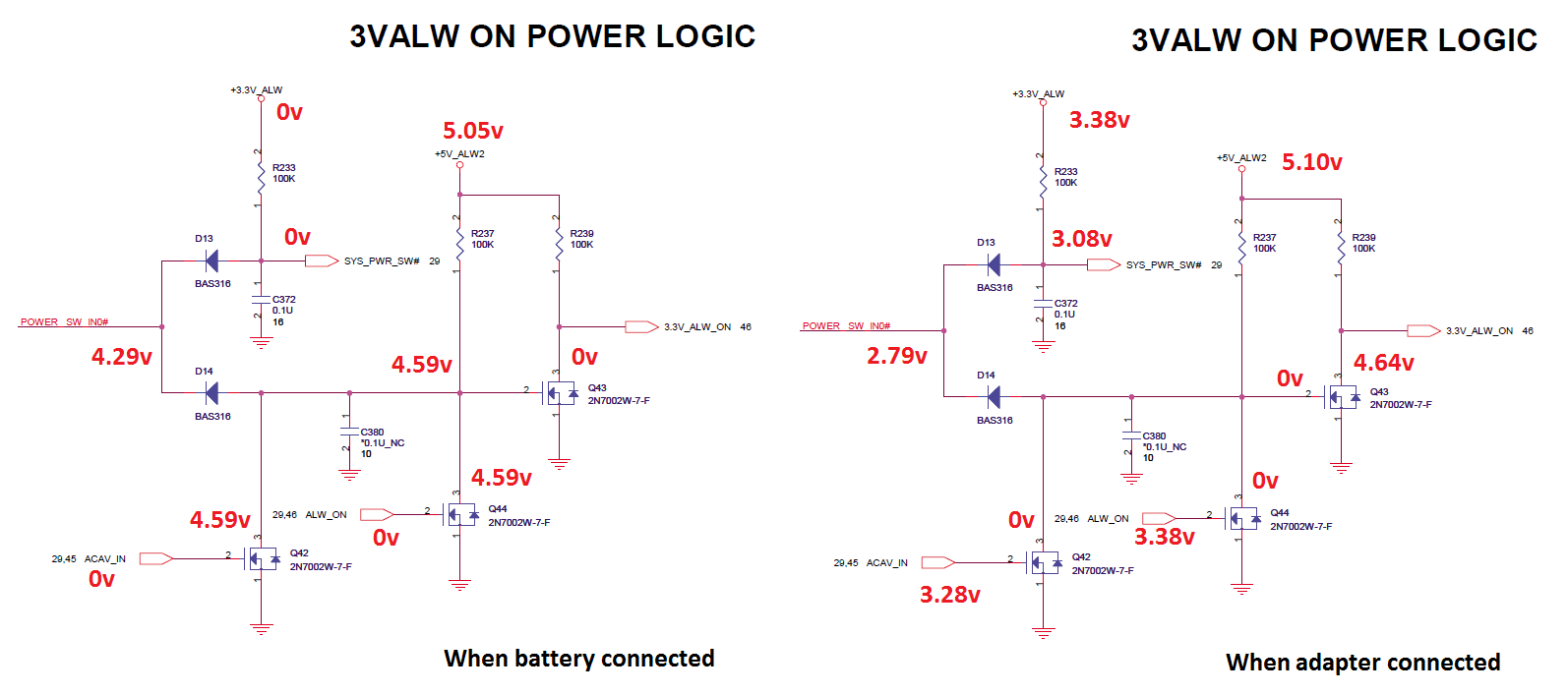

        My laptop have similar problem but on battery there is no 3.3v and 5v alw could you please share your experience if you have fixed this problem.

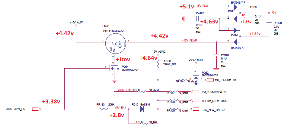

            I have tested miniature tact switch and the cable. they are good and shows continuity. When I press the power button led on the button blinks for 1/2 second then nothing happens. The Charger is working properly and charging the battery. On battery connector 12 volts are present and the charging jack led turns on. I request you to kindly read the complete problem as I have posted it here https://www.badcaps.net/forum/showpo...3&postcount=13

              The power switch have 2.7v instead of 3.3v.

                Motherboard have +3v_alw and +5v_alw when connected to AC Adapter but +15w_alw is absent i am unable to understand why? I have checked several components but i am unable to locate the faulty one. please help.
