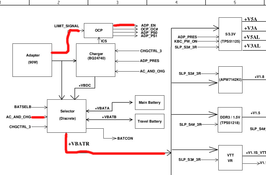

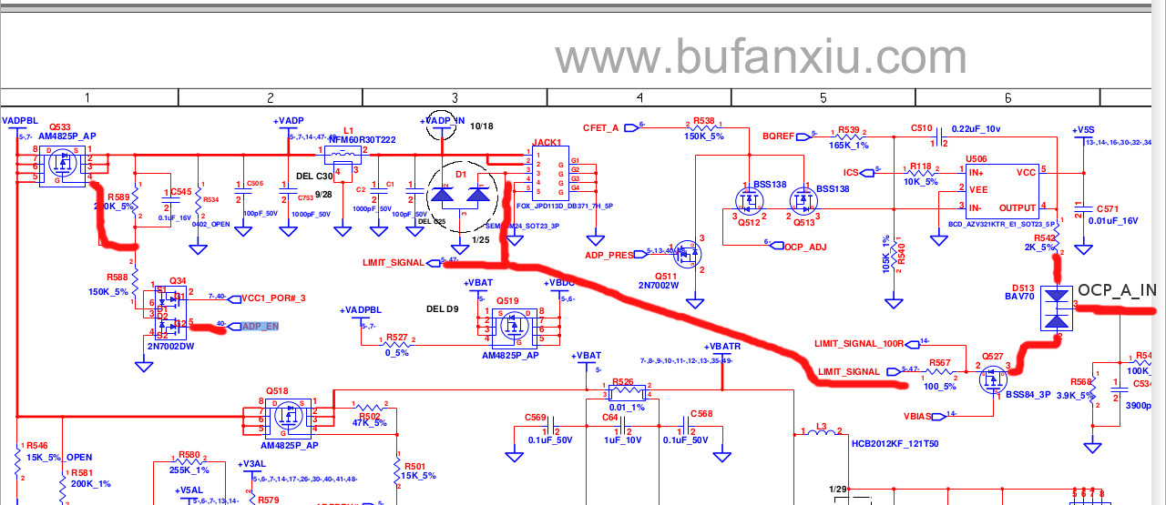

                  Re: HP Probook 6450b not powering battery light flashing 8 times
                  Check this images, follow the traces and make sure the signals are there.
                  I searched the net and nobody seems to have good answer for this battery light flashing problem.
                  I will give you some steps to check this should fix most of the problems.
                  First, very important to know: many hp models (some dell also) will not power on if the middle pin of the adaptor is not detected or the signal /voltage is wrong. Get the original working charger first before you mess up the board!
                  1. check your charging socket - replace it
                  2. Bridge the connection of the middle pin to 19v and check if it comes on
                  3. check if there is 19V on the mosfets and capacitors on the board, if not adp_en is missing to switch the first mosfets on.
                  4. If the OCP_A_IN signal that goes to the keyboard controller is missing, the flashing light will occur even when adp_en is there and you have 19v all over the board.
                  Maybe there is a trick to put 3.3v on the ocp_a_in or the selector output to simulate the adaptor is plugged in. In my case the trace for the limit_signal on the board was broken, because of water damage.
                  https://www.4shared.com/photo/vNVx2d...probook-1.html
                  https://www.4shared.com/photo/s8nYBR...probook-2.html

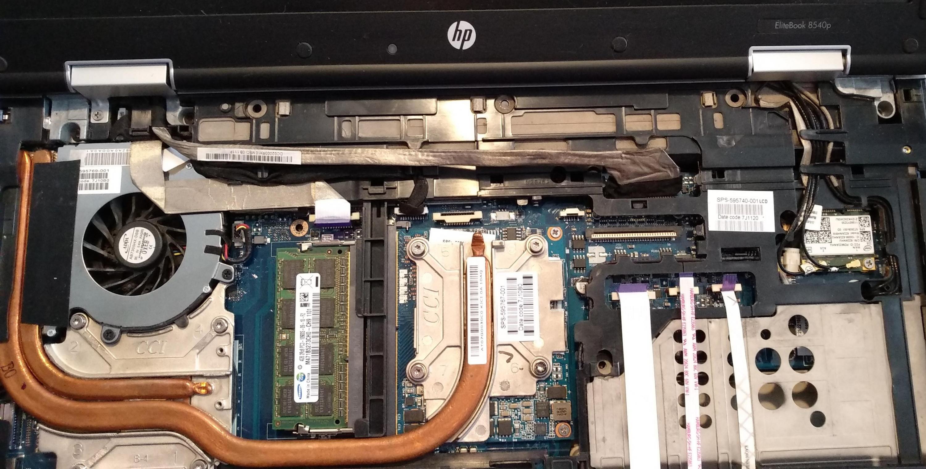

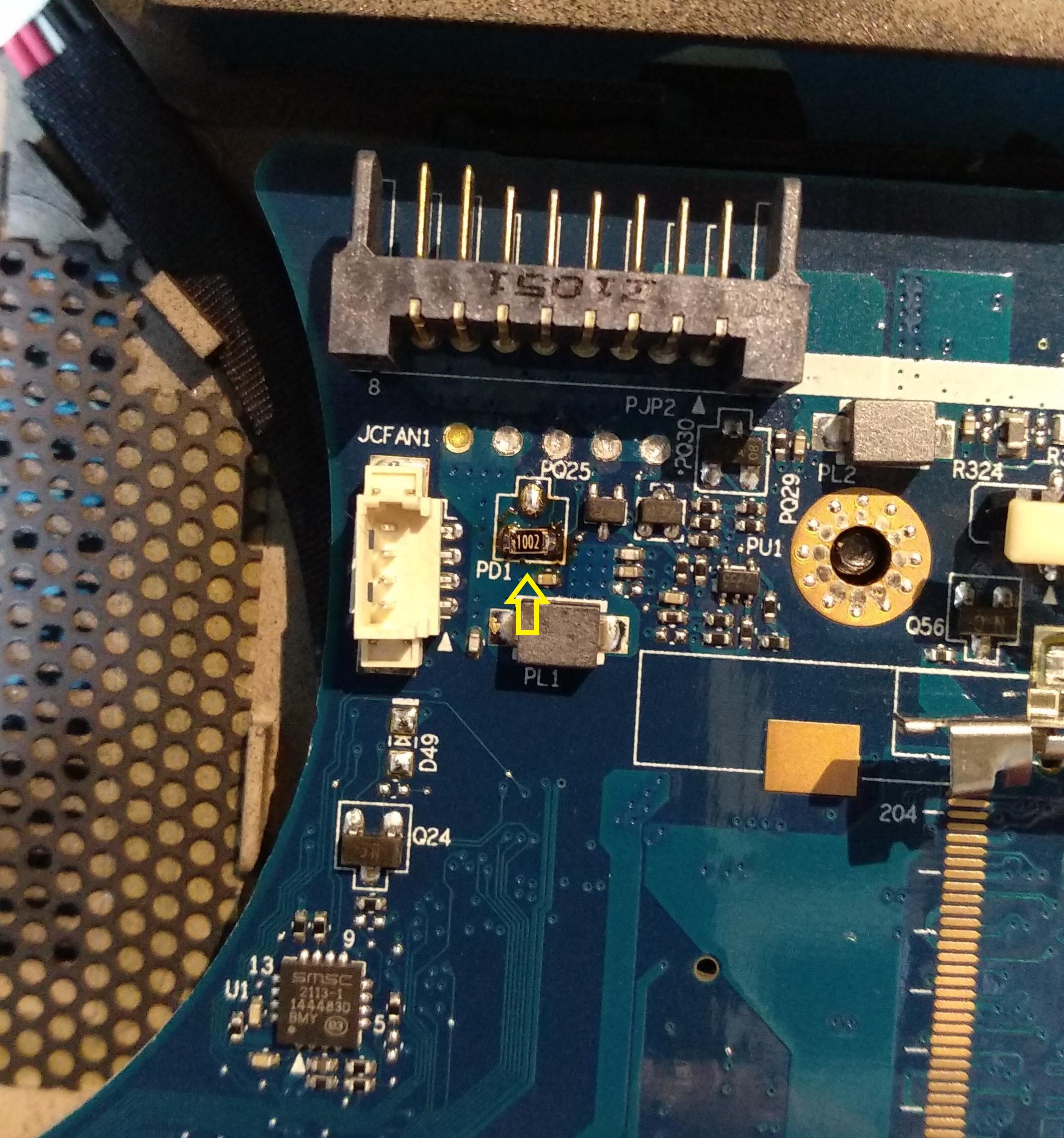

                            HP EliteBook 8540, 8440 battery light flashing 8 times
                            What a coincidence,
                            I found another EliteBook 8540 this time, with the exact same issue, blue light blink 8 times. I was searching with Google and I found my post, I had completely forgotten about this solution I found back then in 2017.
                            So I see the power connector with the 5 pins on the pcb side, middle is the center pin of the connector. Added a 10k resistor straight on some empty spot near the connector itself and now the voltage is around 9V. The battery is charging and computer turns on!
                            There must be some part on the motherboard changing properties in a similar way, since these 2 computers I found at 3 years interval happen to have the same 8 blink issue. Imagine how many motherboards have been changed for just a little resistor! Cheers!

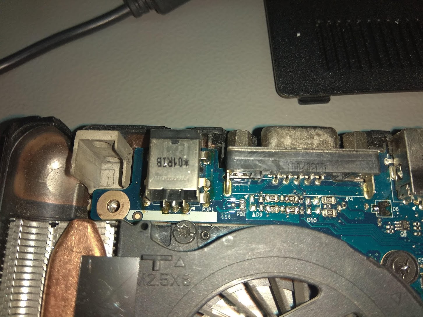

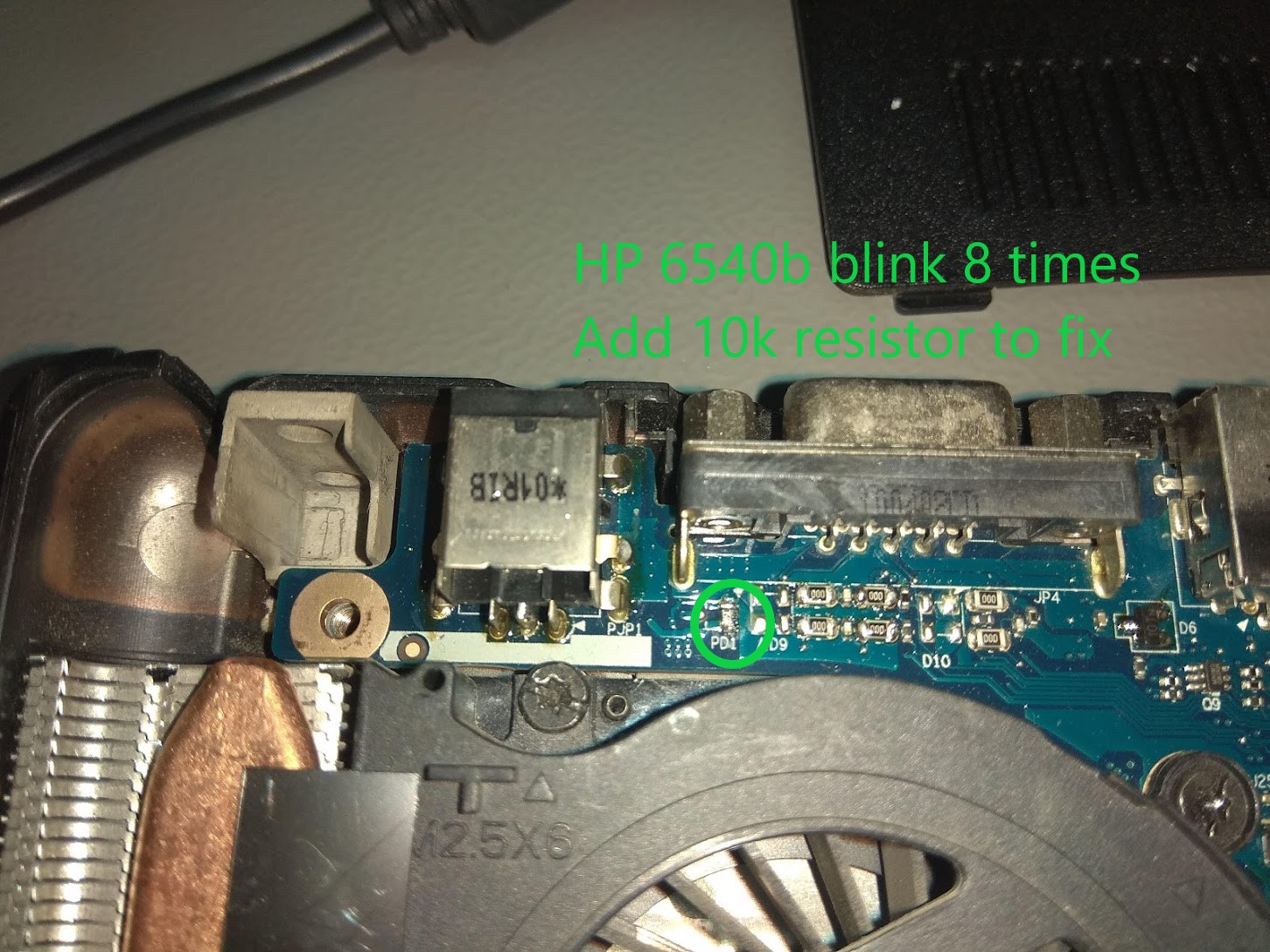

                                FIX my HP 6540b
                                • befam77847
                                  • Jan 2021
                                  • 2
                                  • Polska
                                  Photo with notes
                                    Congratulations 👏
