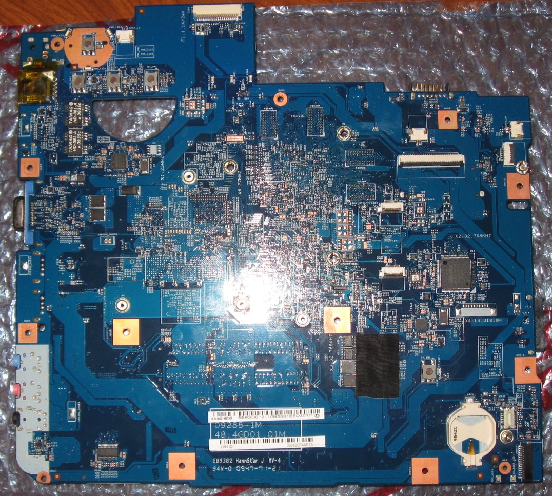

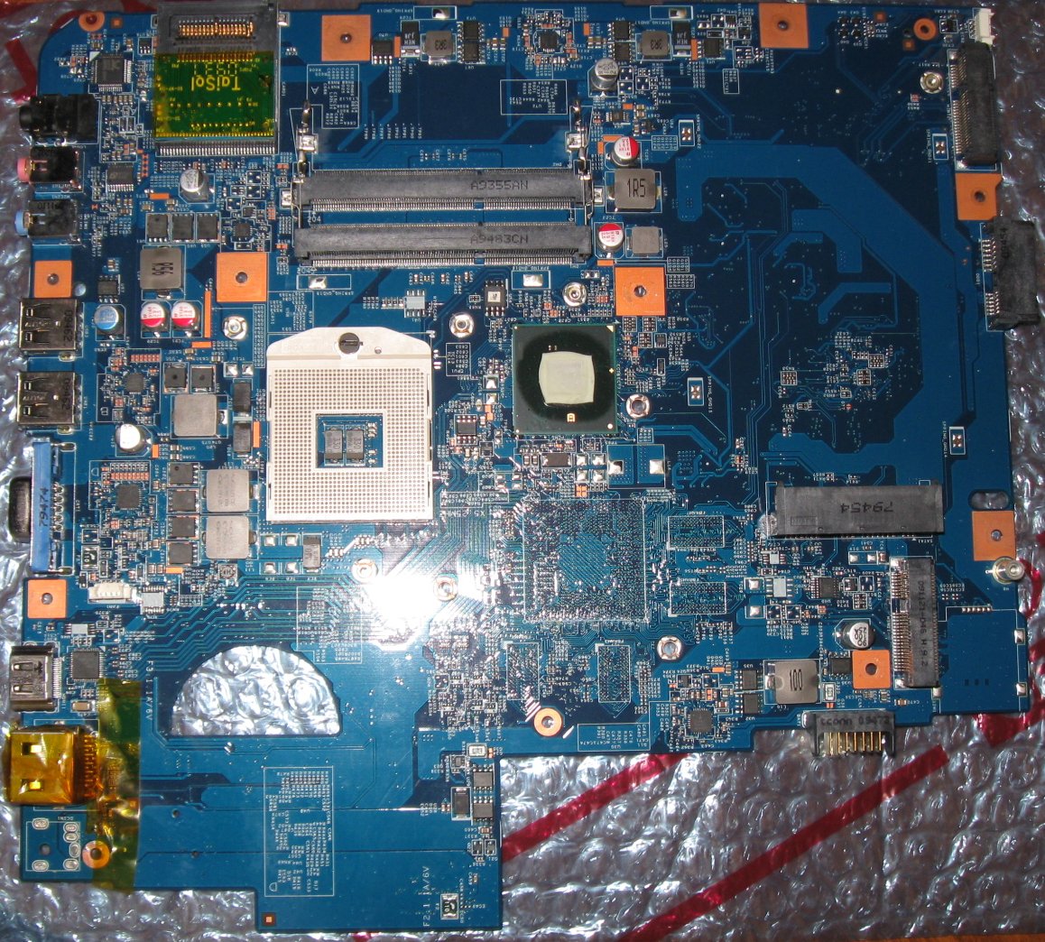

    Need help with a Acer 5740 board I picked up:
    Symptoms when received:
    - 1 Would not power on with AC only (Ac Adapter (PS) light flickers NOT STEADY)
    -2 Powers and posts on with battery only
    3- Worked with AC and Battery pluged in but no charge light

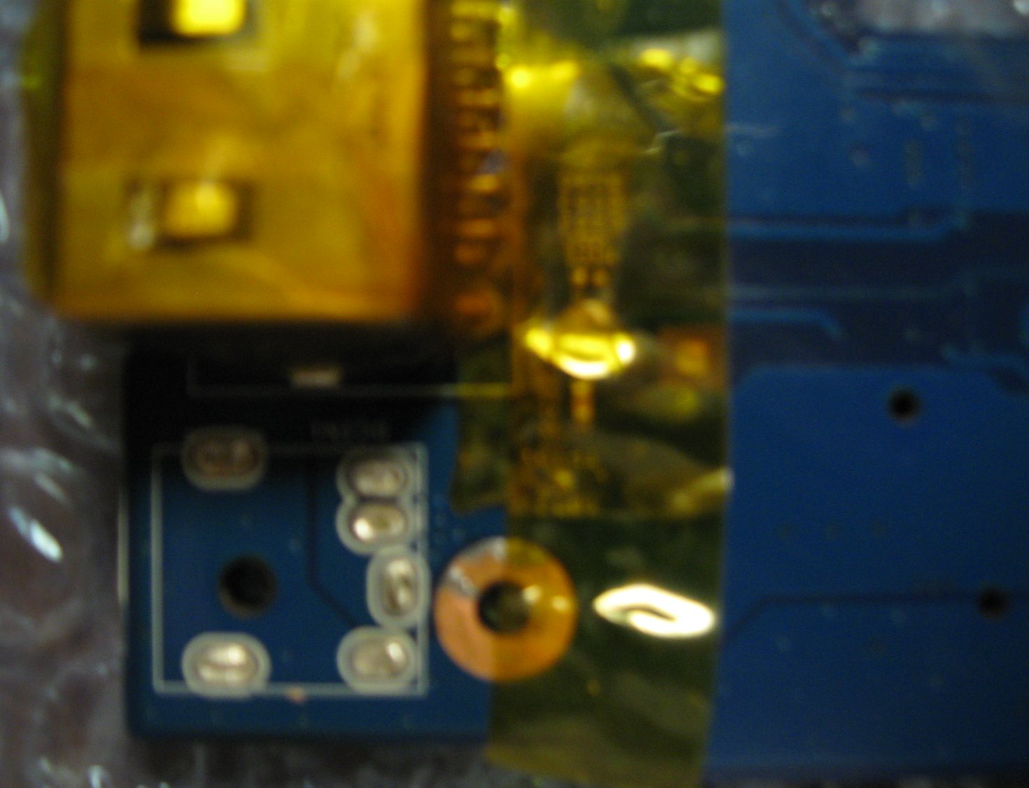

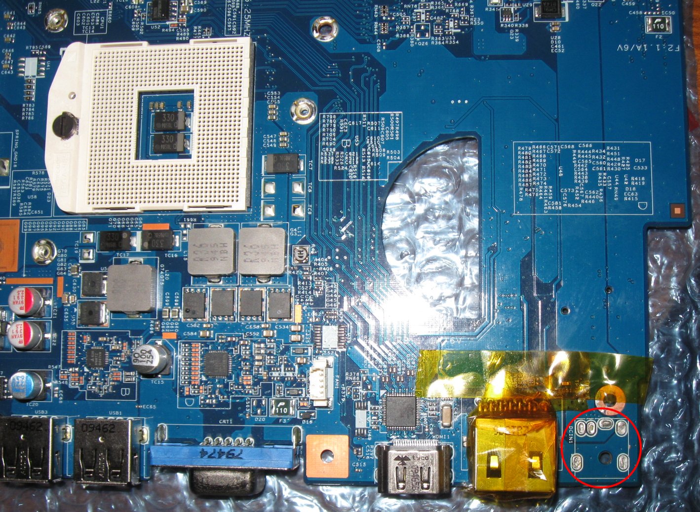

    I was thinking AC Plug so I removed it but I see not shorts in plug
    Then I go ahead and do a Continuity test on pins on ac Adapter on board and
    have weird results:
    All pins ground / mounting holes and POsitive pin all show they all connected to each other. I believe Positive should not show up as connected to ground pins correct?
    How do I go about fixing this and hat is the cause? is it damage to traces on board at ac adapter connector or other componets.

                Re: Help wit Acer 5740 Board [All pins on AC Socket shorting]
                in picture 1 the 4 mosfets in arrow the first looks damaged
                • DJ_MIX
                  • May 2005
                  • 118
                  Sorry don't see any damage at all to the board besides me removing ac plug..

                      I'll give that a shot but, it may not work since I get a short right at ac socket. I even tried removing socket and using my variable power supply and crank it to 18V but only see it supply about 1.X volts.
                      I removed U32 and u35 becuase they look like they might be bad but afther tesing it outside board they appear fine.
                      • DJ_MIX
                        • May 2005
                        • 118
                        I give up on this board I supply it 18V with regulated power supply and only get
                        .14v at ac socket Pins.. Thanks for everyones suggestions u29 gets about .14v as well
                        but ac in dc in I get not readings
