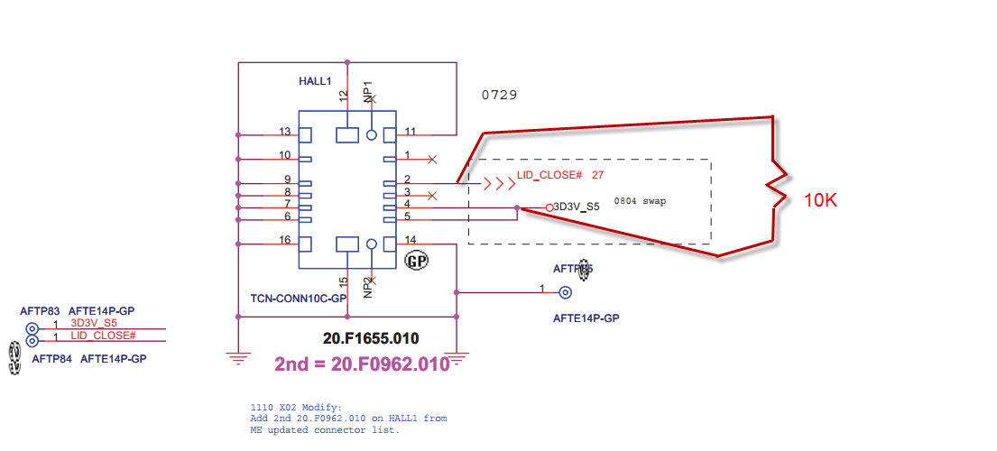

                                  I think you lost a small board that insert to socket HALL1, so it lost LID_CLOSE# signal from sensor to I/O. This will lead to the I/O will not send signal to enable the backlight.
                                  Replace by using a resistor 10k connecting Pin 4&5 to pin 2 of HALL1.
                                  I think it'll be OK. i met two faults like yours.
                                  Sorry for my bad english

                                    Great work @vvacl, solution working 100%, thanks...!

                                      First dry saltring the I/O ic then its not work then proceed to hall1 connector jumper follow the procedure by vvacl...

                                        This may be my issue but I'm not understanding what I need to do "Replace by using a resistor 10k connecting Pin 4&5 to pin 2 of HALL1."
