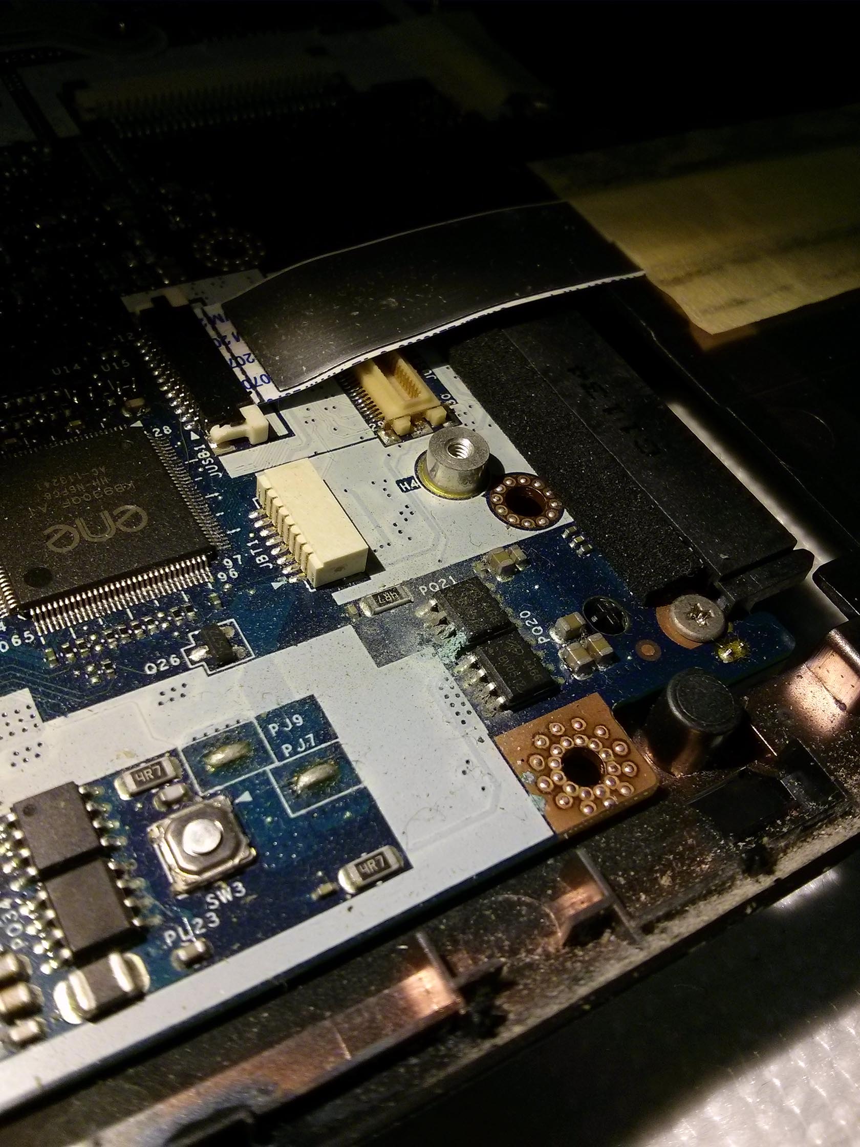

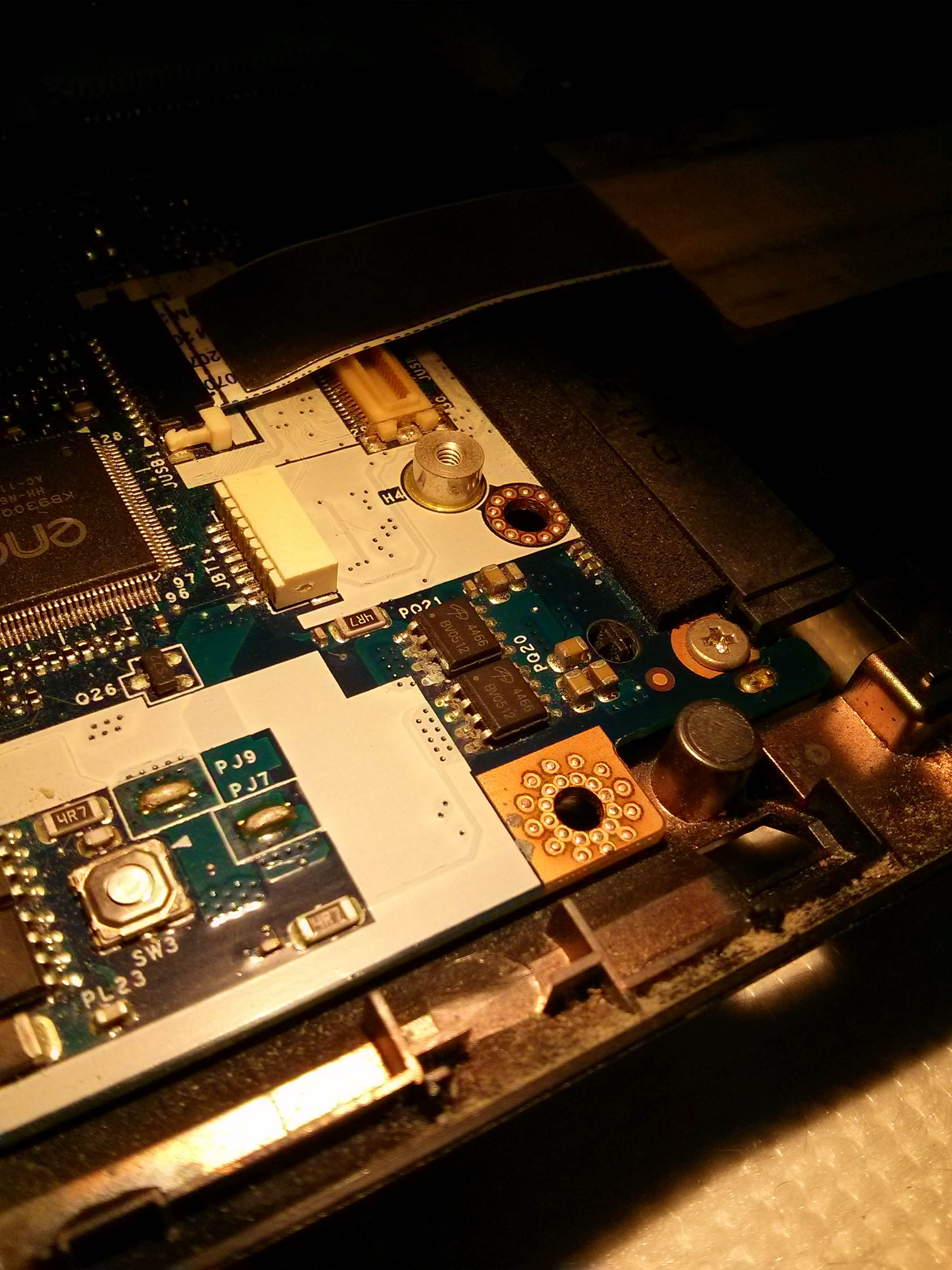

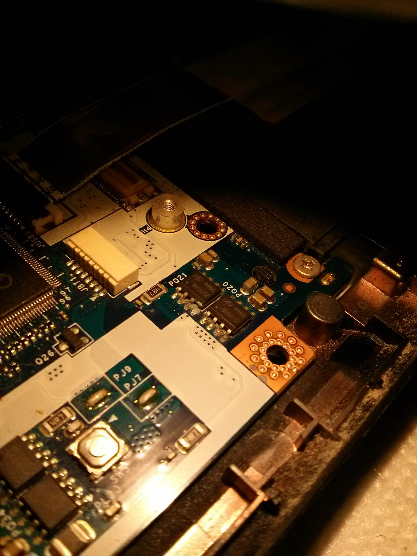

            #65
            Re: Acer Aspire 5750-6845 dead
            Hi from Italy,
            I'm facing my Acer 5750g's death.
            He stopped turning on from one the to another.
            Power supply/charger is in 100% working order and it provides 19V and when it's plugged to main 220 AC ~ its led turns on as expected. The notebook seems dead, no suonds, no leds on, no hd activity..nothing. When I connect the power charger, this seems to go on short circuit, the green led turns off and no voltage is provided anymore. Disconnected and replugged it again from 220V ~ it works again.
            I opened the notebook and noticed anything strange except the PQ21, at least two pins of this IC are corrupted, maybe oxide, don't know the causes. Here's some picture, before and after a little cleaning.
            Replacing the damaged one with a new IC A04466 will be enough to have the notebook working again or this can be compromised from PQ21 faults?
            Thanks a lot.
