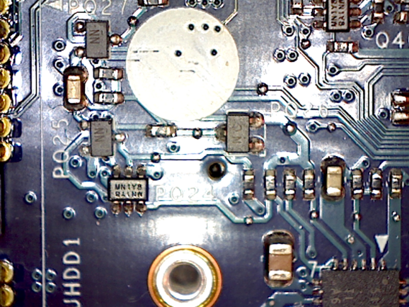

    pin #8-Vreg3= 3.273V
    pin #13-EN= 1.965V
    pin #17-Vreg5= 4.964V

        Reading looks ok on those pins. Try to press the power button and check if you get voltages at pl4 and pl5. If you get normal voltages, led lights should turn on.
          Re: Acer Aspire 5750-6845 dead
          I did that, and nothing happened.
            Does pin32 of u20 goes low whn you press power button? Voltage of your cmos battery?

                    Voltage at Pin 1, 6, 12, 19?

                      At pin #1, 6 I'm getting 0V.
                      At pin #12 I'm getting -0.003V
                      At pin #19 I'm getting 0V

                        You get no voltage at PL4 and PL5 because pin 1, 6 or ENTRIPx is 0v.
                        Measure the voltage at pin 2 of PQ25, EC_ON pin 2 of PQ27.

                          There is 0V on all three pins(on or off).

                            VL is connected to VREG5, so you should have 5V at pin2 of PR64. Check if PQ24 and PQ25 is ok.
                              #34
                              Measure resistance of PQ25 from pin2 to ground. If you get a short here then either of the two transistor is defective. You may need to pull them out and test out of circuit to confirm.

                                    It seems that I had a bit of problem and I haven't noticed it in time.
                                    The negative wires were broken off at the DC in plug.
                                    Now I have 4.82V, 0.011V and 0V at pin #2.(PQ25)
                                    Still no voltages at the U20.
                                    PQ24 is a 6 pin little IC.
                                      #38
                                      Where do you read 4.82v? What are the voltages at pin 1-6 of PQ24?
                                      Also what are the voltages at the pins of PQ26. The gate is connected to EC_ON and comes from ENE KB930.

                                        On pin#1(base) I have the 4.286V(sorry I had it wrong).
                                        It seems to high for base, no?
                                        Collector pin#3 is 0.011V.
                                        I don't know which one is pin#1 at PQ24.
                                        If I look at the markings on it, from the readable side, I start writing the pin voltages from bottom left side toward right and going up and toward the left side.
                                        pin#1=0V
                                        pin#2=0.011V
                                        pin#3=1.118V
                                        pin#4=0V
                                        pin#5=0.11V
                                        pin#6=1.54V
                                        PQ26
                                        pin#1=0.005V
                                        pin#2=0V
                                        pin#3=4.286V
                                          #40
                                          Looks like your voltage readings on PQ24 is ok. Why? there is a voltage at the SOURCE of both mosfet(see ) that is enough to put ENTRIPx high and make VOUTx to give 3.3V, 5V at PL4, PL5, provided pin13 EN Of PU2 is also high.
                                          On PQ26, the result is odd. 4.286V is for pin 1 right?
                                          One more time, could you please measure all voltage at the pins of PU2 for confirmation before you change this IC?
