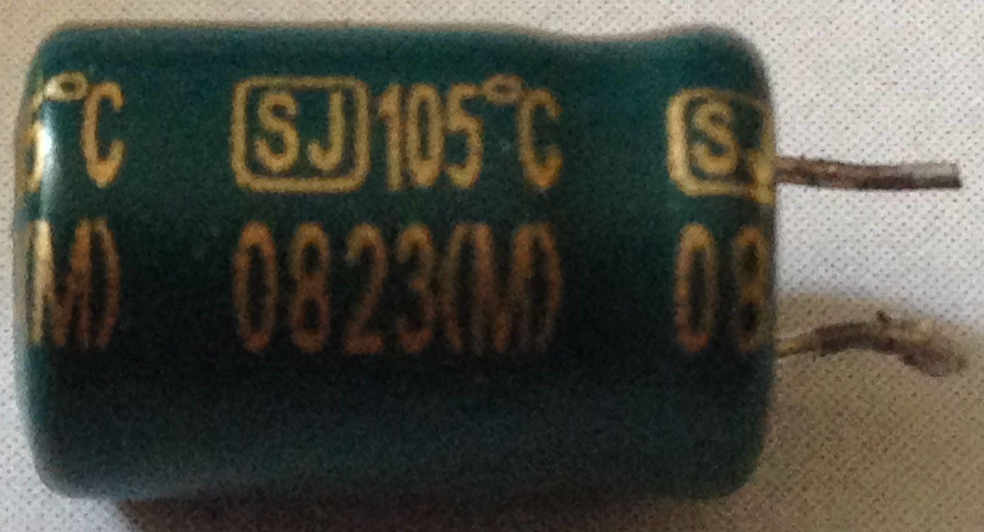

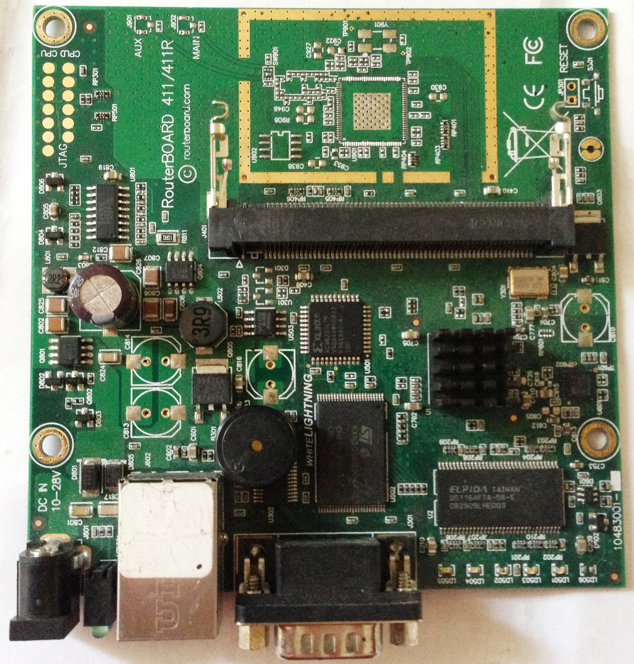

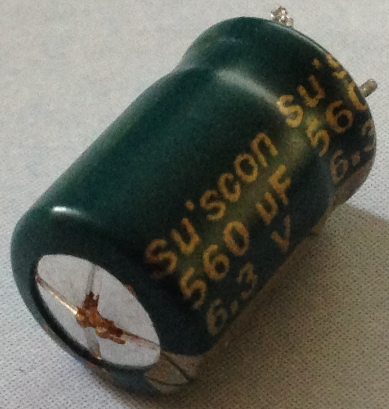

    I'm new to the forum and not much of an electrical whiz. I run a small WISP in Utah and I use Mikrotik/Routerboards all over my network. They are great devices with horrible capacitors in them. I have had this problem when the boards are powered with a wall wart as well as POE, indoors and outdoors. I've tried contacting Mikrotik regarding the capacitor problem but have not gotten far. I'm hoping to find some answers here. I have pictures of the capacitor and one of the offending boards. I am looking for two answers.
    1. why do these caps keep failing?
    2. What cap would be a better choice for replacing the blown ones.

    1 - Su'scon are absolute crap caps.
    2 - Panasonic FM series.

        The Su'scon is a 560uF 6.3v capacitor. You can replace with 560uF 6.3-16v capacitors (capacitors with bigger voltage rating can be used with no problems at all)
        Replace with Panasonic FM or Panasonic FR series capacitors.
        FR series handle heat a bit better but even FM would be much better than what's used now. As mockingbird says, double check the wall warts as well.
