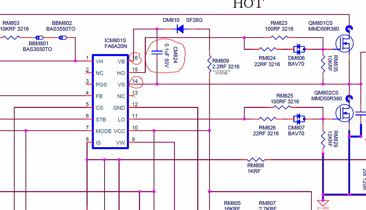

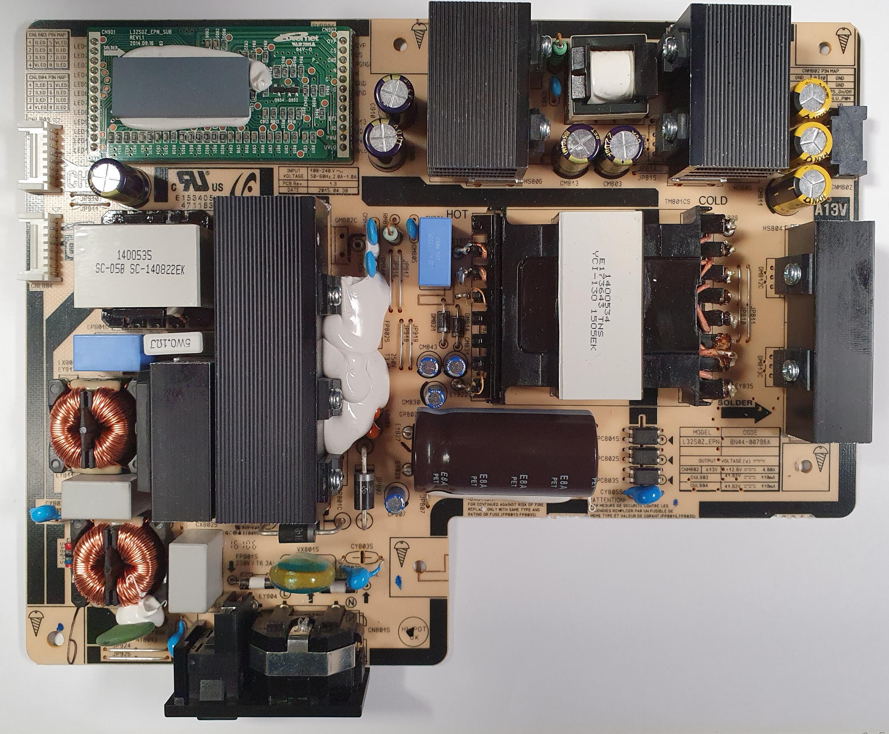

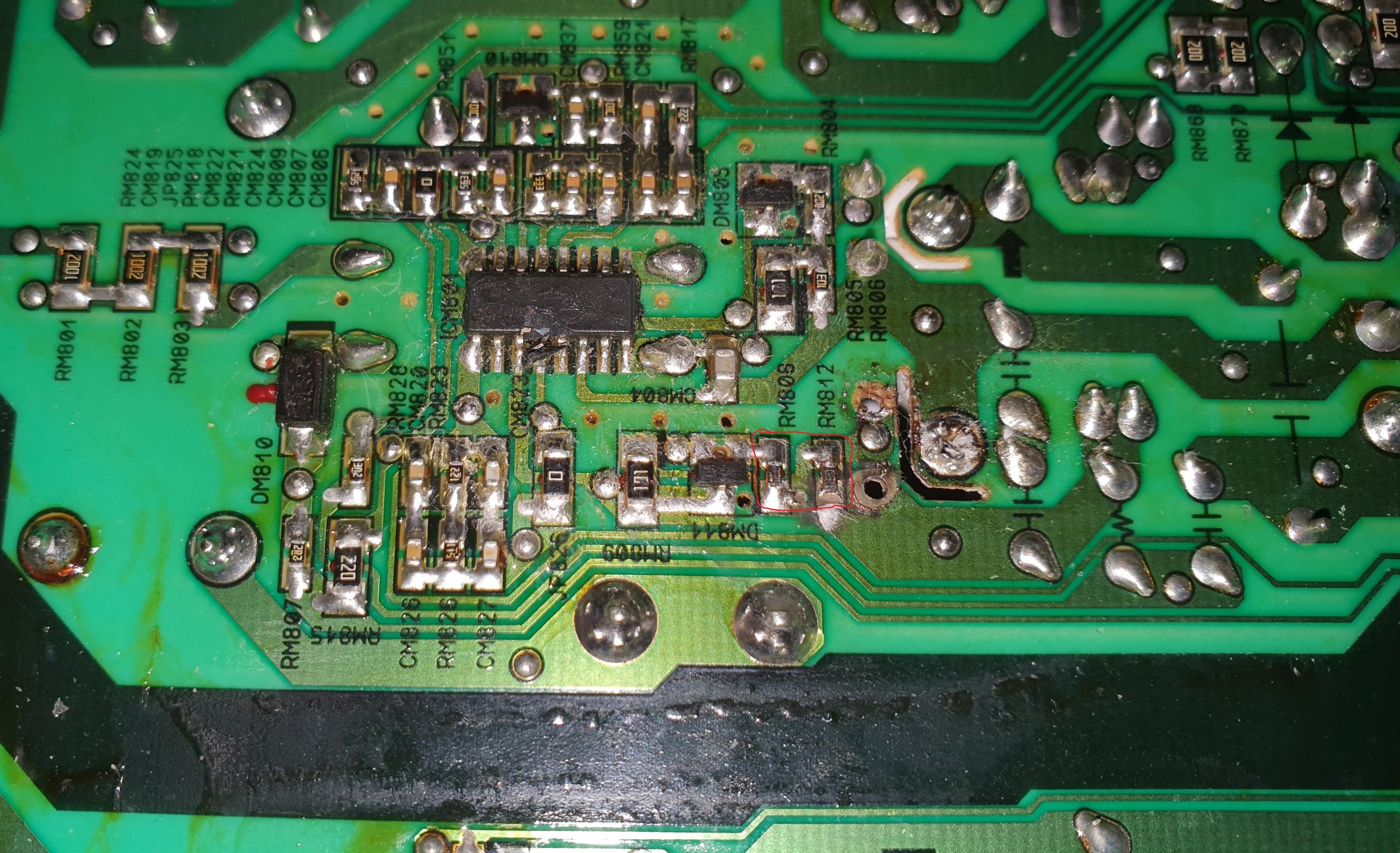

    Hi, my U32D970 PSU (BN44-00786A) has blown up. It went out with a loud bang.
    One of the N-Channel Mosfets (OM802C) caused a short and fried the trace and its components connecting to one of the pins of the 6A01 IC.

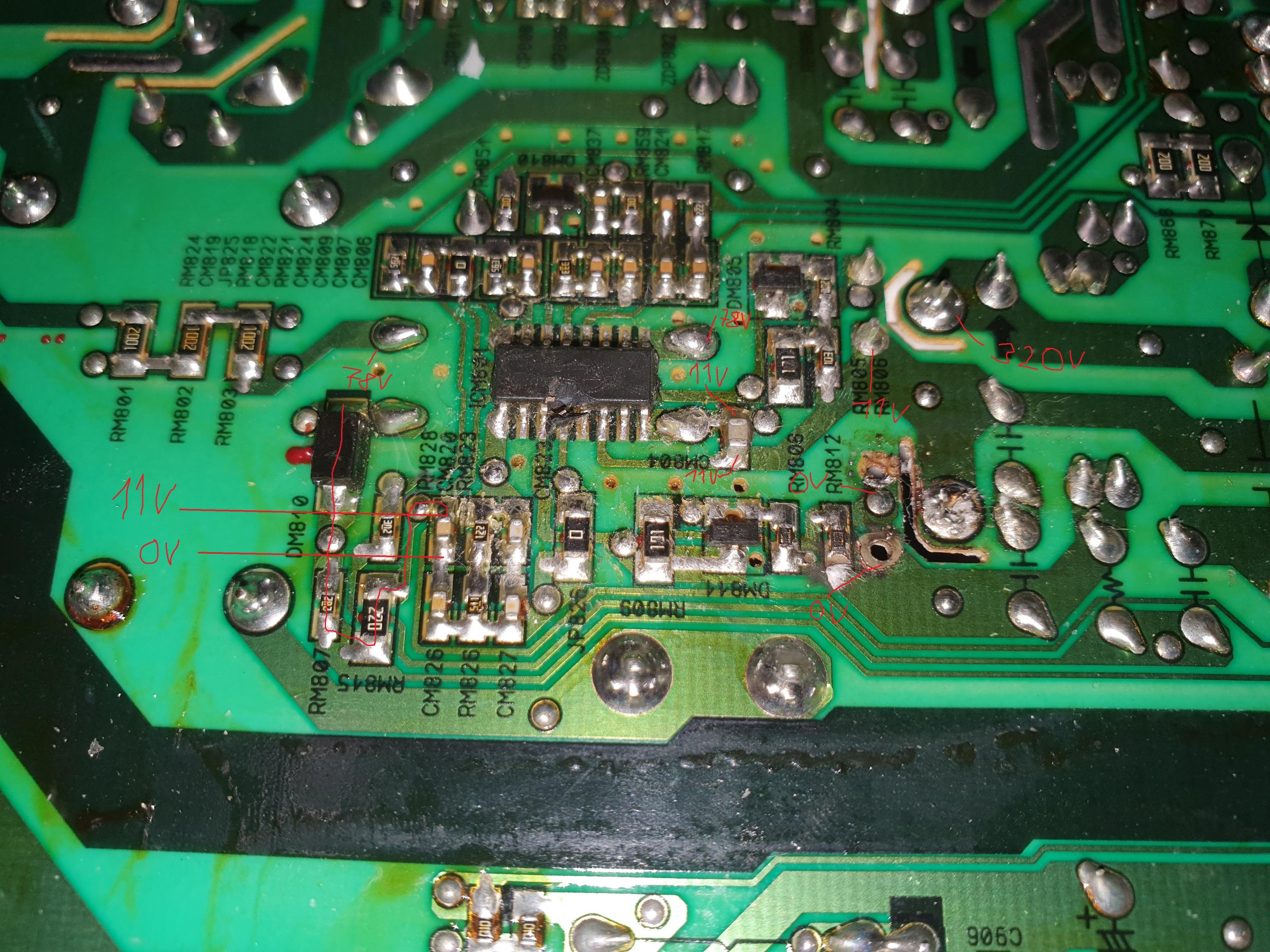

    I need help to identify 2 SMD resistors which lost their markings
    highlighted in picture 3 (RM812 and RM808).
    Maybe someone can help me identify them, has a schematic or can give me some advice. would be much appreciated.

    Re: Samsung U32D970 PSU blown up (Identifying Parts)
    The photo shows that other resistors also burned out, rather, these diodes in the sot23 package also suffered.

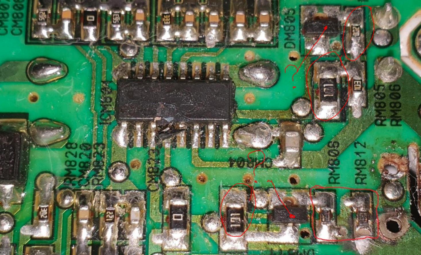

    • Fr3shGy
      • Mar 2015
      • 47
      Yes both traces got damage. i am going to change every part on each trace.
        RM812 should be 10kOhm (103), RM 808 is a low ohm resistor.
        • lotas
          • Jan 2016
          • 4649
          • Russia
          RM805 = RM809
          RM806 = RM812
          RM804 = RM808
          DM805 = DM811
          Please refer to this diagram. And you will have to replace the second mosfet (rather, it is also not working.

              so after waiting ages for the parts, they finally all arrived.
              currently replacing the 6A01 and the resistors. i found out that the capacitor CM804 gives me no reading inside nor outside the circuit and needs to be replaced.
              Does someone has the value of CM804?

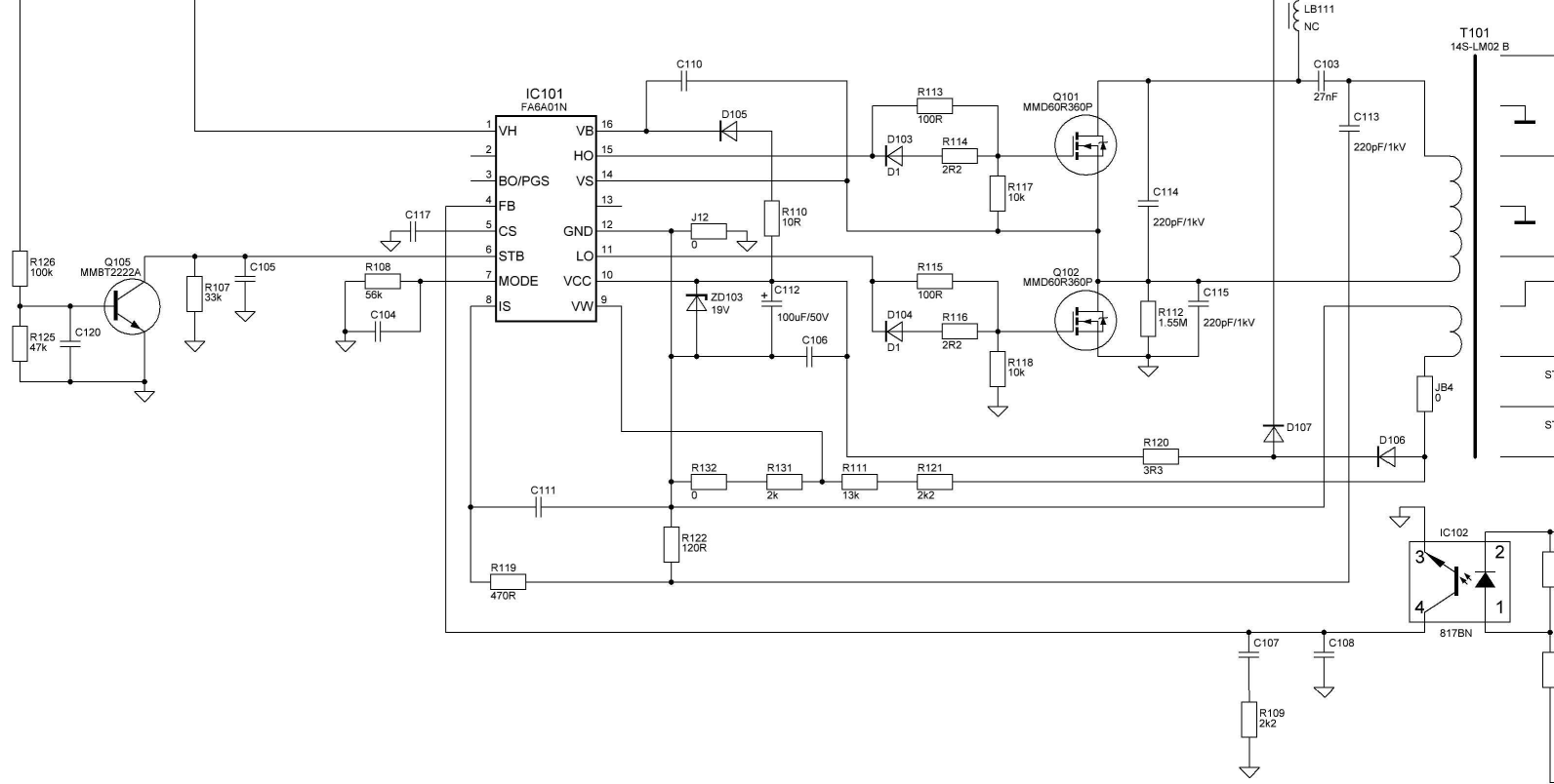

              • lotas
                • Jan 2016
                • 4649
                • Russia

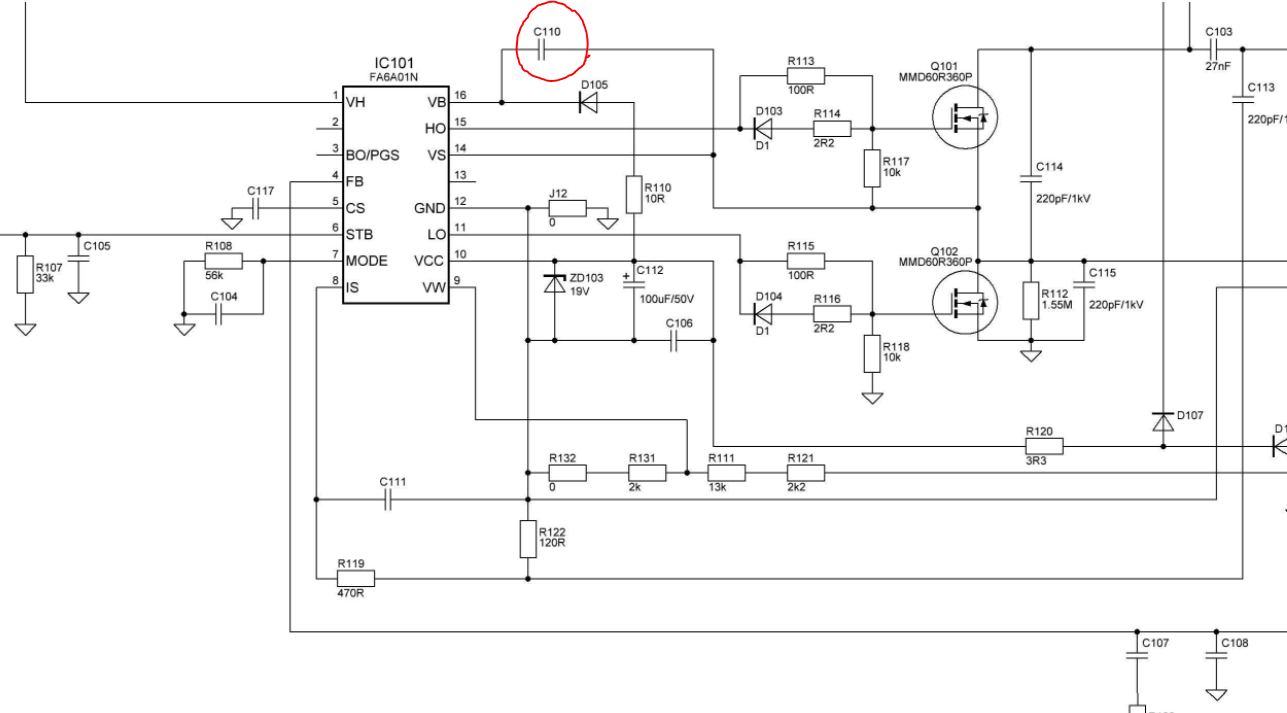

                Here is an approximate circuit from this series, it costs 0.1mFx50v.
                • lotas
                  • Jan 2016
                  • 4649
                  • Russia
                  On this diagram, it is designated as C110, but there is no face value for it.

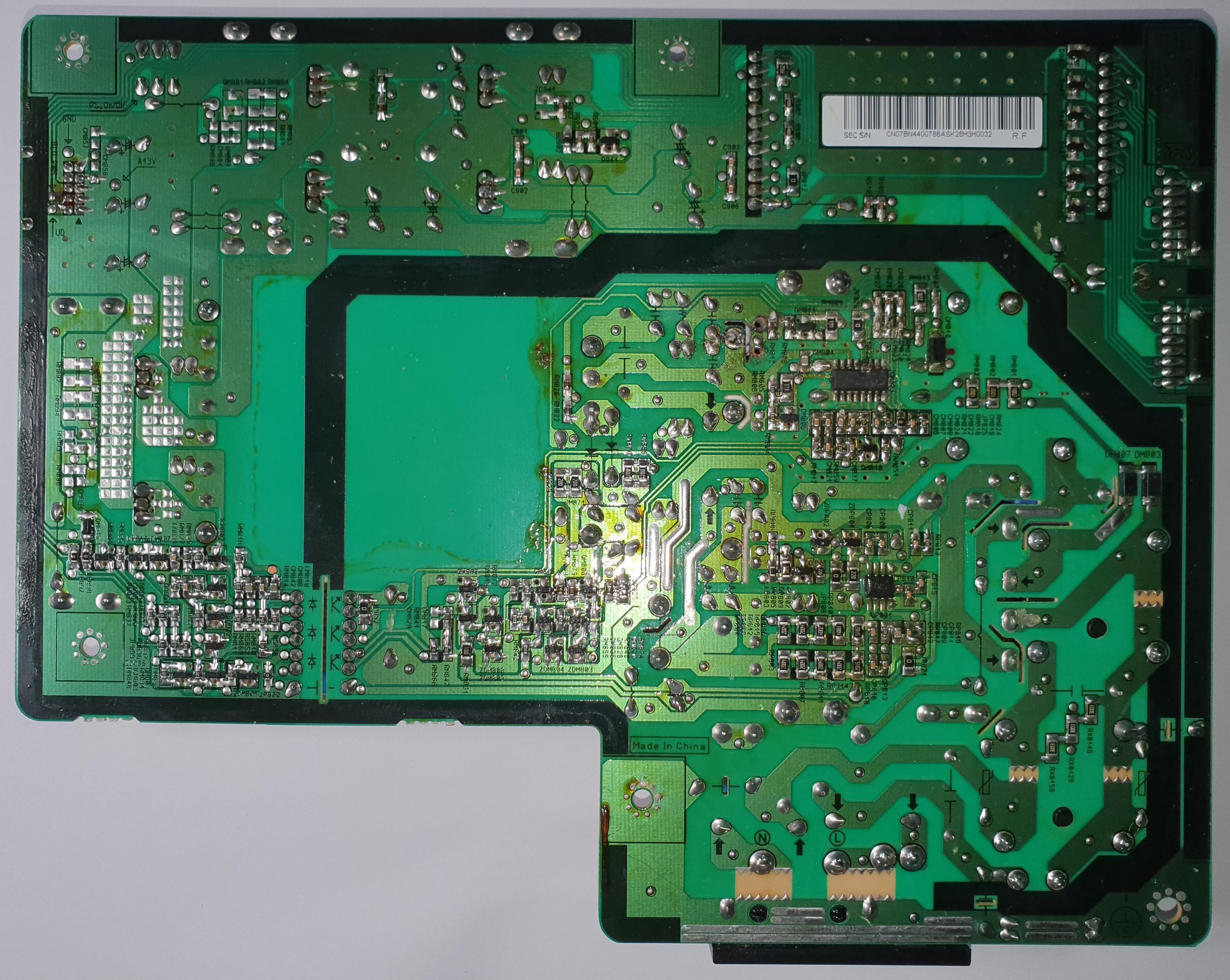

                    thank you for helping me with this. i only had a 10mf capacitor laying around but i ordered a full set of them with lower values. for now i replaced the cap with the 10mf one.
                    I am getting weird readings. the second mosfet does not turn on (i marked some readings in the picture).
                    I probably need to replace C820 aswell because the 11V does not pass through. as soon as i get the replacement caps i will make a more detailed overview of the readings i get.

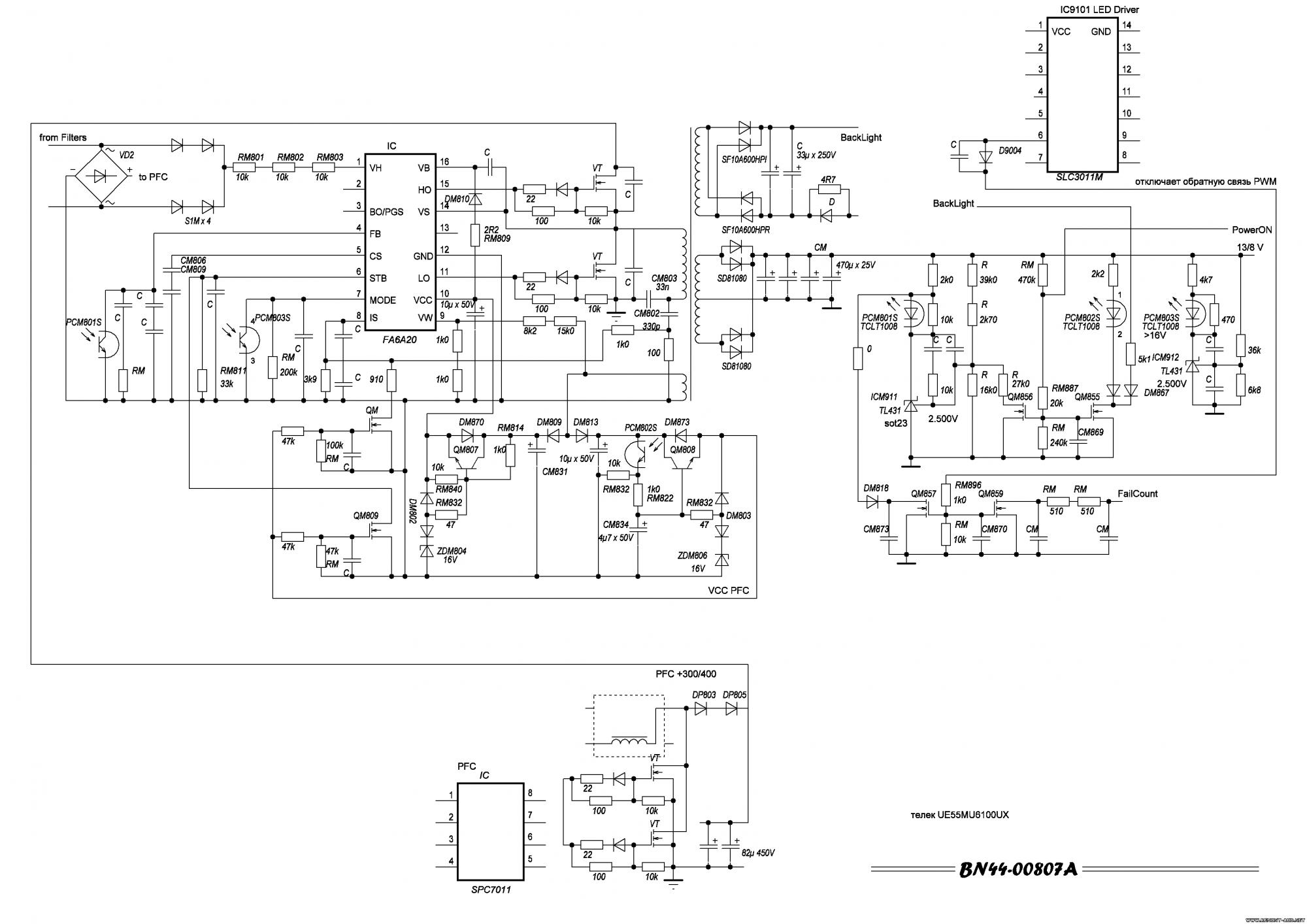

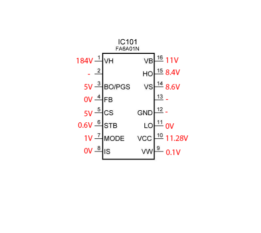

                      BN44-00786A no power/no standby
                      I already posted a month ago about broken components on my BN44-00786A PSU that i replaced.
                      Took me ages to receive all the missing parts.
                      I replaced the purple marked components in picture 1 mainly the LO and HO line components, the components at the VW line, both mosfets and the IC.
                      I attached a picture with all the measurements i get currently.
                      1.VCC is sitting around 1.8kohms and puts out 11,28V
                      2.LO output gives me flat 0V therefore i get no voltage at the gate of the mosfet.
                      3.The UP801 that is a (SPC7011F / FA5965) receives 0V at the VCC pin.
                      Am i right that the VCC output voltage of the SMPS controller (FA6A01) should be at around 13,5V and because its at 11V it does not startup?
                      Does the VCC of the 6A01 supply the UP801 with power?
                      (I attached some pictures and similar schematics)
