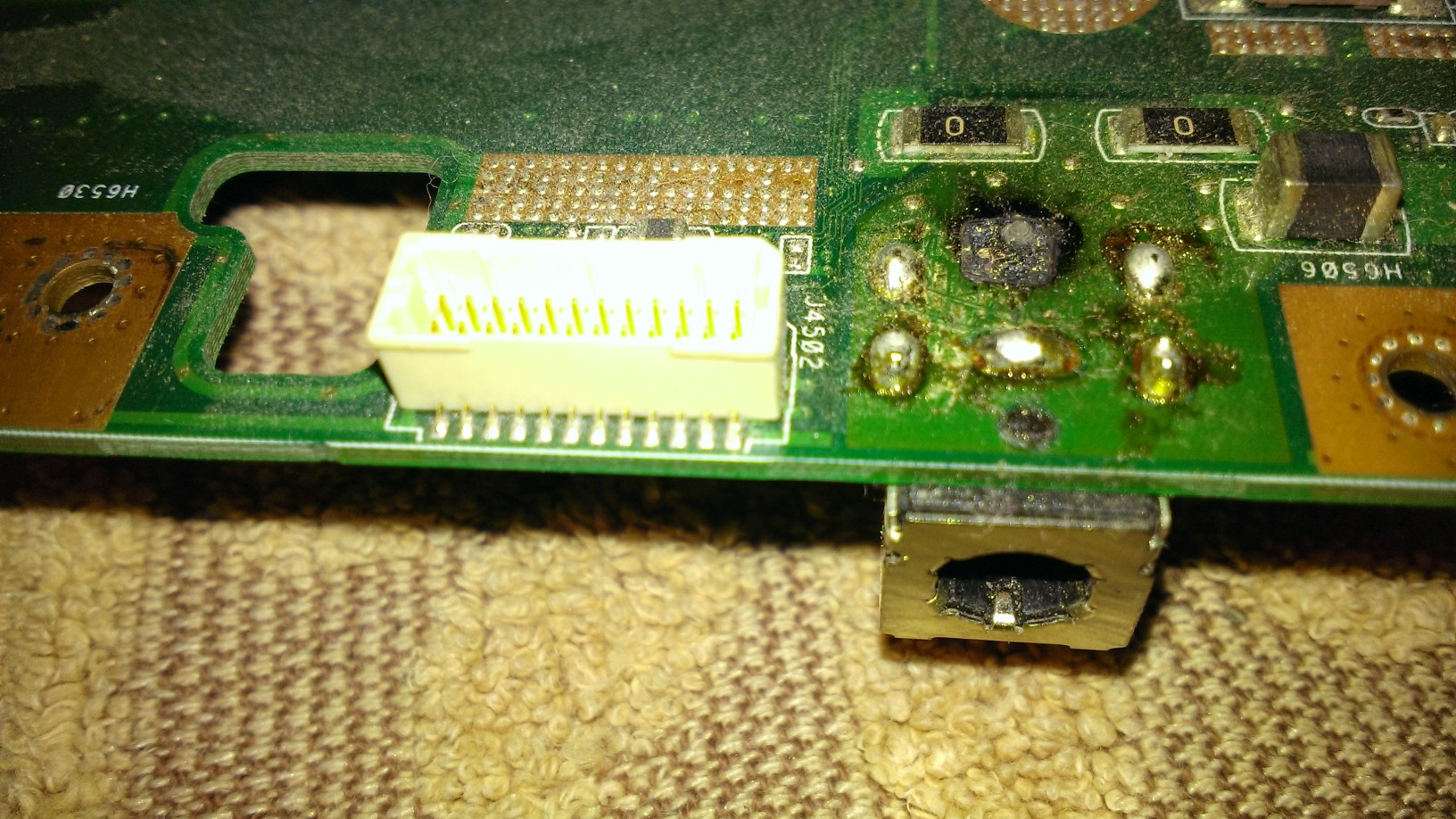

                              Asus Republic of Gamers Laptop having same issue - smoke coming out when I plug in the power supply - comes out immediately. If anyone has specific info I would greatly appreciate it. I have seen this issue is extremely common by doing google searches but I would like specific circuit board info if possible as it is bound to be a common failure point. Thanks!
                              • billpool
                                • Sep 2013
                                • 8
                                Re: Short on ASUS Laptop
                                finished taking apart laptop to get at MB, photo below shows that one of the pins on the power supply connector is burnt. Help? I assume it's not just re-soldering it?
                                Thanks, please help me to know next steps. I have it torn apart, not sure what to test besides seeing now where it's fried.
                                -Bill
                                  bill, you need to create a new thread for that.
                                  but anyways... you need to remove dc jack from mobo using proper tools
                                  after removing, check the pad pin with black against ground if there is short...
                                  if none, clean the pad thoroughly, apply a little bit of solder to the pads, then return the dc jack if still good.
                                  then solder it nicely.
                                  hope this helps
