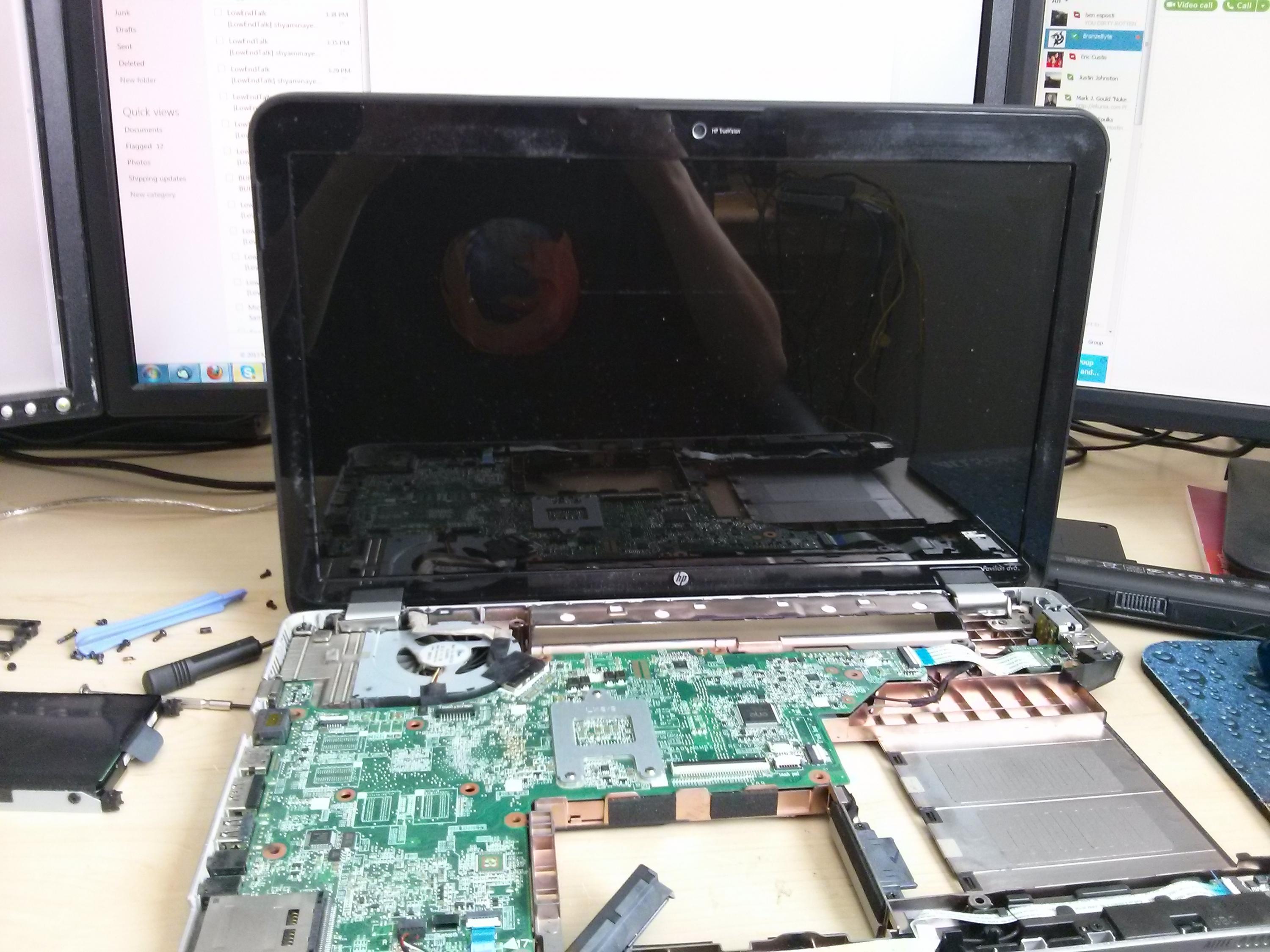

    Somebody asked me to take a look at it because "it didn't work".
    Fans and lights go on, Wireless indicator goes orange and Caps lock blinks once every few seconds.
    External monitor is a no go. According to HP website, it's got an ATI 4250 graphics, and the 1 blink means CPU error...
    CPU:
    http://www.cpu-world.com/CPUs/K10/AM...40SGR23GM.html
    I took the whole thing apart and reseated the CPU. Same problem. I'm trying to convince them it's not worth fixing and they should buy my old laptop (Lenovo V570) from me, but in case I'd like to get this working.
    Any suggestions? And I've attached a pic.

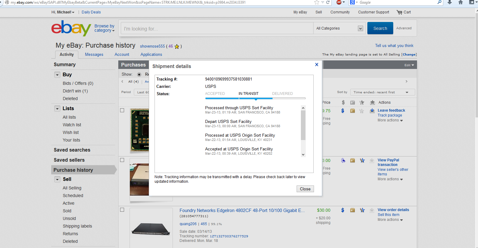

                        Home sick from school today. Should be able to try the CPU today (when it arrives, of course). Out for delivery
