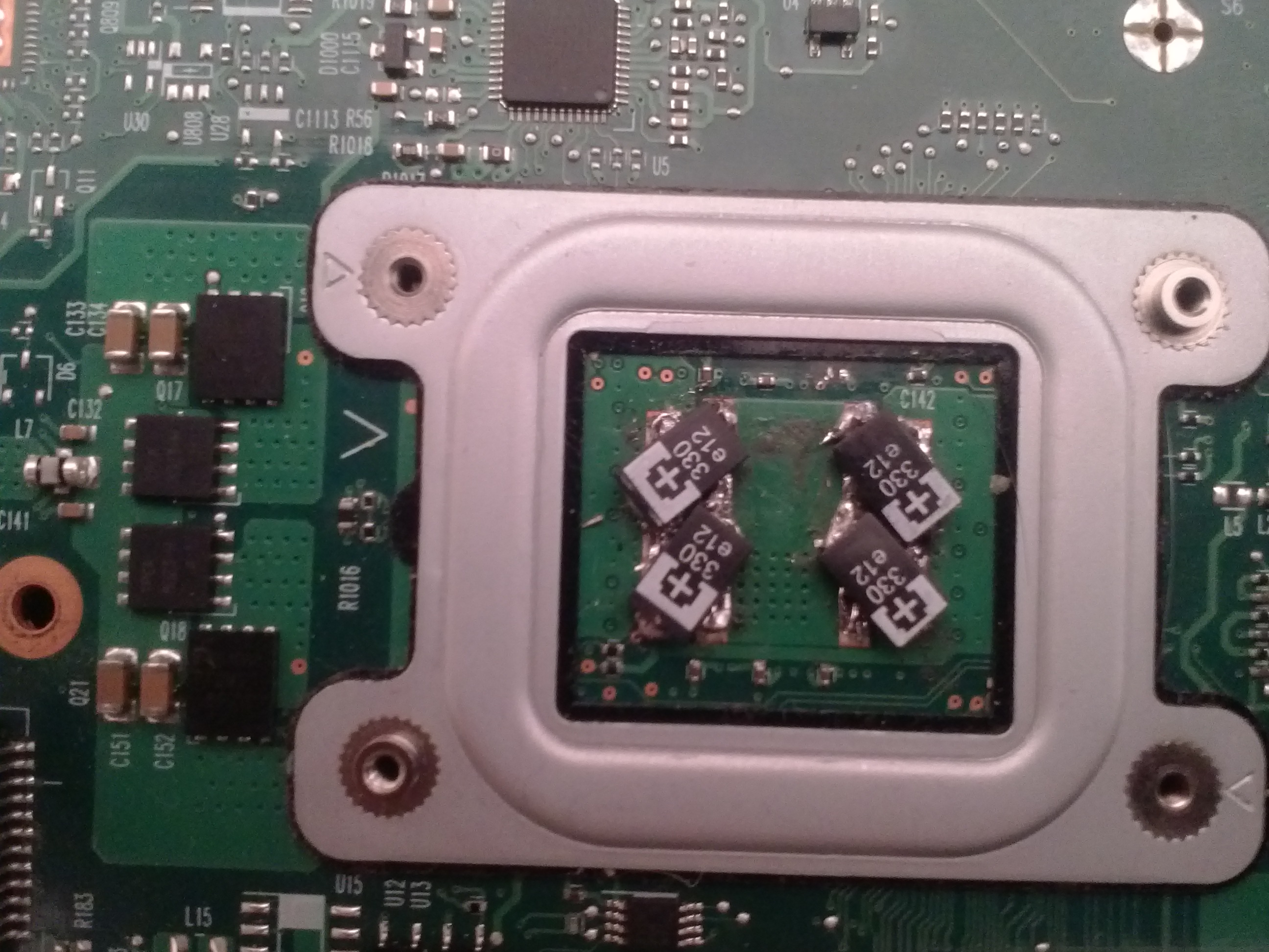

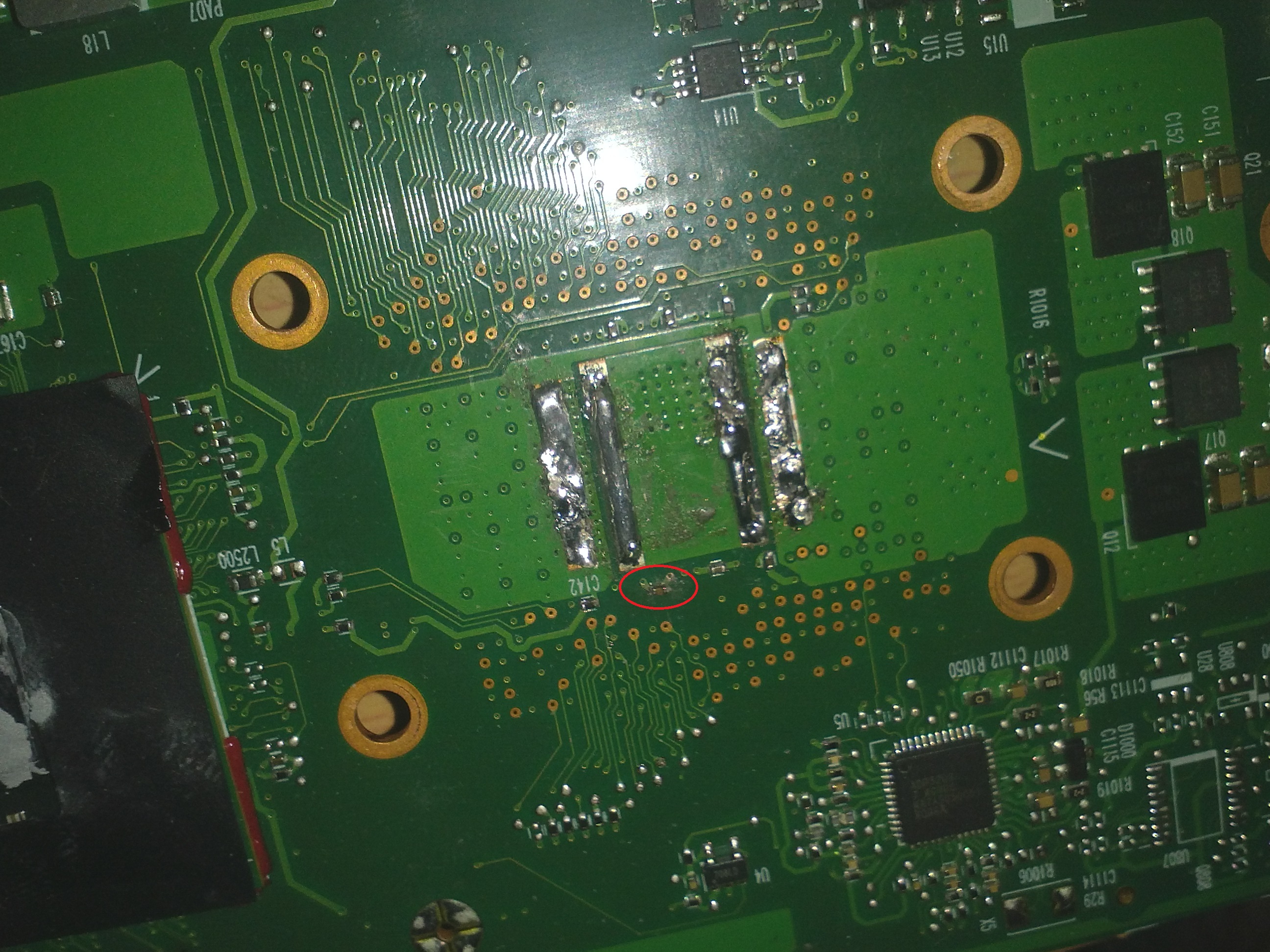

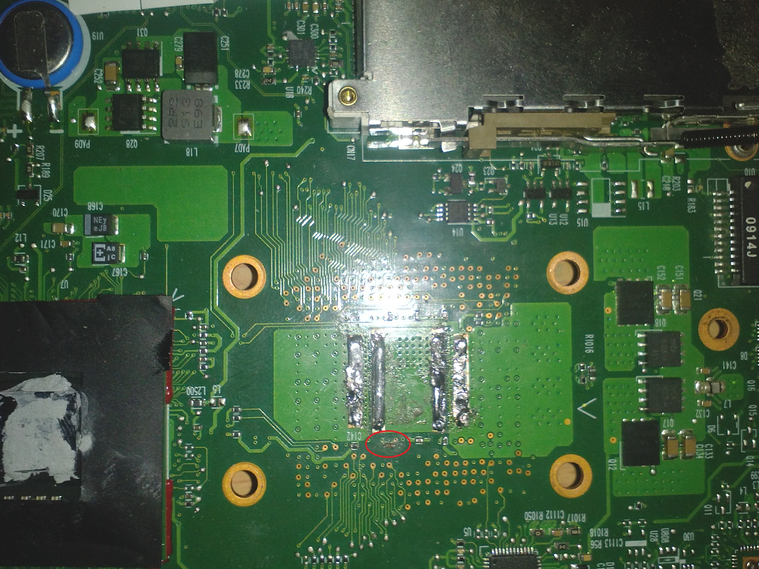

    When i tryed to remove the nec tokin of my toshiba a300, i broke a tiny piece, that i dont even know what is. I´m not an electrician, and i dont understand very much about it.
    I soldered back in place one with looked about the same as the original.But i dont know if is gonna work, and i cannot afford to screw the entire motherboard.
    Please help.
    Thank you.
    Here are some pics of what i broke.

    Its more likely to be the same value as the resistors to the right side rather than one picked at random.
    I cant see any reference numbers, so it might be difficult to tell even with a circuit diagram.

        I have no way to know. Have you measured the nearby resistors?

          sould i take one out, measure it than put it back ?

              Pictures are not close/clear enough. I take it your sure something was there originally?
              Have you still got the part that came off? Are you sure it was a resistor?.
              If it was a capacitor it could well be that the board would work without it if you replace a capacitor with a resistor it could go bang or take something else out with it.
              Have you looked for pictures/schematics of an A300, anyway which model is it are there some more digits after A300?

                My bad, didn´t sayd that in the pics is what i putted in, i lost the part that came off, but as nec tokin arrived about half an hour, i putted them in, removed what i soldered before, and poweerd up, all good, till now, installing windows, hope it worked.
                Its TOSHIBA A300-276

                  nec toking -> 4x smd 330uf didnt work, laptop reboots
                  please help
                  • darjness
                    • Nov 2012
                    • 31
                    • Portugal
                    Re: Please help broken motherboard part
                    laptop reboots, screen freezes, just as before replacement.
                    Works on battery. I still believe the problem is nec toking spot, should i add one more 330uf cap to these 4 ?
                    Thx

                      What is the part number of the 330uf capacitors?
                      Adding more capacitors might help if they have a poor ESR specification.

                          I dont know, i bought a nec tokin oe907 replacement where came these caps,
                          and i have one more with i toke from a mobo and says 330 e69.

                              I have a mobo for parts, with has 330 95XS1 d and 330 95X1P d caps on it, but i dont know if they work,

                                Added one 220uf and one 330uf, defensively more stable, at least didn't freezed or rebooted for now, hope its permanent
