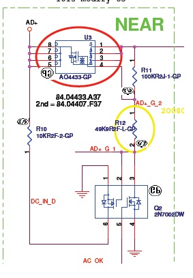

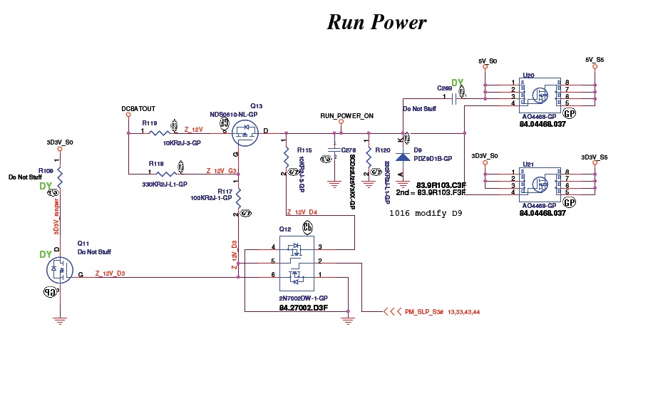

    hello my friend
    is the best forum for me
    I have a problem on Laptops
    ACER 4732Z .....
    This laptop normal condition
    but I press the power button
    laptop can not work or light up
    he only shows LED lights that work in a state of battery charge
    can anybody help me
    please
  • dj_ricoh
    • Jan 2013
    • 2073
    • uk
    Re: ACER 4732Z problem power button on / off
    hy!
    You need to open the notebook and setup the multimeter and find and check U20, U21, Q12 AND Q13.
    Good luck!
    p.s. i found the u3 4433 its near the DC IN. start from there
      Ok i will try again
      thank you were back
