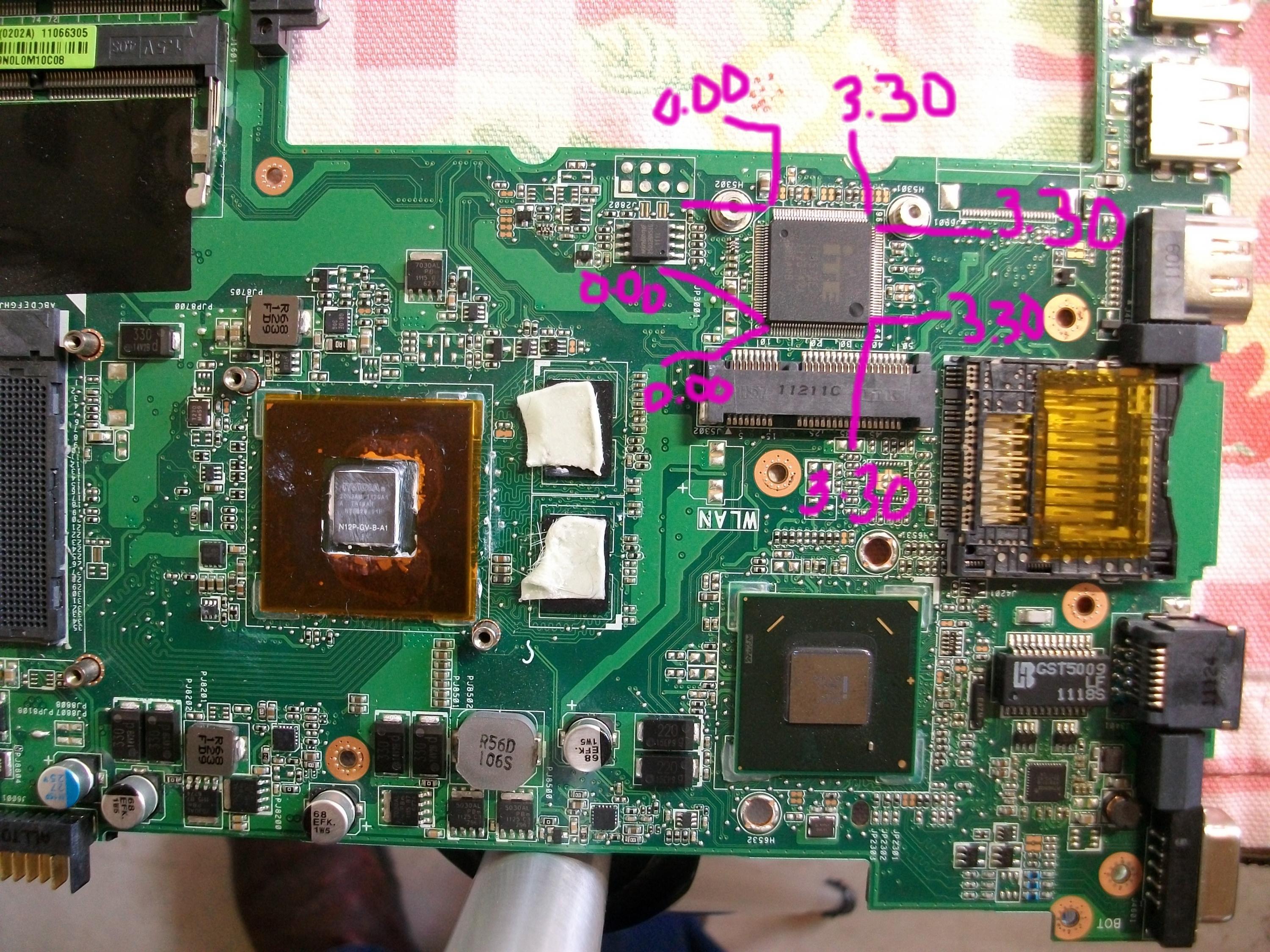

Put leads on each end of diode test when switch lead ends and test again .Comment
Re: ASUS u31sd LAPTOP WILL NOT TURN ON
your saying check the ic with ac Power on? Is this correct. if so do I need to install cpu and heat sink to test?Comment
Well you got 3.3v that's good, now check for voltage on the capacitors inside the cpu socket. You will need to power it up for this test. First set your proves then power it up, after you get the reading power it back off. You are looking for 1.8v on those capacitors.Comment
7 smaller capacitors 6 read 00.2 and 1 read 0.91Comment

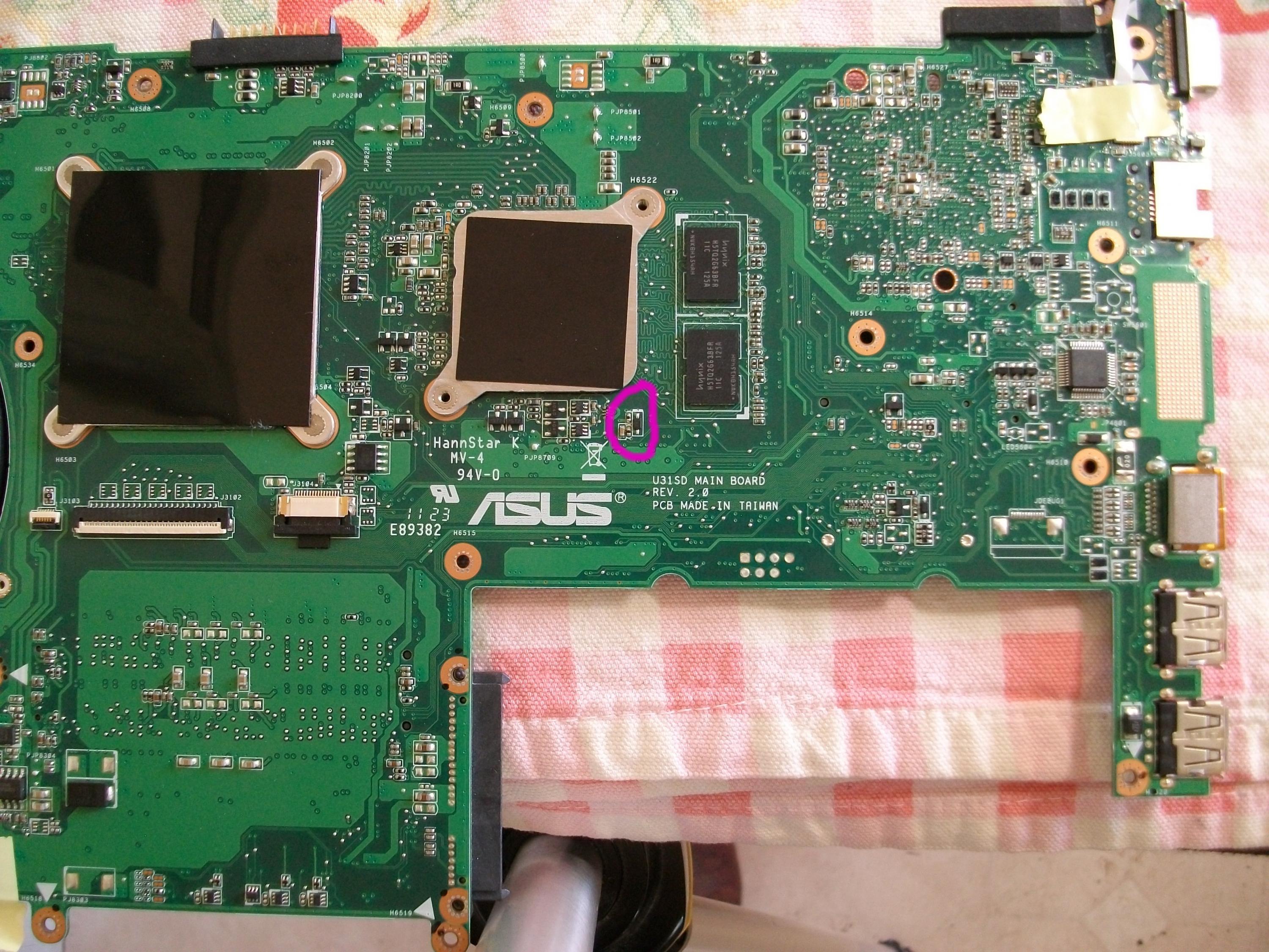

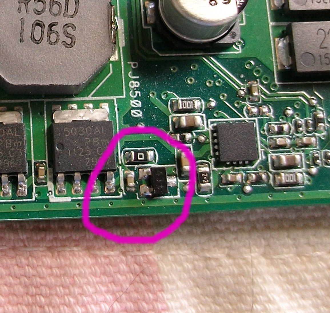

Since I have a picture up of these what are they? Diode, they have a black body with 1 leg on one side and 2 legs on the other,is circled in picture.Comment
Since I have a picture of this up what is it,see post 214. It has a black body and 1 leg on one side and 2 legs on the other.Comment
Ok Its a 1n4148 diode. It needs to be replaced here's a link
