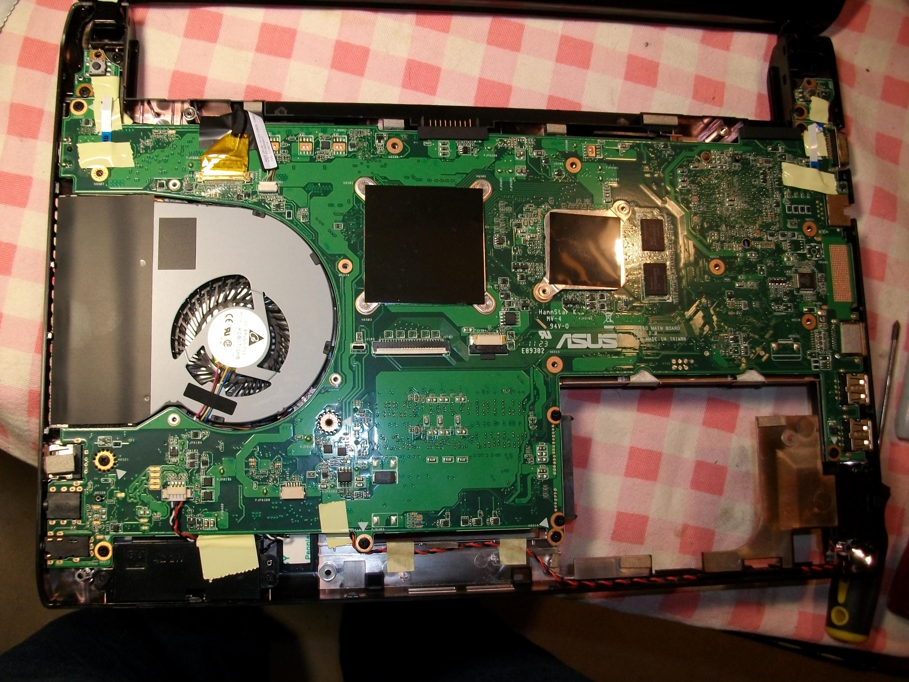

        take motherboard out and take clear pictures of both sides of motherboard and provide the part number off the motherboard so we can find schematics and look for anything obvious... and what was the phone charger voltage rating? have a hard time believing 5 volts could damage a laptop that is meant to run anywhere from 16 to 20 volts...most likely yours run at 18 to 19 volts respectively....

          Did the hold down power button,didn't work. I already started to tear down. Did not reset bios. I'm taking out the mother board. It's not going easy. As I could not fine anything on line to see how to tear down. Will post pictures when I get it out. Thanks

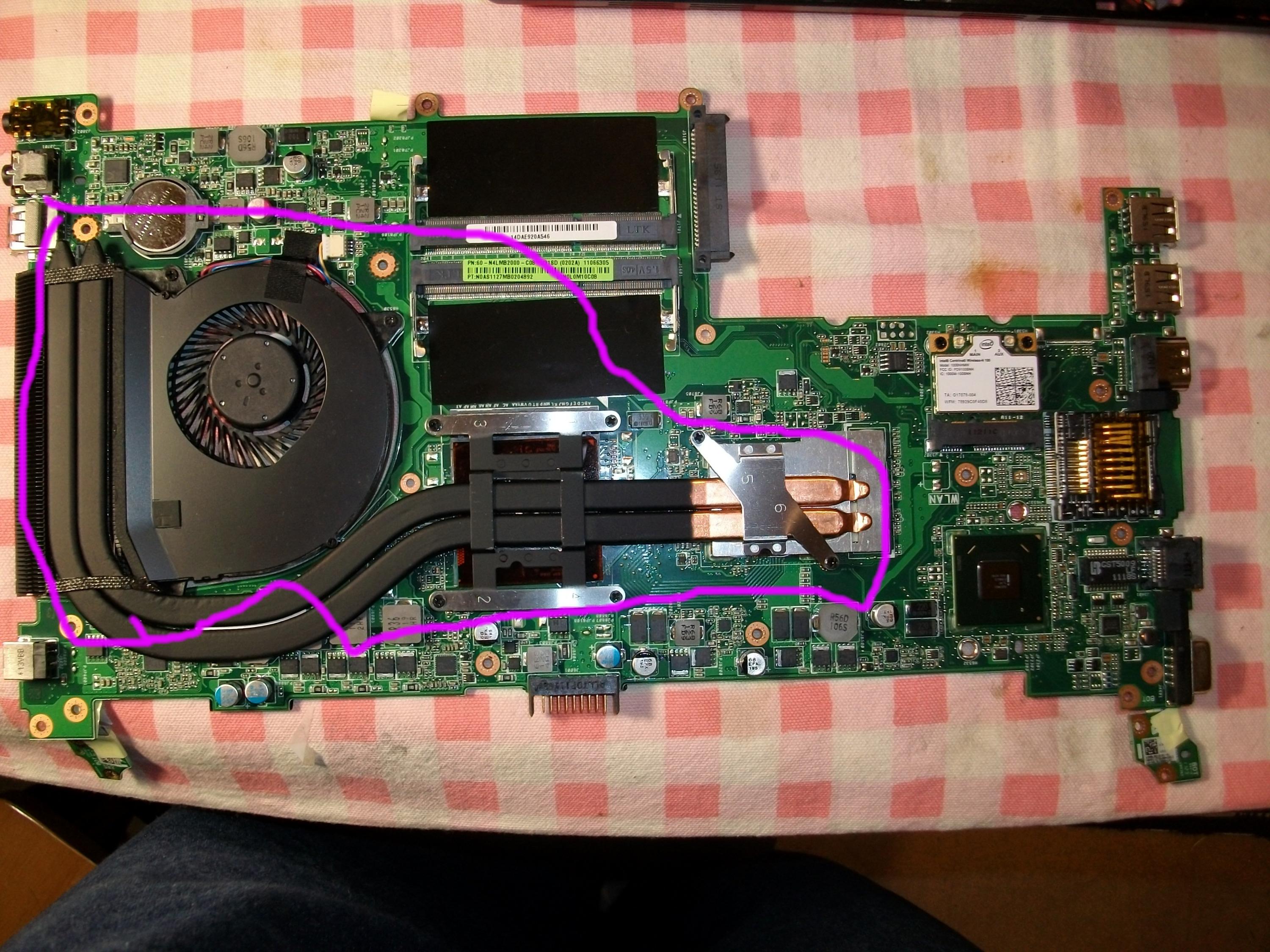

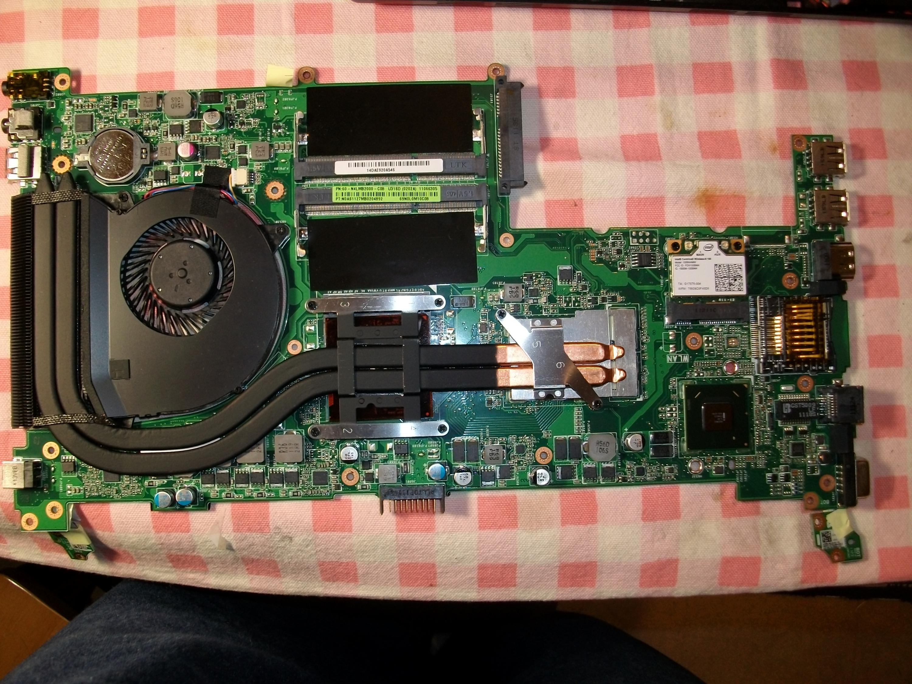

              Here's the pictures you wanted of front and back of MB. Let me know if you need more. Thanks

                Re: ASUS u31sd LAPTOP WILL NOT TURN ON
                Here's what I found for the parts number on the board.
                Asus
                u31sd
                Main Board
                Rev 2.0
                Hannstar
                MV-4
                94V-0
                  will need pictures of both sides of motherboard where dc jack power goes into the board clear and focus. please remove heat sink and carefully salvage any thermal pad you find.

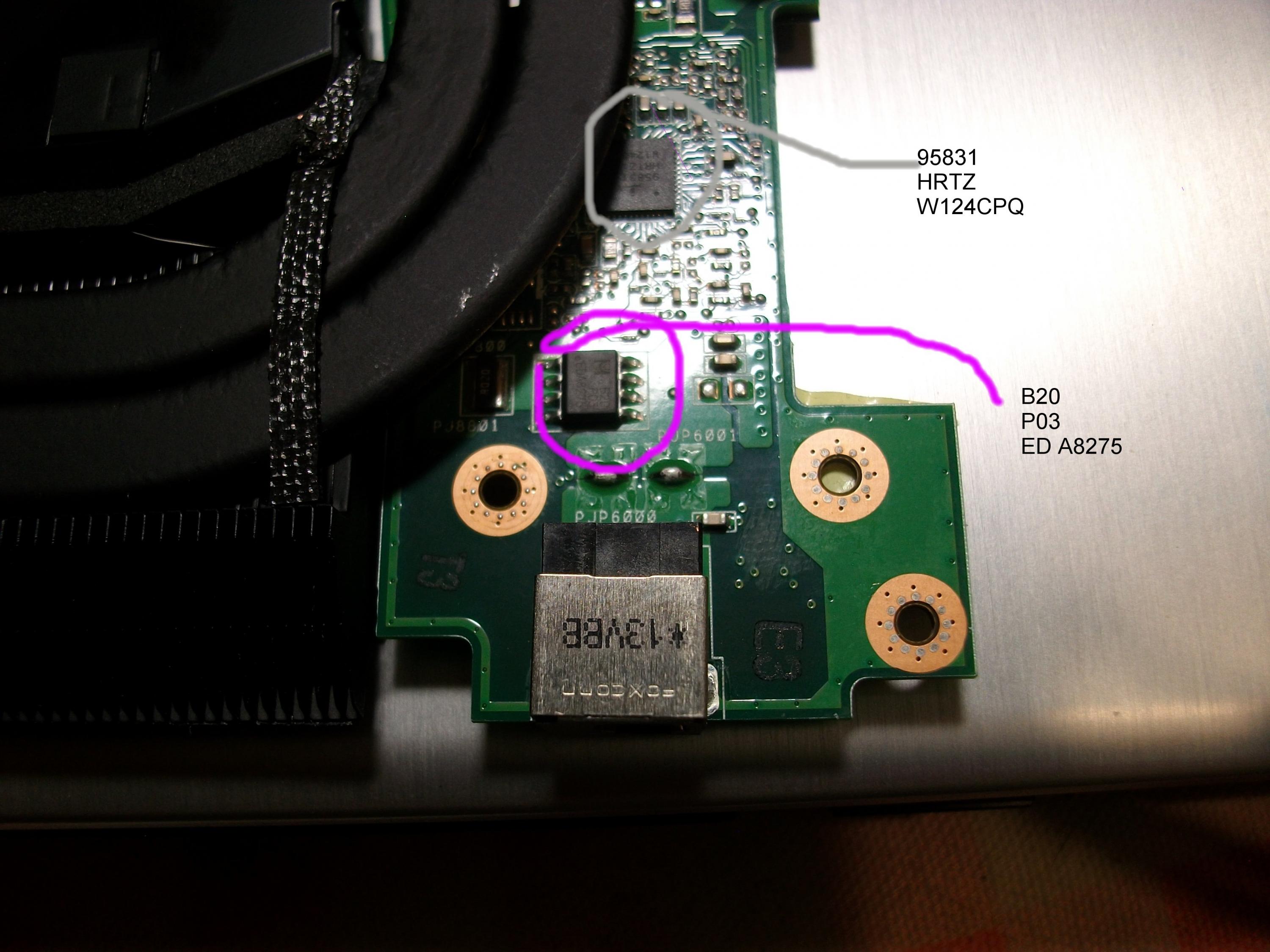

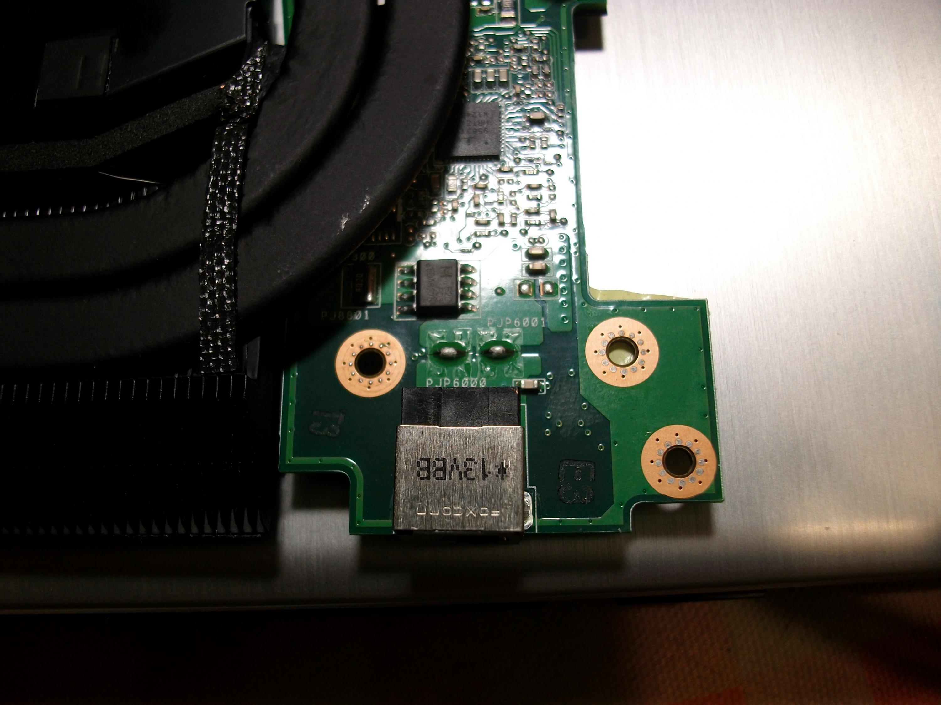

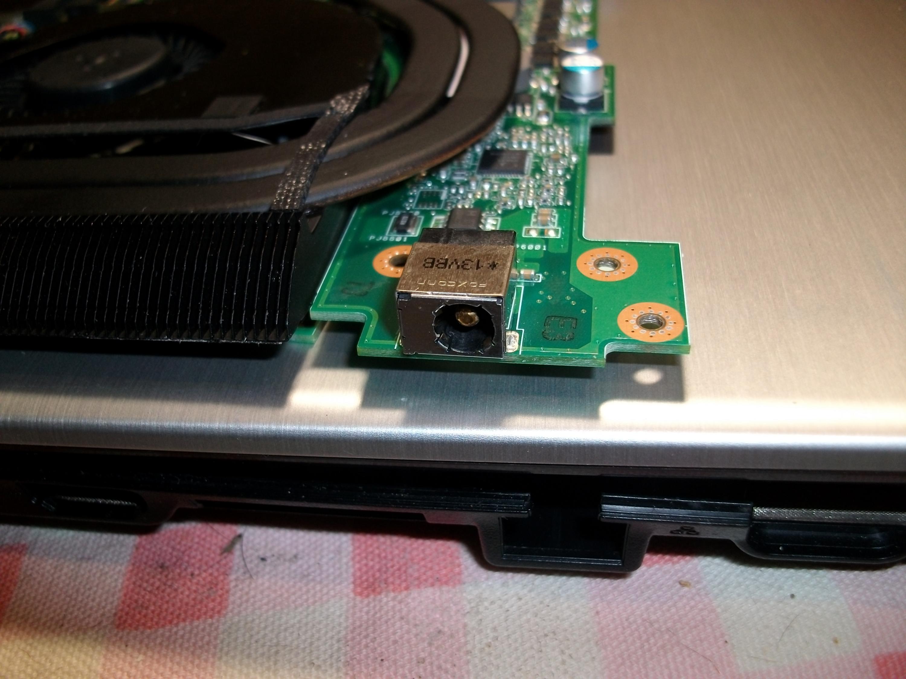

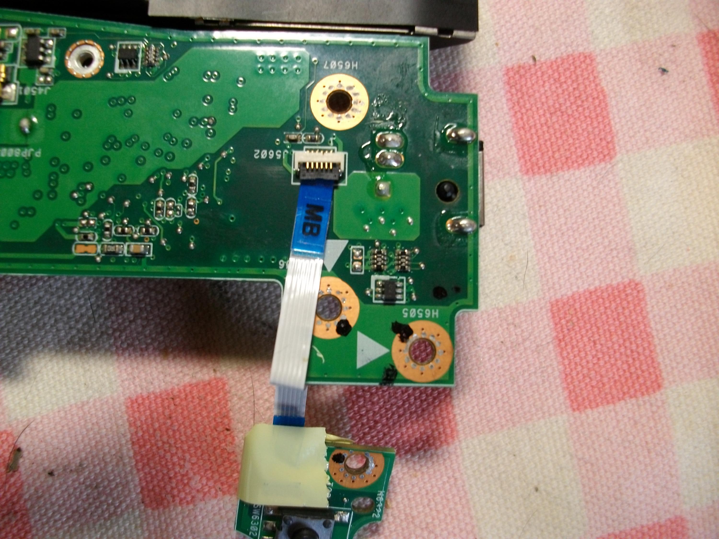

                          Here's pictures of DC jack
                          • heavymachines
                            • Mar 2011
                            • 1028

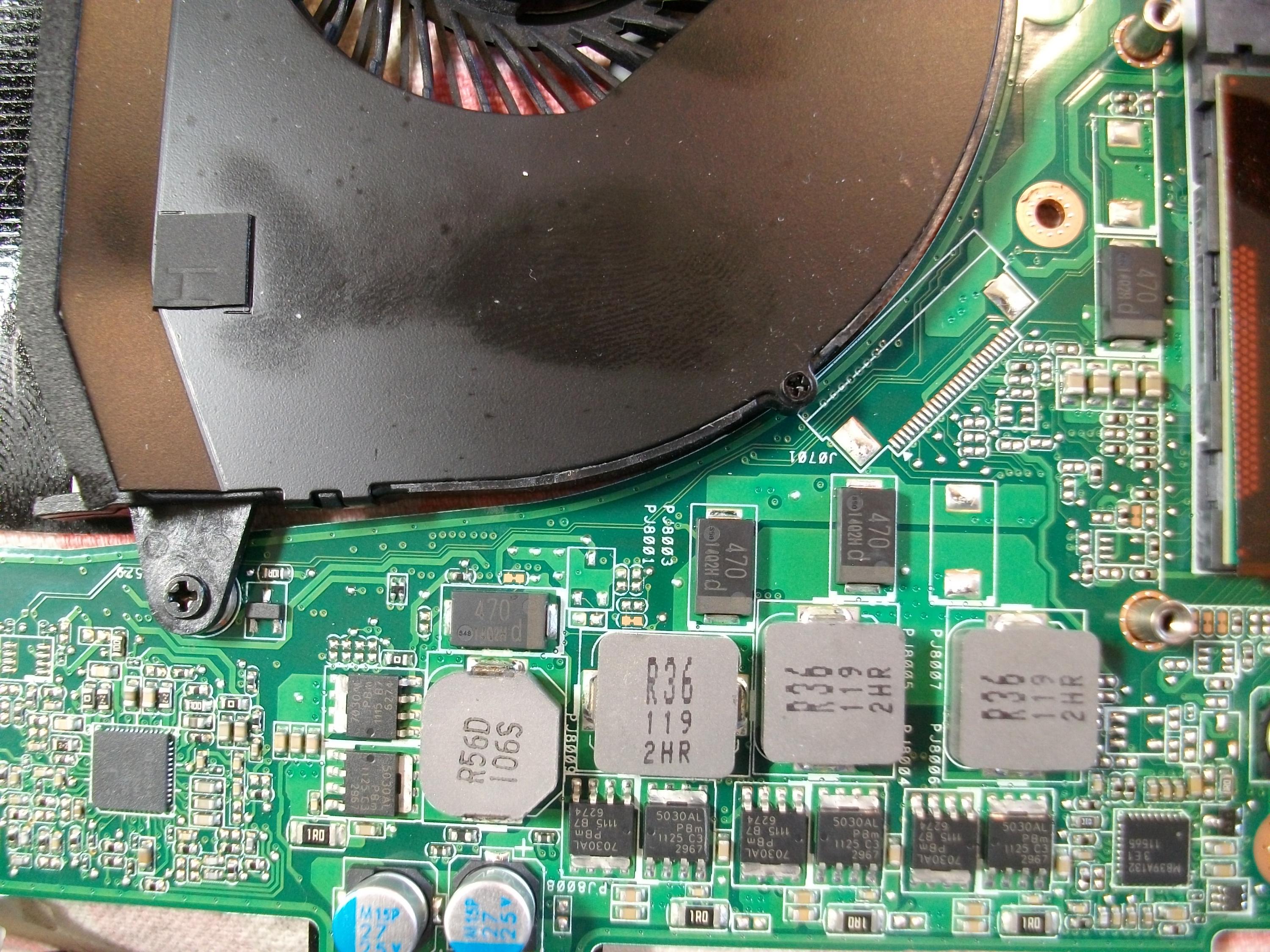

                            Please remove heat sink and take another photo of the area of the pic i edited
                            i believe there are more important ic's i cannot see due to the heat sink..
                            i will need those part numbers and if there is another 8 pin mosfet hidden under the heat sink?
                            you will need to reapply thermal compound before you put heat sink back on...but first we need to find the problem
                            do you have a digital multimeter handy?

                              edited pic's

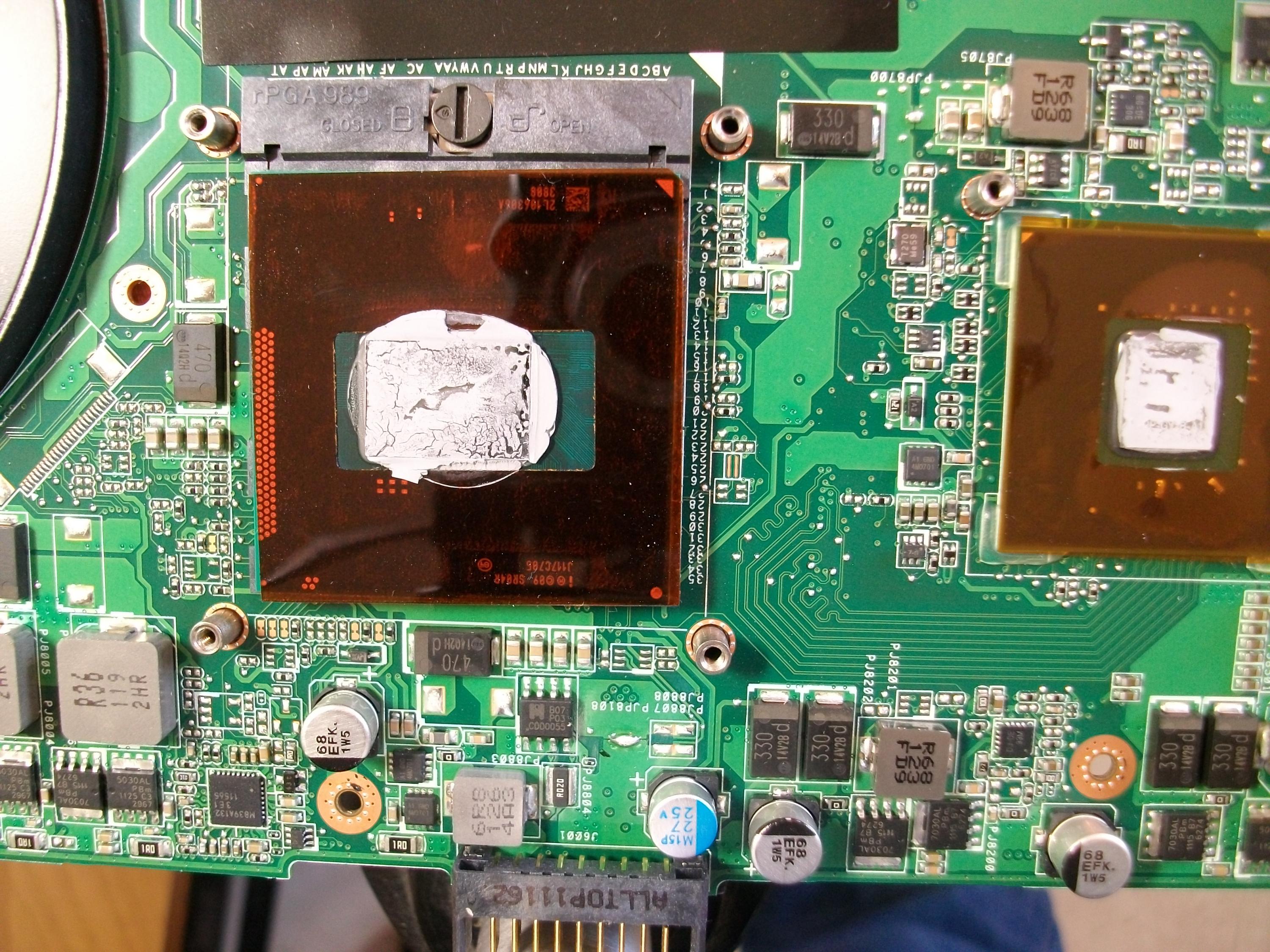

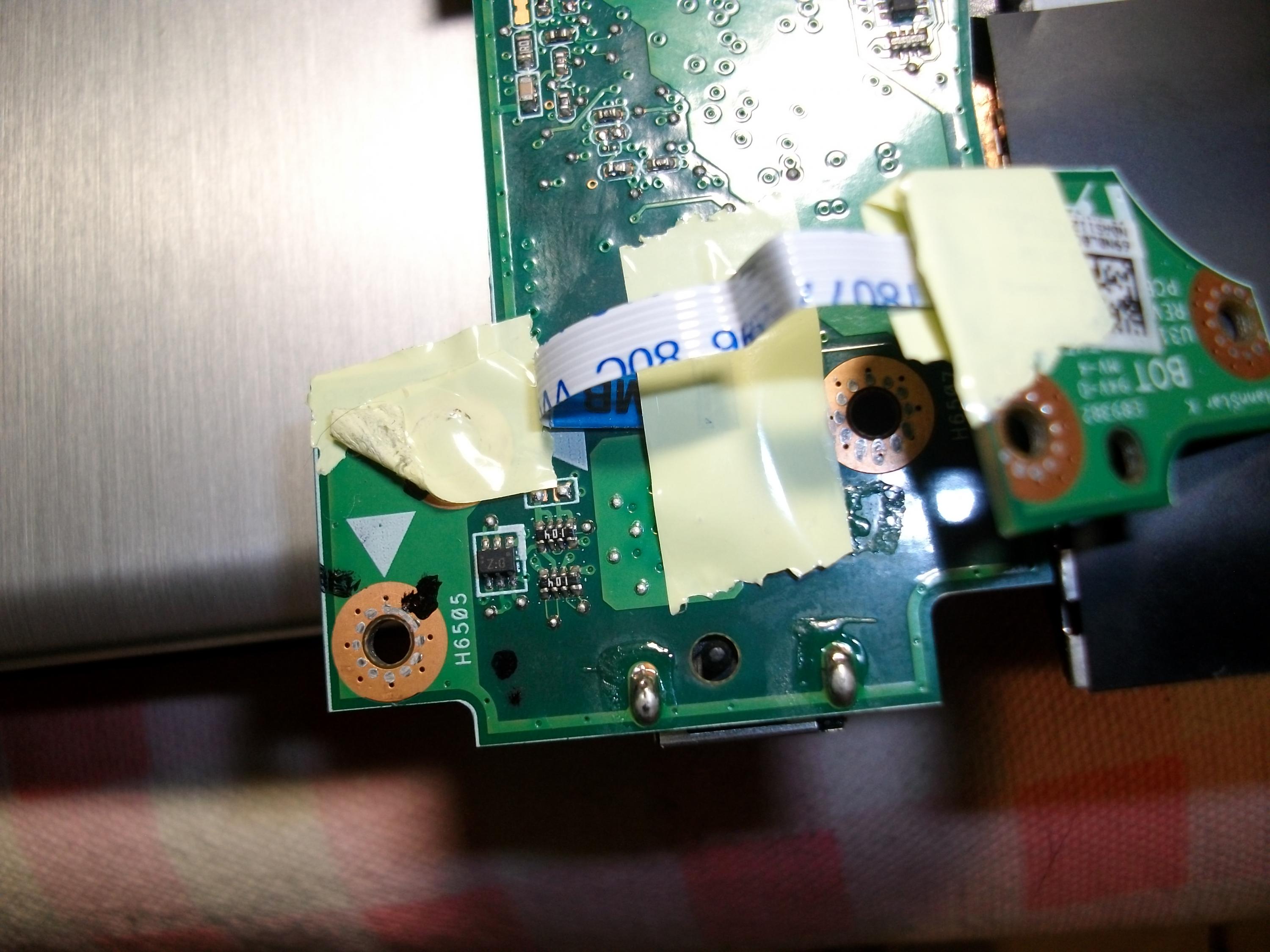

                                and on third picture please remove the tape and ribbon i cannot see the traces nor any ic if there is any.... and take another photo of the 3rd picture and straight above shots please those angle shots are worthless... and make sure the light does not blind out the board i need to be able to see thanks...

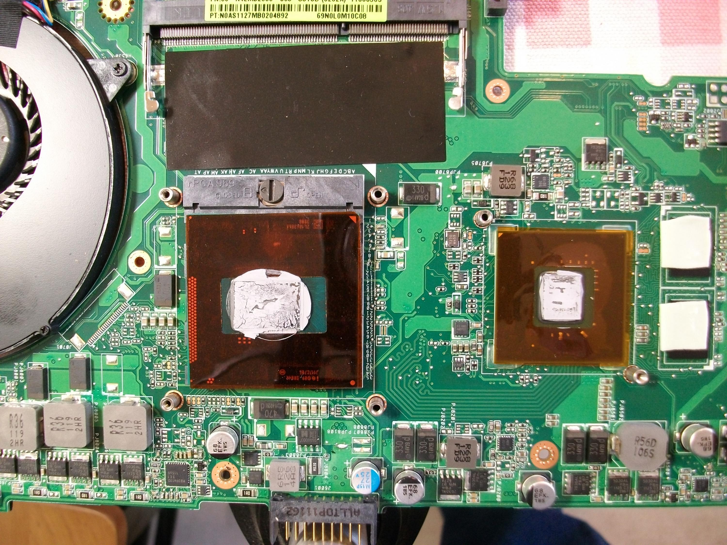

                                  When you say remove heat sink you want me to remove the whole unit I have circled in picture that includes the fan and over the CPU.
                                    Here's the pictures you wanted where the tape had to be removed. Also in the other picture is the parts numbers you wanted. I do have a multimeter
                                      Here's pictures with the heat sink removed.
