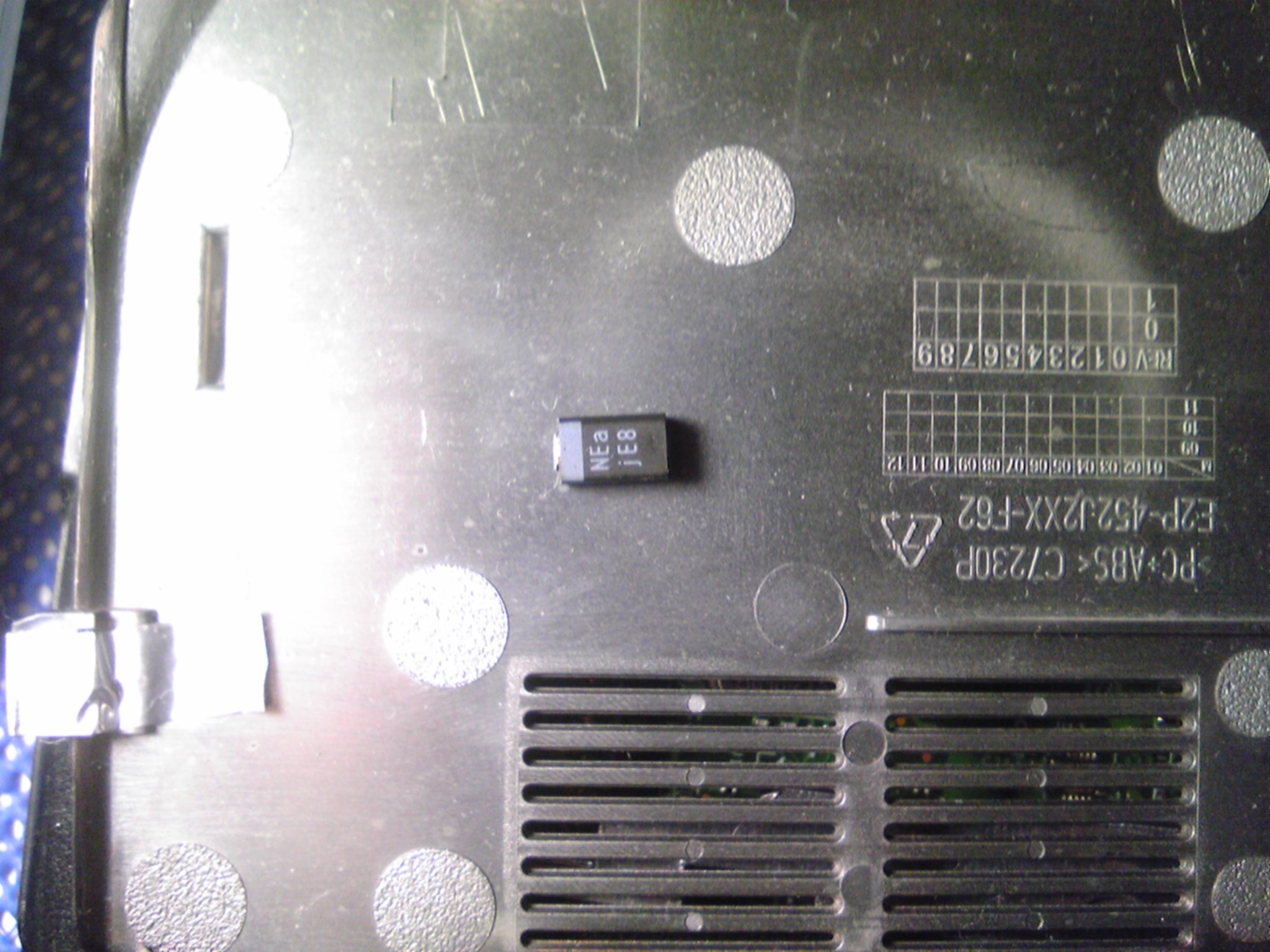

    hi to all,
    does anyone know the value of this tantalum capacitor?
    NEa
    JE8
    thanks and regards to all

        Re: capacitor value - help
        No, don't replace with a 330uF without further explanations from other members.
        Tantalum capacitors are not that high in capacity, usually they're not more than 22uF and are usually used because of low esr, so 330uF is too much capacity and depending on the voltage rating they may not be very low esr.
        To me, those codes don't tell me anything, each digit might mean something in some standard or under the manufacturer's standard. But not knowing the manufacturer, it's hard to say.
        Maybe if you post a picture of the area around this capacitor and say what hardware it is, someone can suggest some replacement.
            hi,
            thanks for the replies.
            here is the picture
              and the circuit board with the location from where you removed it? Picture with that as well please.
              Do you have a multimeter capable of measuring capacitance? If yes, try to measure it.
                        OK In this PDF PAGE 2
                        Where it says "Marking" it suggests that
                        For a case type A or B ( The one with gA8 in it)
                        If that were to say jE8 then reading the notes it would be a 6.3v 150 UF
                        What does anyone else think?

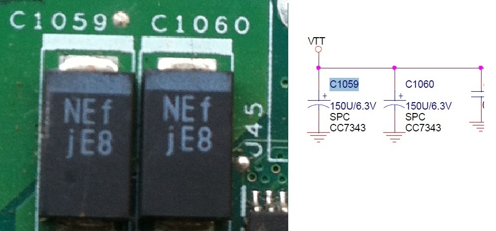

                          Sorry guys, I was a bit hasty there, the value is actually 150uF 6.3v. A faulty laptop came in some time back and i could not get same value so I replaced with 330uF (6.3v) and laptop worked fine. I've posted picture of a D600 motherboard.

                              NEC TOKIN conductive polymer tantalum capacitors
                              NE:NeoCapacitor a:Production date code
                              j:6.3V E8:150uf
                                Duncanbest beat me to it. Those are indeed neocapacitors... basically some weird hybrid tantalum polymer super low ESR caps... as best I can remember the ESR is so low that you would have to use Kelvin leads to measure their ESR properly
