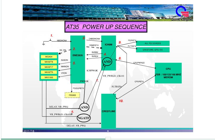

    Can some one please help me get the schematic diagram for DAAX3MB16A1 REV:A and DA0AX2MB6E1 REV:E. they are all used in most hp notebooks and they all seems to have the same power issues.

    Here's a schematic for hp intel g62 laptops. Let me know what you find in the motherboard.

                                    do you have +3/5 v ? if you have first reprogramme the bios. still no change EC. Also check for EC and South xtals.

                                      with power on sequence you can really know the faulty chip.
