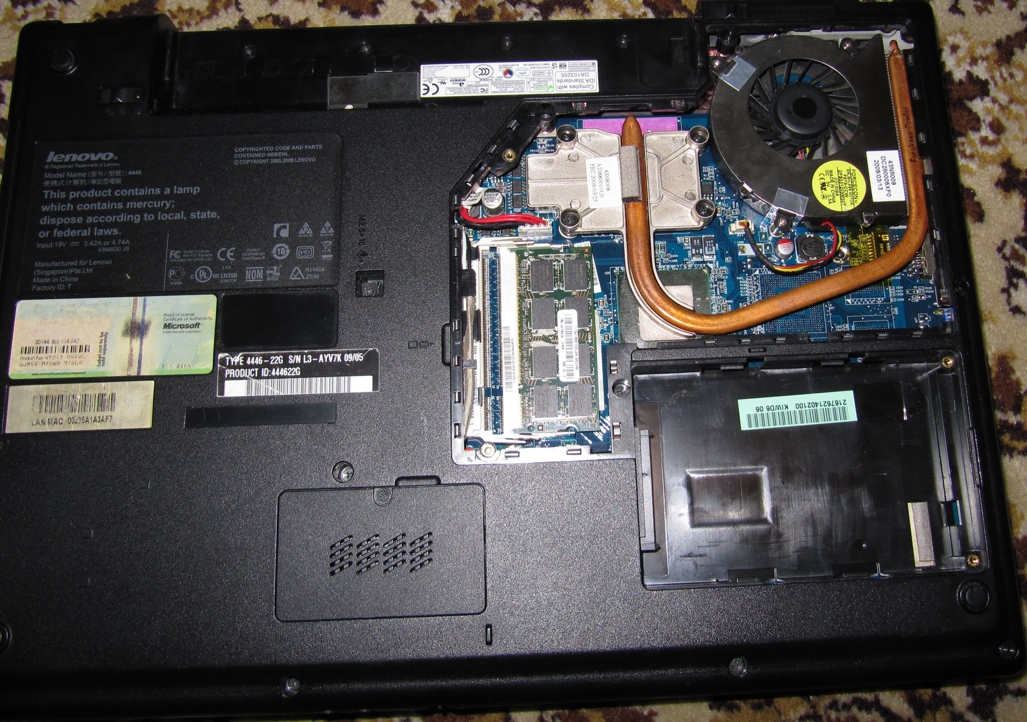

    The title says it all, I received it as dead because the owner let it sit on beds and sofas for hours, blocking entirely the ventilation.
    When I pressed the power button it posted but hanged when trying to find boot devices. There was an endless loop of the ethernet boot interface.
    I opened it and saw a really pathetic heatsink that is just a heat pipe....
    The vga is Intel GMA embedded on motherboard.
    I don't know why, but it doesn't boot any more.. I press the power button and the only response I get is that the power led turns on. No fan movement, no image on monitor.
    What do you think is damaged?

    Northbridge most likely.

          I had the same laptop model . When I opened it I found dust carpet that covered heatsink. It has a problem whit GPU , actually graphics looks like was generated in 8bit mode. When I pressed chipset sometimes it was working normally , sometimes it did not boot. So it can be the same issue.
          I did not repaired it because customer said it will be too expensive and he got three more the same laptops so this one will be as a donor.
