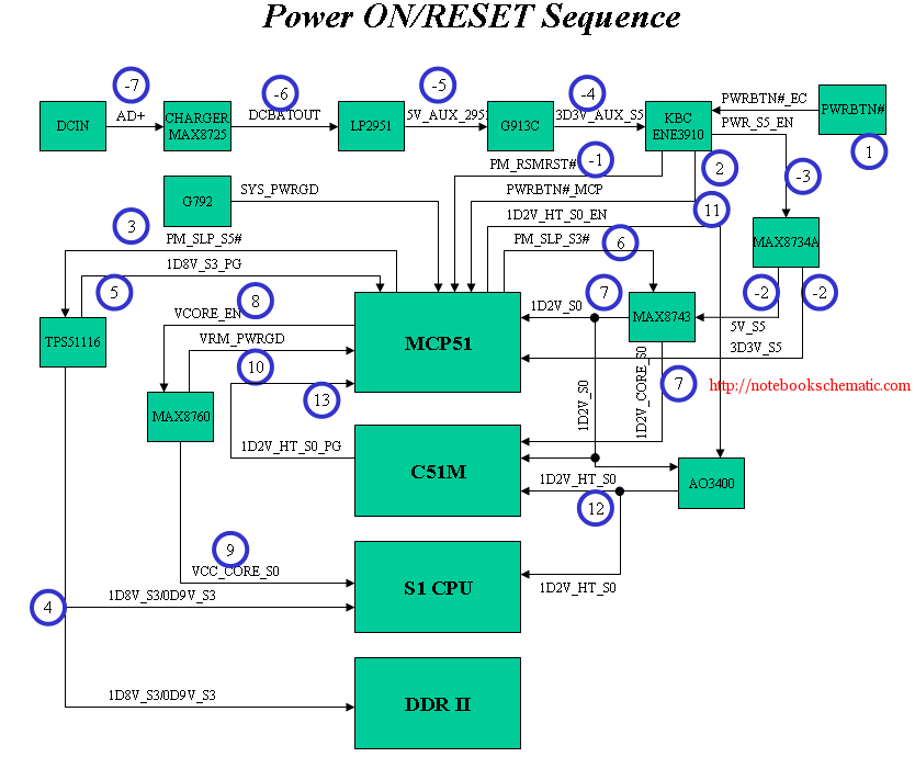

    please someone can publish the power up sequence of hp laptop .
    you can see an example with the attachment .

    Re: power on sequence
    looks familiar with acer 5520 but we are gonna need model number for good help
      cq61 g60
        That's a dell power sequence shown
