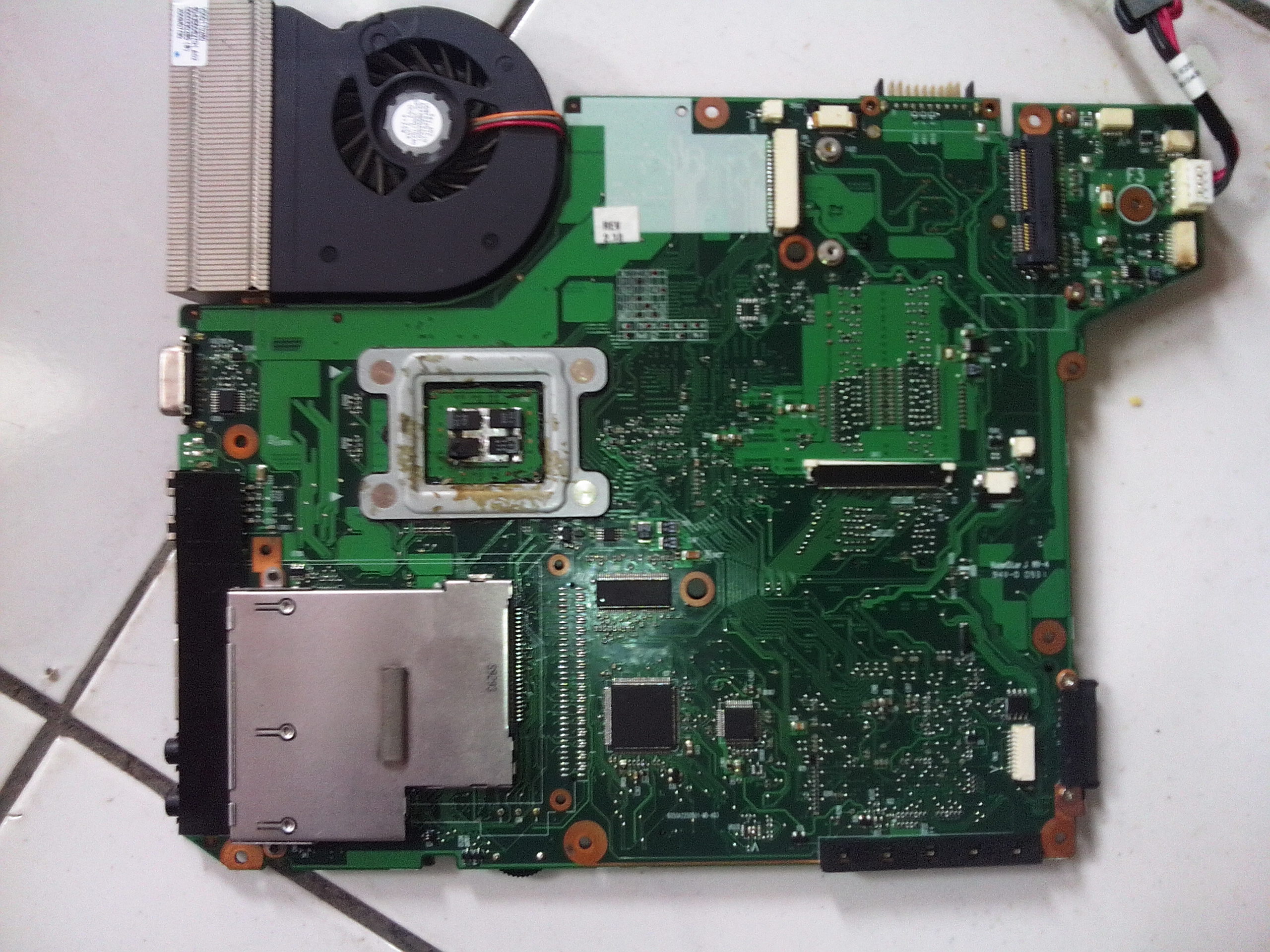

    I have my L510 have problemm,
    1. its only can on by battery plug in ( can only on by battery ) its can't power on by dc power adapter,,
    2. its power on would last only 5 minute then its power off its self
    need help here ,, i'm very appreciate for any idea could be its bios or hardware trouble..

          i have resolved this kind of issue one day . but for me it was ISL6251 (charging circuit)
          . can you share a view of your board here , it will be very easy four us to give you some guidelines about this trouble .

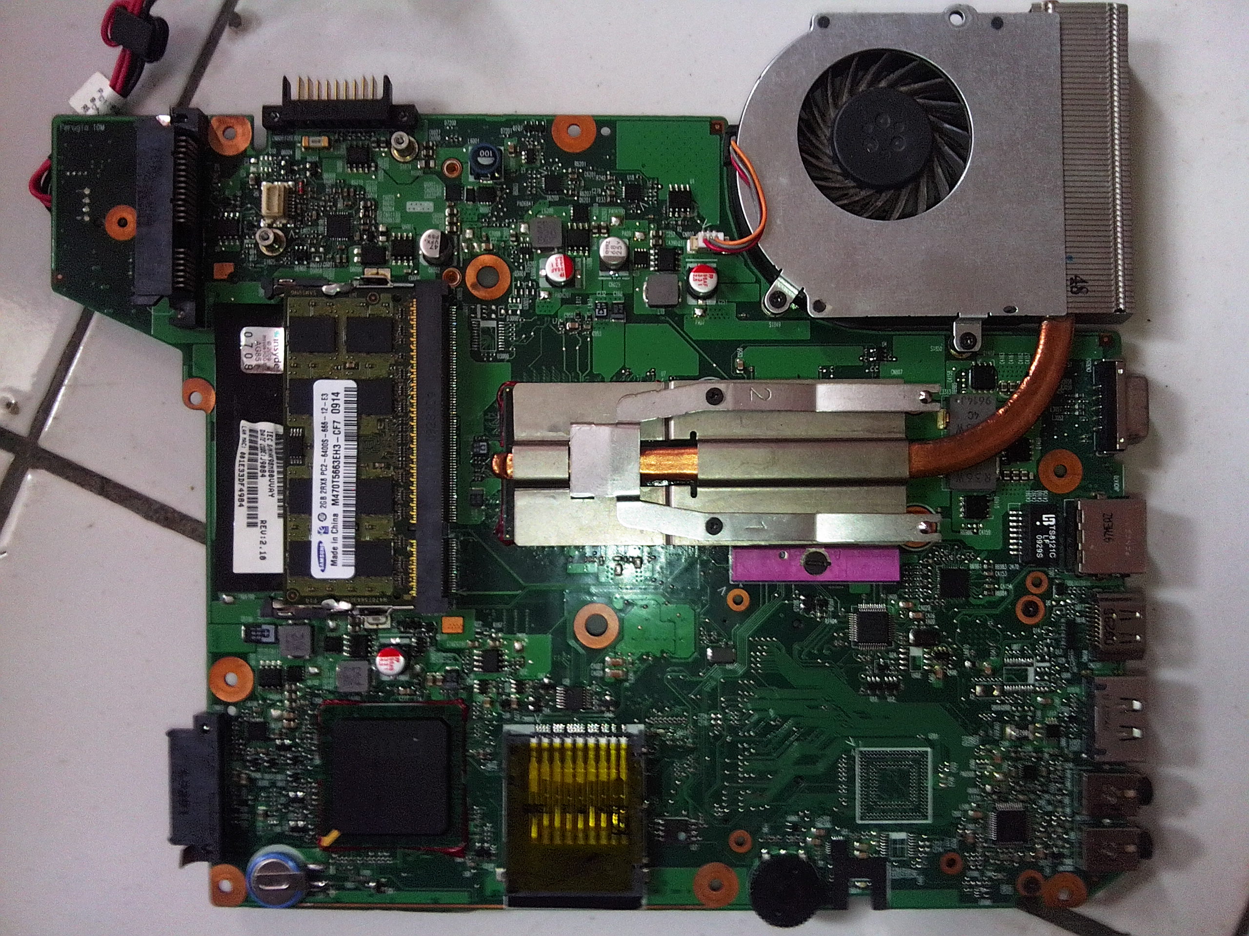

                mainboard picture hannstar
                • bsant79
                  • Oct 2012
                  • 17
                  • indonesia
                  Re: Toshiba L510 power problem
                  maybe it was ISL6251 ( i'll try it,, thank ,, i will inform later the result )
                  picture uploaded,,

                    i had same problem
                    problem is with nec/tokin which is located under cpu (other side).
                    i changed it and laptop works fine for month or two and same problem again.
                    this time i changed it with 4 capacitors and it works more than 6 months.
                                thank u all ,,, i found the cause of the trouble " IT WAS MIC OUT PUT SORTING / before socket mic on mainboard there is cap that not good " its solvedddd
                                one again thank u alll
