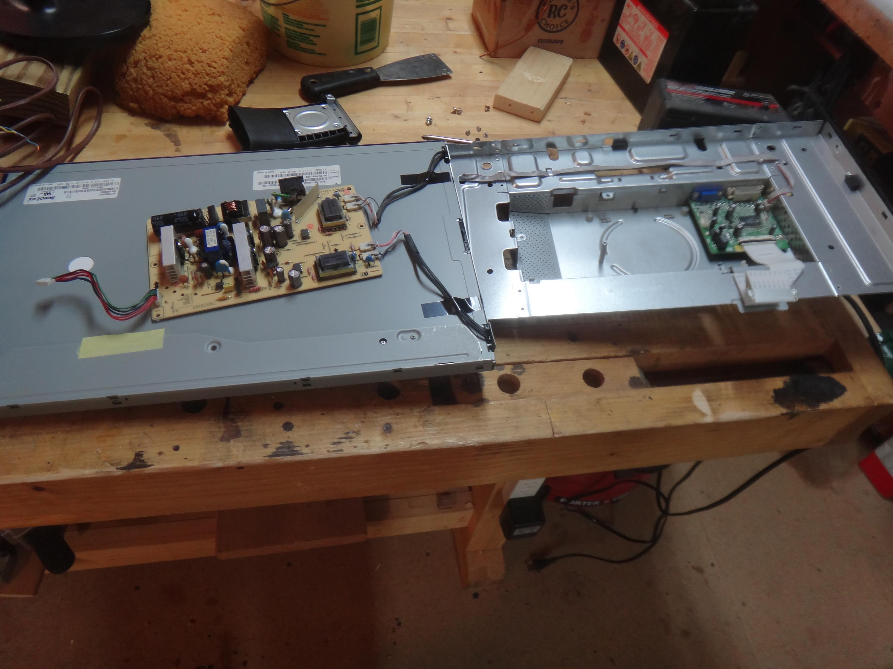

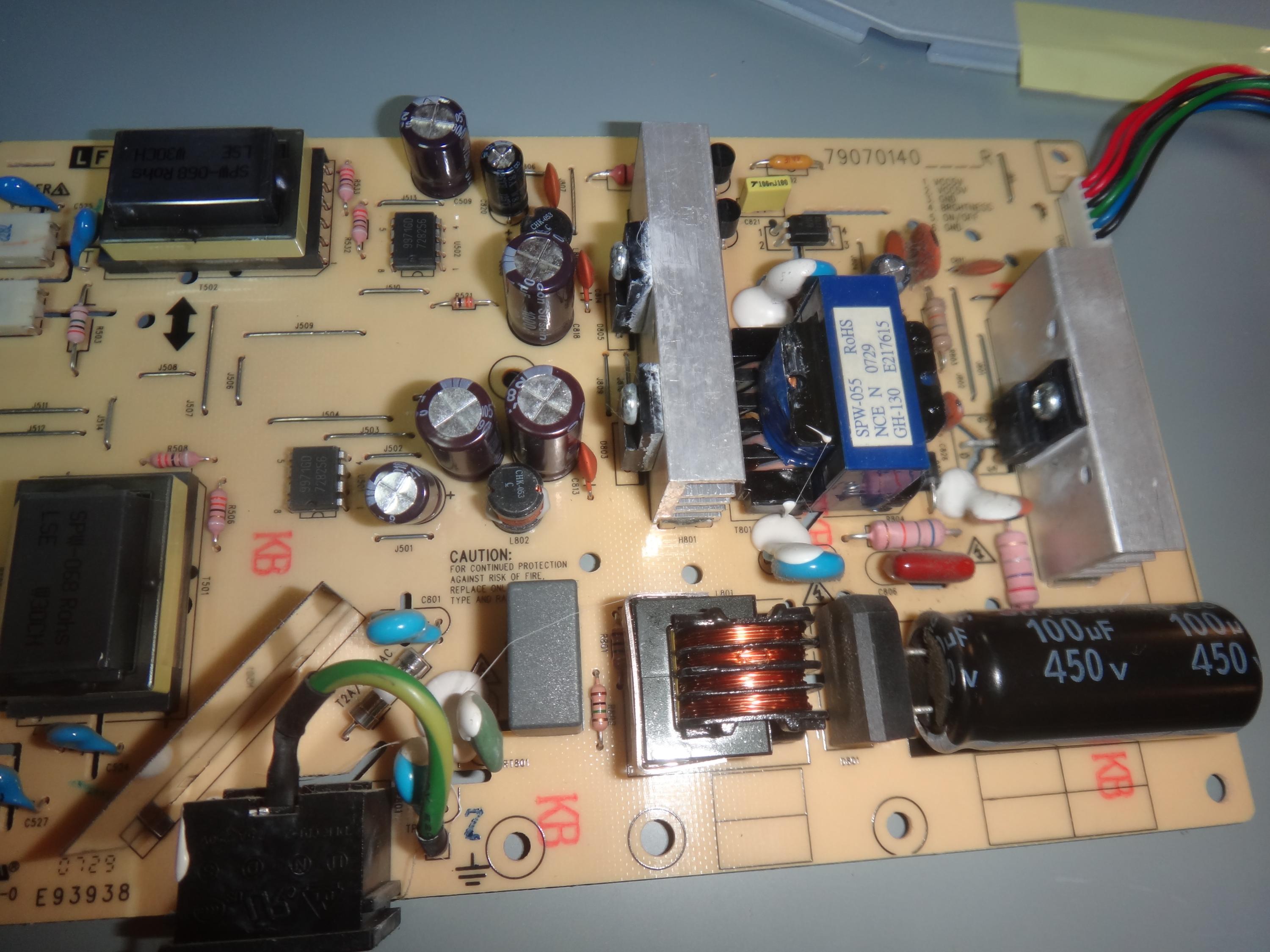

      Greetings everyone,
      I have a HANNSG Hi221 monitor that exhibits two seconds to black issues (backlight goes off, display is still on as confirmed by shining a flashlight on it) with some additional oddities...
      The monitor failed on me with a standard "2 seconds to black" some time ago prompting me to initially replace most of the electrolytic capacitors (some of them were bulging/leaking).
      Things kinda sorta worked for a night, then the problem returned along with some flickering and "buzzing" noises.
      Upon closer inspection...
