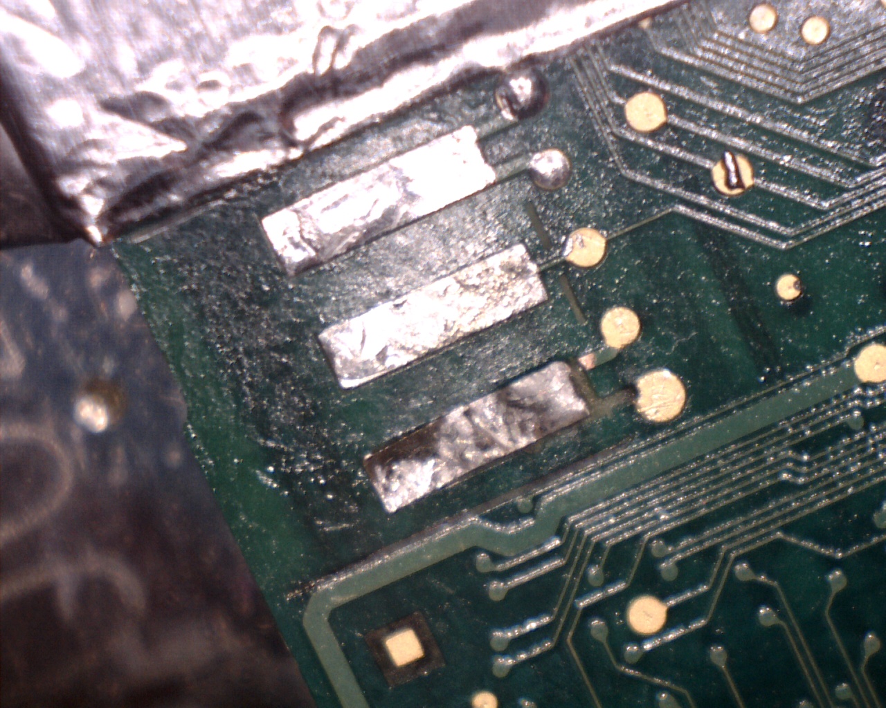

    So, I'm replacing the battery on a 3rd gen iPod Touch, which is pretty routine to me, however I have come across an issue. when I was desoldering the connections I pulled off one of the leads on the board. Does anyone have any clue how I can repair this? it's the 3v lead on the board to the battery. I still have the lead... Any suggestions?

    Here is an image of my mess!
          U should be able to solder it to the pad still may work if not solder it to the gold round contacts above the pad

            Re: iPod Touch Motherboard
            That's what I wound up doing.. I was able to get it working, thank you.
