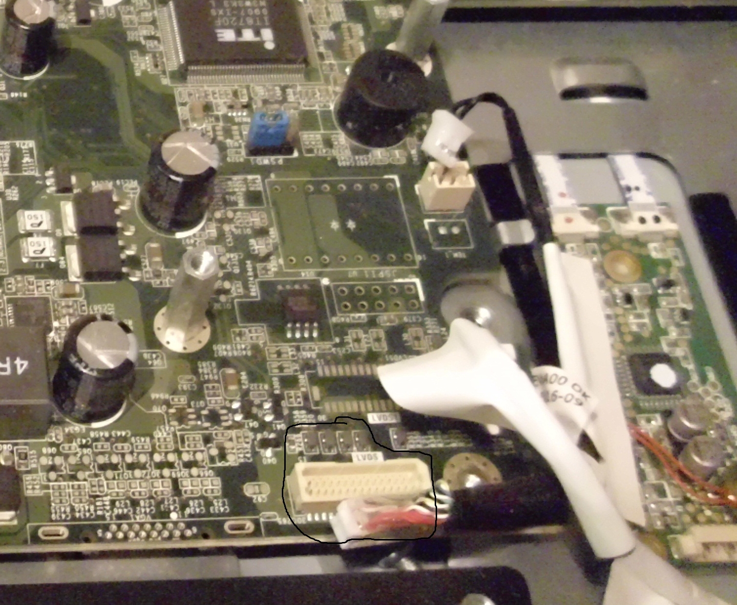

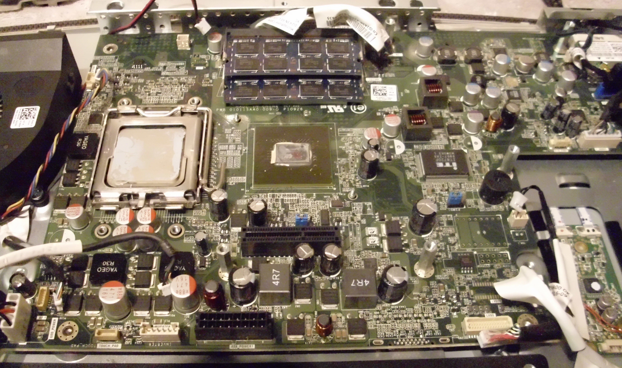

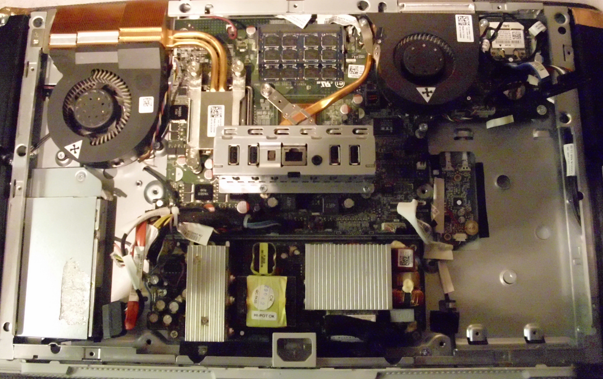

    An update,
    After disassembly and looking for a fuse on the attached t con, I can't tell for sure it's either a jumper or a fuse but it is good.
    I have an Acer 18.5 LCD just sitting around so I installed the touch screen panel from the Dell into the Acer and I get a good picture so the panel is good, and I have either a mother board or flat flex cable issue.
    White screen usually means a power to the panel issue; I guess I need to find a schematic to see what's missing.
    The third picture shows where the LVDS cable plugs in.
    If any body has any ideas please let me know.

      Re: White screen Dell studio one 1909
      Originally posted by alexanna
      An update,
      I installed the touch screen panel from the Dell into the Acer and I get a good picture so the panel is good,.
      Hi - did you (a) leave the dell cable on the dell screen to attach it to the Acer?
      if so the board end of the dell cable must be compatible with the acer?
      or (b)did you use the acer cable to attach the dell screen to the acer
      if so the screen end of the acer cable must be compatible with the dell?
      If (a) can you try the acer screen and acer cable in the dell or
      if (b) try the acer screen with the dell cable in the dell
      Blue = Me Thinking!! I've read it several times and I think thats what I mean
      Or daft as it may seem have you tried this:http://www.youtube.com/watch?v=FfbmQRuqDD0 - you can skip the first 3 minutes
      I cant really tell from the pic but assume all pins present and correct in the dell board socket
        A white screen, if not related to the screen hardware, could be a BGA issue. I've seen this happen, the screen can be white or black.
        If so, it needs to be reballed or reflowed.
