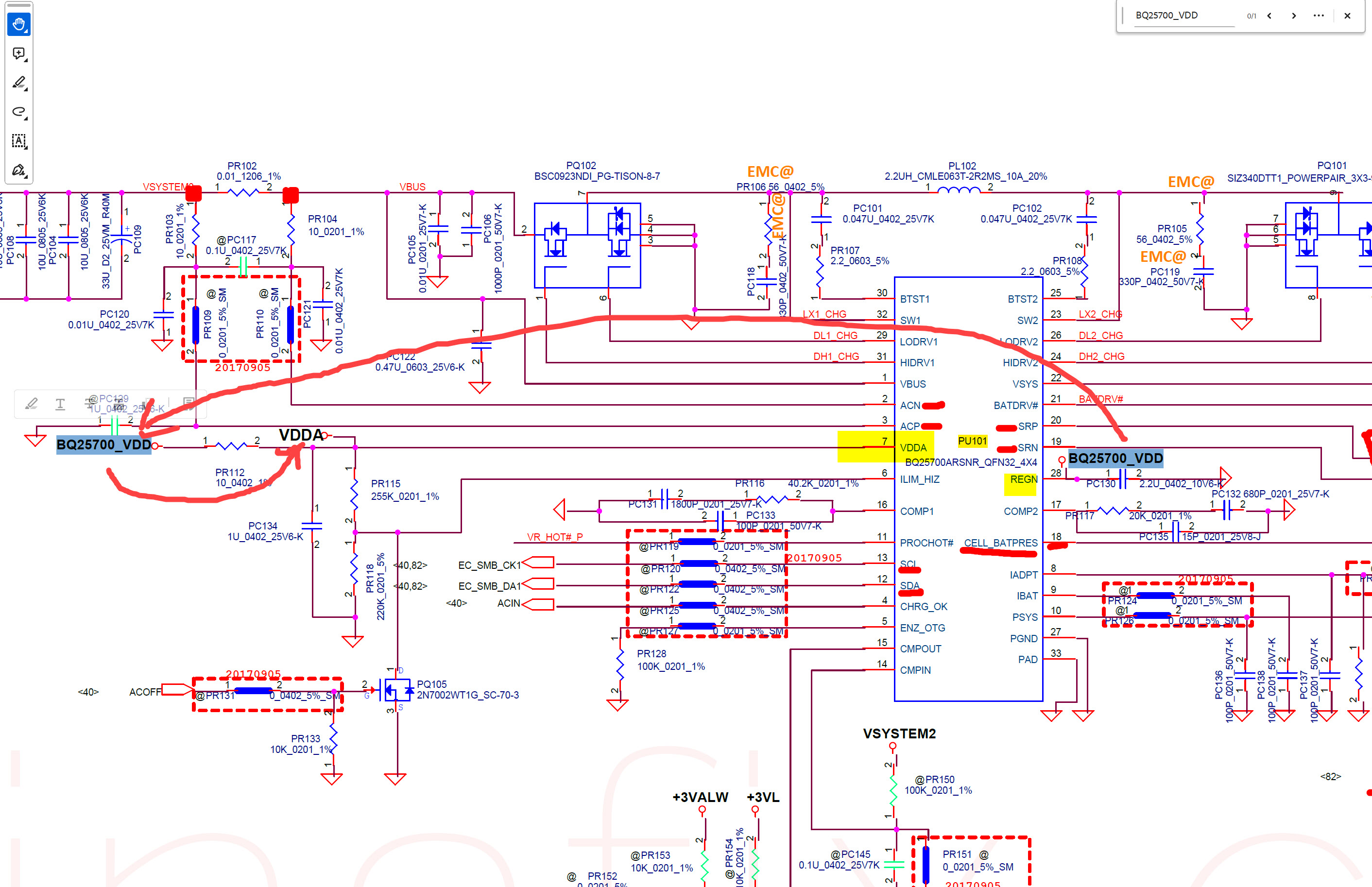

    Hello i have this circuit and my battery not charge.
    I was changed PU101, PQ103,PQ101,PQ102, the battery and the problem is the same.
    When the bactery is conected:
    PQ103:
    pin1: 19v
    pin4: 19v
    pin5: 11v
    when the bactery is not conected:
    PQ103:
    pin1: 19v
    pin4: 8v
    pin5: 19v
    Why works the opposite? EC Problem and need programing?

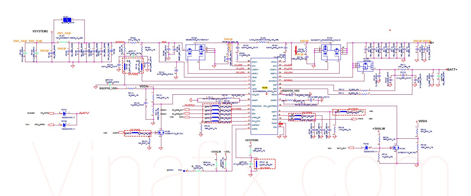

          This is the schematic.
          BQ25700
          PIN18 -- Cell Batpres have 0.09V
          PIN 7 -- VDDA have 0.14V
          There is anything wrong...
          ALL BQ25700 Voltages with battery conected: >>lenovo e580
          1- 20v
          2- 20v
          3- 20v
          4- 3,27v
          5- 0,14v
          6- 0,28v
          7- 0,14v
          8- 0,06v
          9- 0,09v
          10- 0v
          11- 1,82v
          12- 3v
          13- 3v
          14- 0v
          15- 1,14v
          16- 0,08v
          17- 0,13v
          18- 0,09v
          19- 10v
          20- 10v
          21- 19v
          22- 19v
          23- 20v
          24- 19v
          25- 19v
          26- 0v
          27- 0v
          28- 6,8v
          29- 0v
          30- 20v
          31-20v
          33-20v
          VDDA , ILIM_HIZ, CELL BATPRES WITH 0V ITS NOT NORMAL...

          • mon2
            • Dec 2019
            • 13994
            Re: Battery not Charge
            Investigate the resistance across PR112. Remove all power. Meter in lowest resistance mode.
            Check the resistance across PR112 which should be ~10 ohms. This resistor is mated with REGN and you have posted REGN (pin #28) = 6 volts. VDDA is the other side of PR112 so VDDA should be ~6 volts. If it is not, PR112 is defective.
                PR112 is gone..not have This resistor in motherboard...maybe when i used hot hair was remove This resistor..
                  Post a clear picture of this missing part. It is required to be onboard but a solder short will also work in its place. Want to review the pcb pads where this part was located.
                  Remove all power. Meter in resistance mode. Measure the resistance across the 2 pcb pads for this resistor. What is the resistance?
